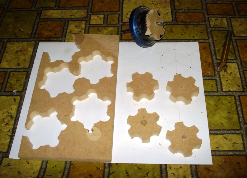

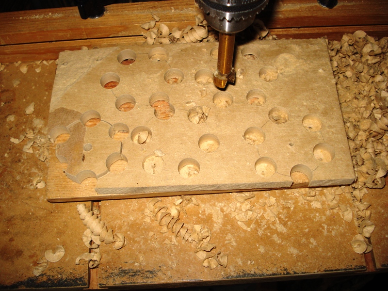

They are made with leftover MDF 1/2"; measure 2" in diameter and have six points:
Cutting valleys with 5/8" Forstner bit.
Attachment 4269
Cutting the knobs with crown bit 2"; on paper you can see a pattern with radius every 60 degrees.

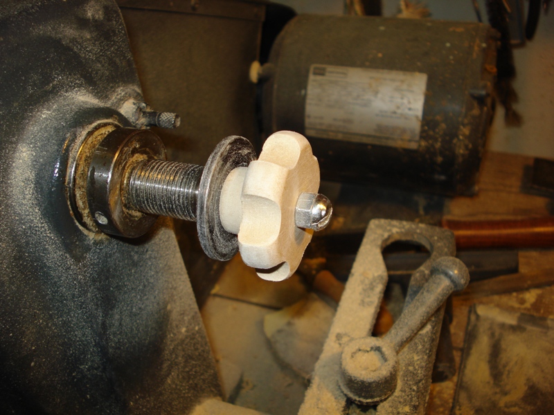

Rounding out the ridges at the lathe. It could also be done at the drill press.
Attachment 4271

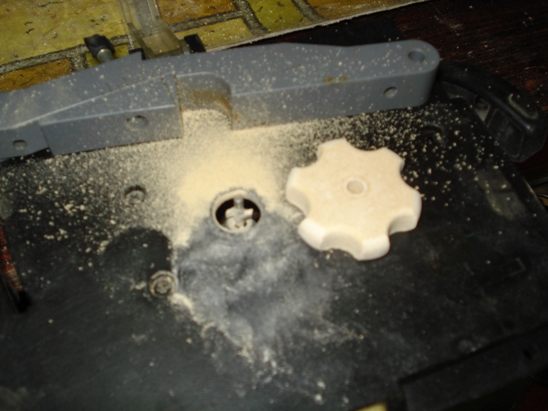

Rounding out the valleys with Dremel mounted in router-table accessory.
Attachment 4272

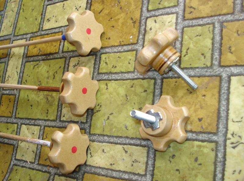

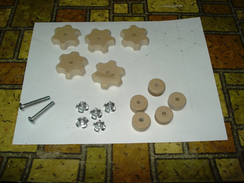

Elements ready for assembly. The small discs were cut with crown bit 1" in diameter.
Attachment 4273
For female knobs, the "T" nut is embedded in the small disk on the side to be glued to the star-shaped disk; for male knobs, "T" nut will overlaid on the free side of the small disk, the screw is tightened before gluing the elements, and the screw head fits in a recess created in the star-shaped disc. I used two components epoxy glue.

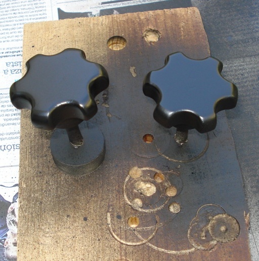

Finishing; with application of sealant,
Attachment 4274
and black enamel.
Attachment 4275

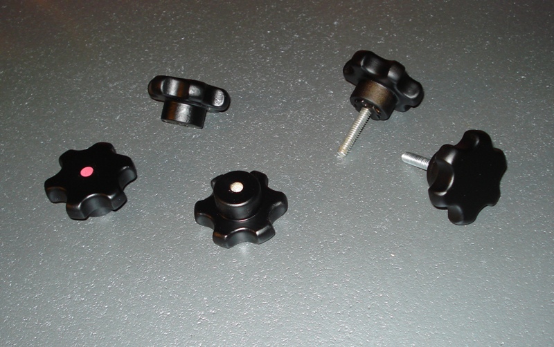

This is the final result.
Attachment 4276
