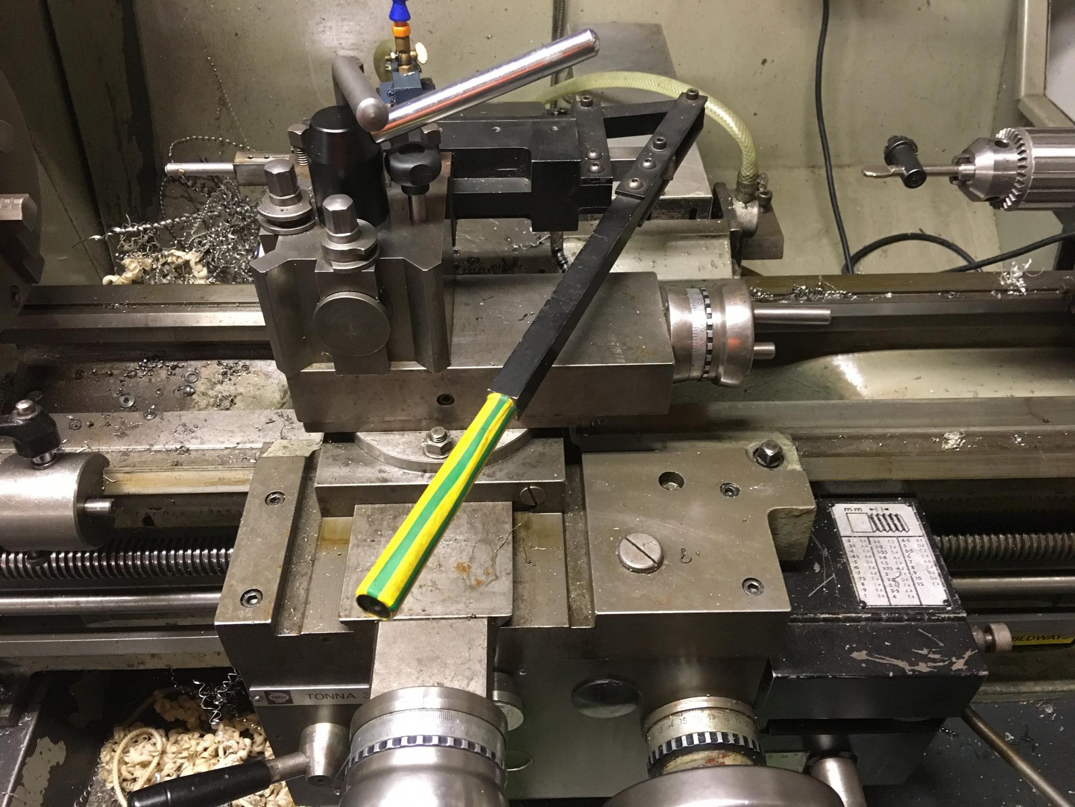

I made this simple manual slotting/broaching attachment for my lathe. I do have a set of imperial keyway broaches but the set only has 5 sizes. As broaches are so expensive and this is afterall only a hobby I can't justify buying every size I need. The cost and the amount of times I would use each broach and often to only cut one keyway. I decided to make this tool so I could cut anysize by grinding a piece of high speed steel to the desired size.
The tool has a 3" stroke and the material costs were half the price of one good quality broach. I kept the build construction very simply by using a solid square stock bar as a ram with a simple lever operated movement to drive the tool in and out.
The other advantage of this tool is blind holes can also have keyways cut, I normally drill a cross hole or undercut the bottom of the hole to prevent a build up of swarf at the end of the stroke.

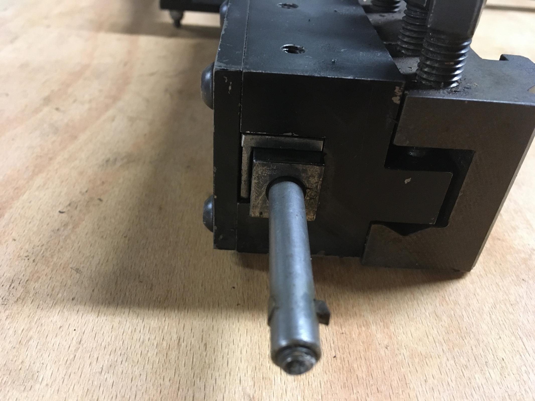

Attachment 32854
Manual slotting tool

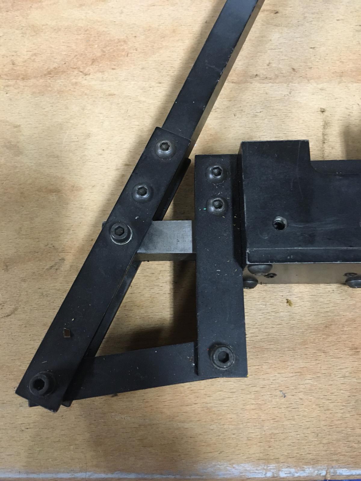

Attachment 32855 Attachment 32856
Lever mechanism.
Attachment 32857
Made to fit standard lathe tool holder.

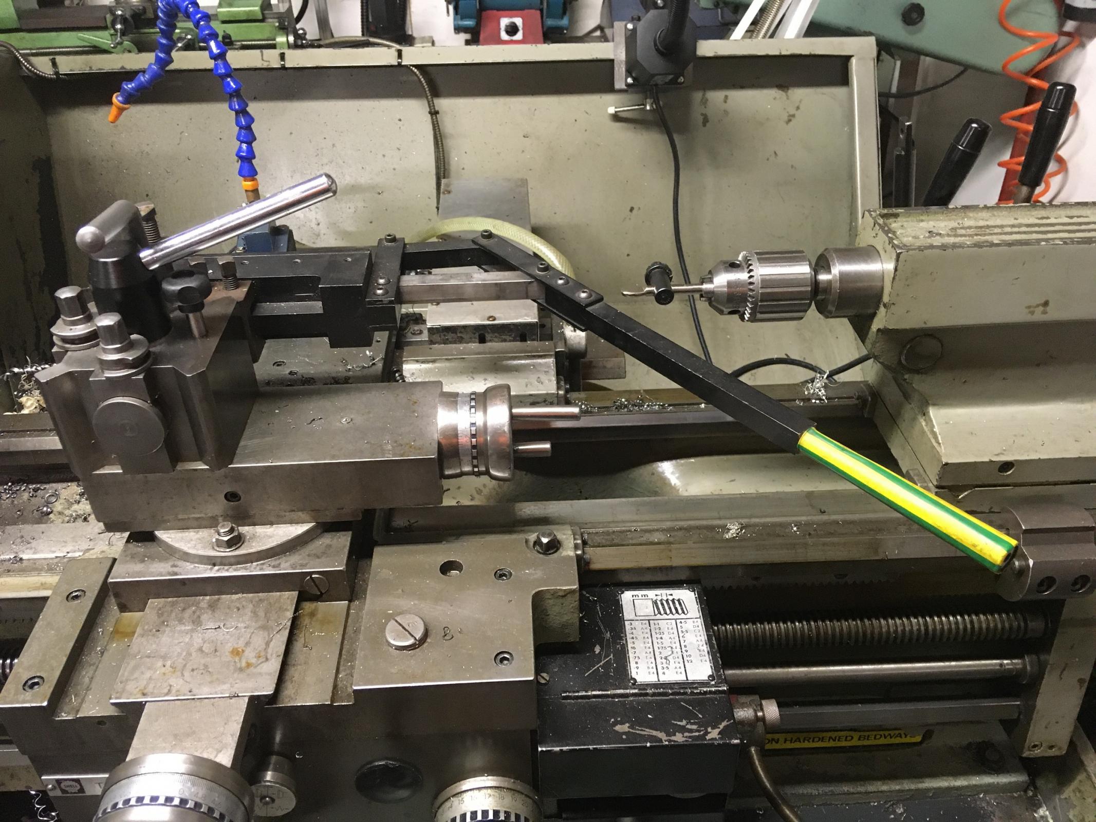

Attachment 32860
In place on the lathe with the ram fully back.

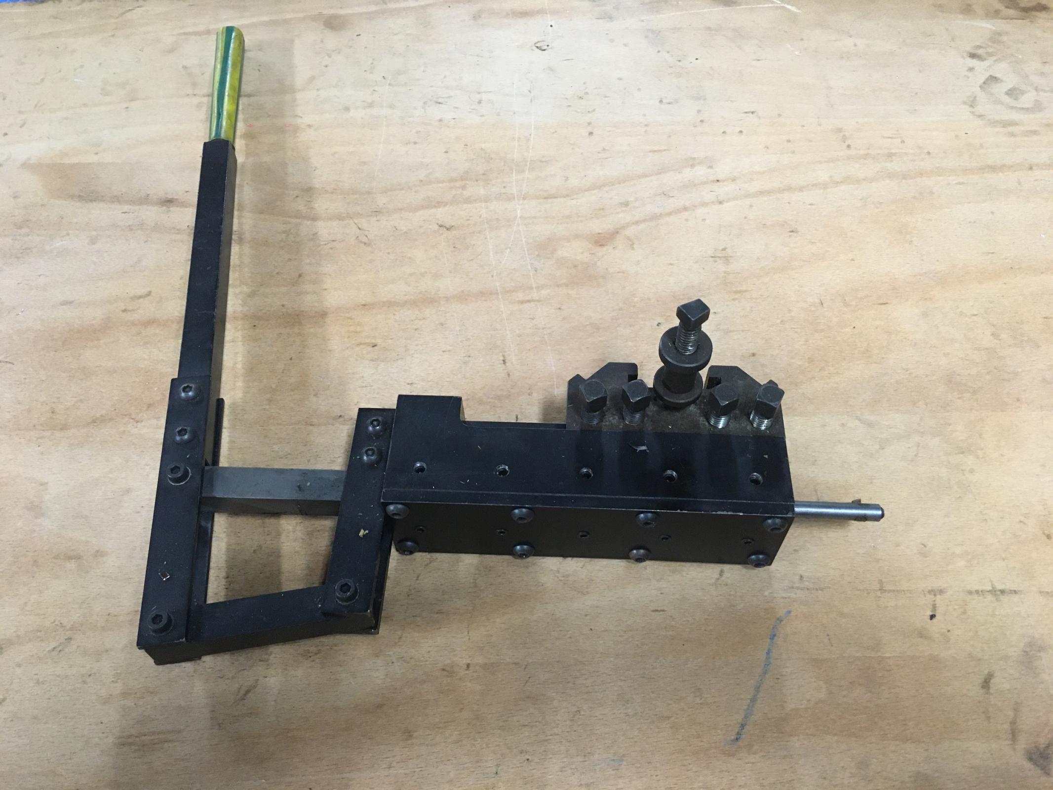

Attachment 32861
Fully forward (total tool movement 75mm / 3")

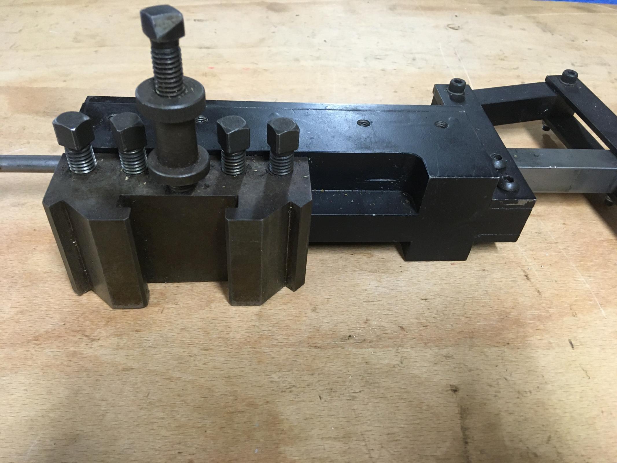

Attachment 32862

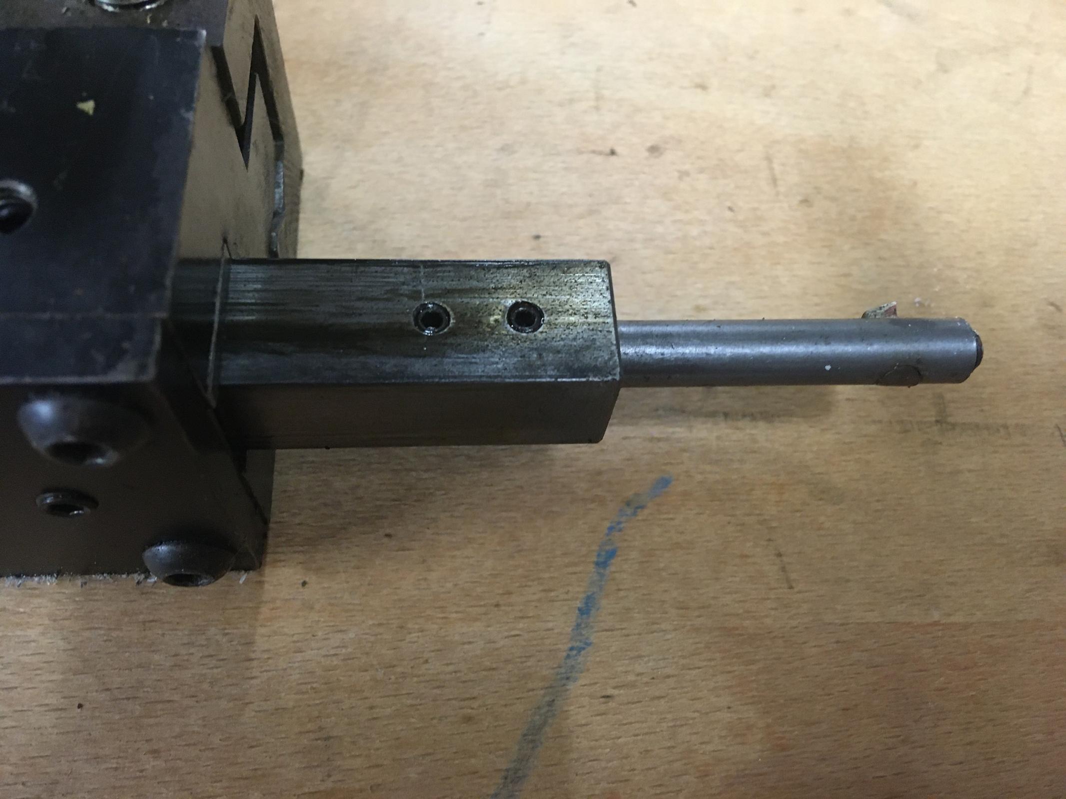

Different tool holders can be clamped to the ram.

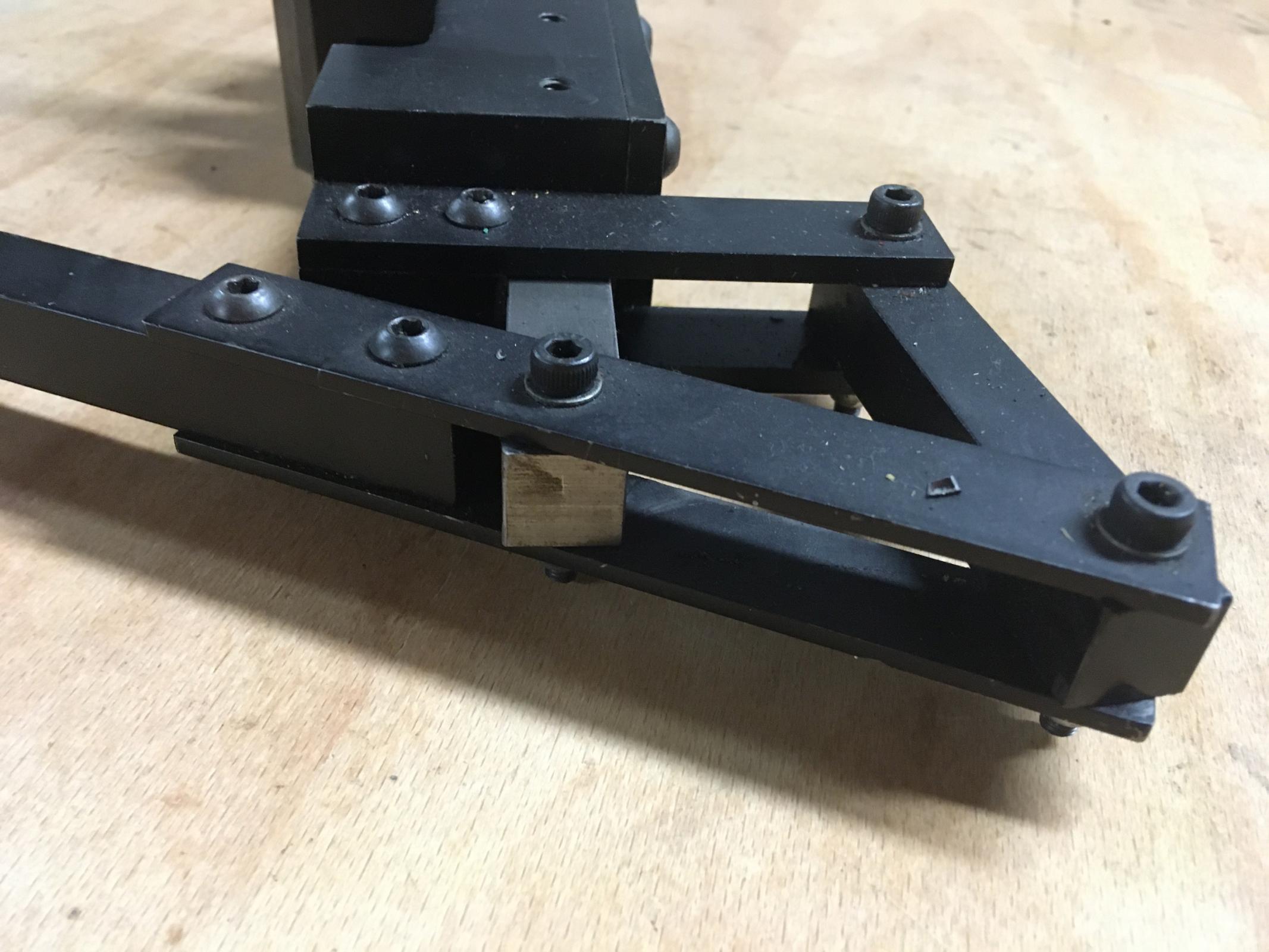

Attachment 32863
Jib/Wear plates can be seen top and to the left of the main ram. The plates are adjusted by grub screws to prevent lateral side movement while cutting.
