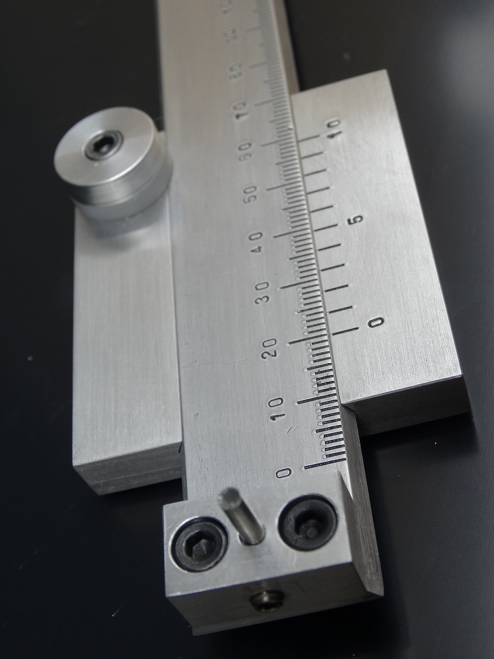

Very nice!

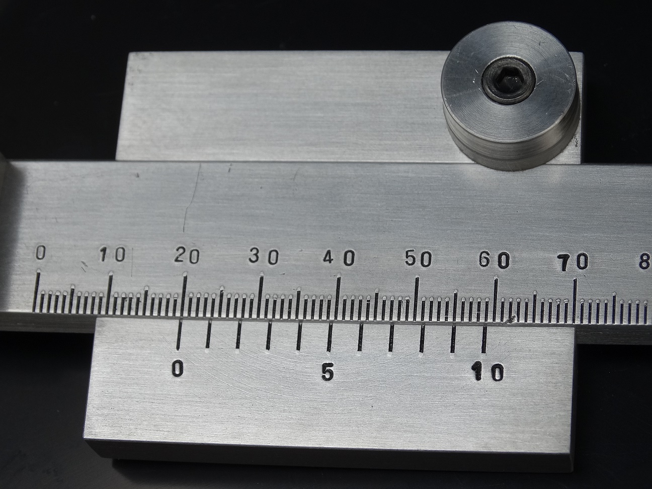

I would like to know more about how you made the graduations and you calculations for the vernier scale.
It was very simple, they must coincide:
- Zero of the vernier with zero of the fixed scale;
- Tenth division of the vernier with 39 mm of the fixed scale (equal to the caliper). Thus, each division of the vernier is worth 3.9 mm. I don't know if I explained your question but that's it ...

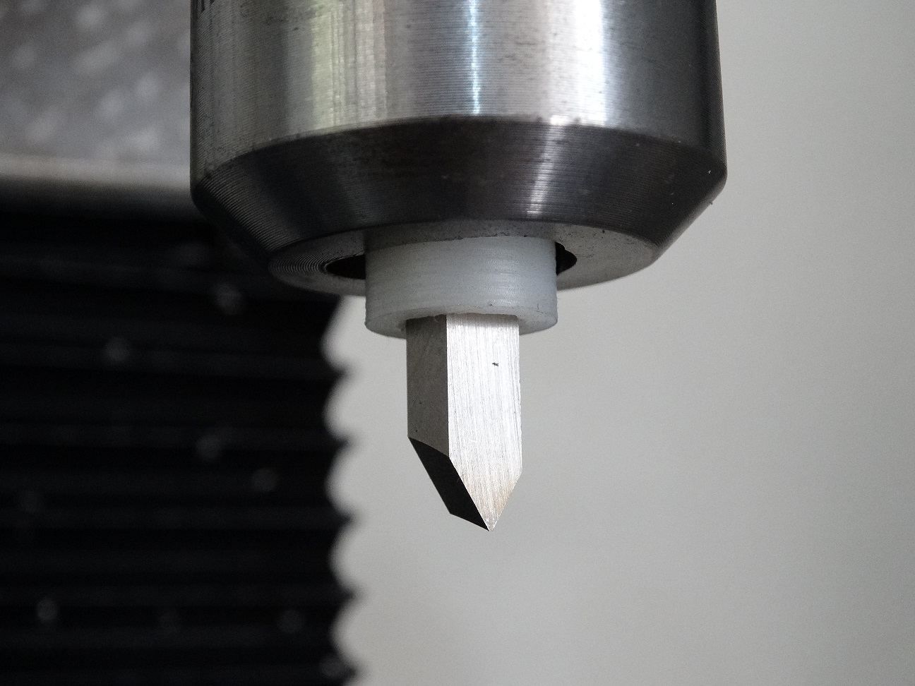

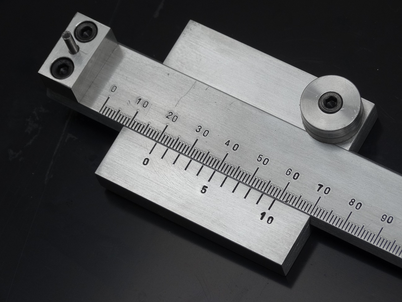

I think he's asking the same question I have. How did you acquire that main bar with nice accurate graduations? Donor tool? Likewise for the vernier scale. And, if you made the vernier, I think he's asking how you worked out the spacing. Though I've never made one, there are a references online and in books that explain how to make a vernier scale.
There's no secret! I made the graduations using a tool (see photo) attached to the chuck of the milling machine. The divisions were made with the aid of the graduated ring and a dial indicator. That simple!
Attachment 37319
The vernier was even easier to do. I observed what the divisions of a common caliper look like and made it the same way. The distance between divisions of the vernier is 3.9 mm (because the zero of the fixed scale coincides with the zero of the sliding scale and the tenth division of the sliding scale coincides with 39 mm of the fixed scale), when the caliper is closed.
I didn't notice it before, but looking at the images enlarged, I can see the slight buildup at the top of the lines that informs on the method of creation. I think it actually makes a very nice effect. I've done graduations the same way (nothing like yours, but just visual alignment references), but my ability to provide nice looking stamped letters/numbers like yours is far short of the task. Great work!

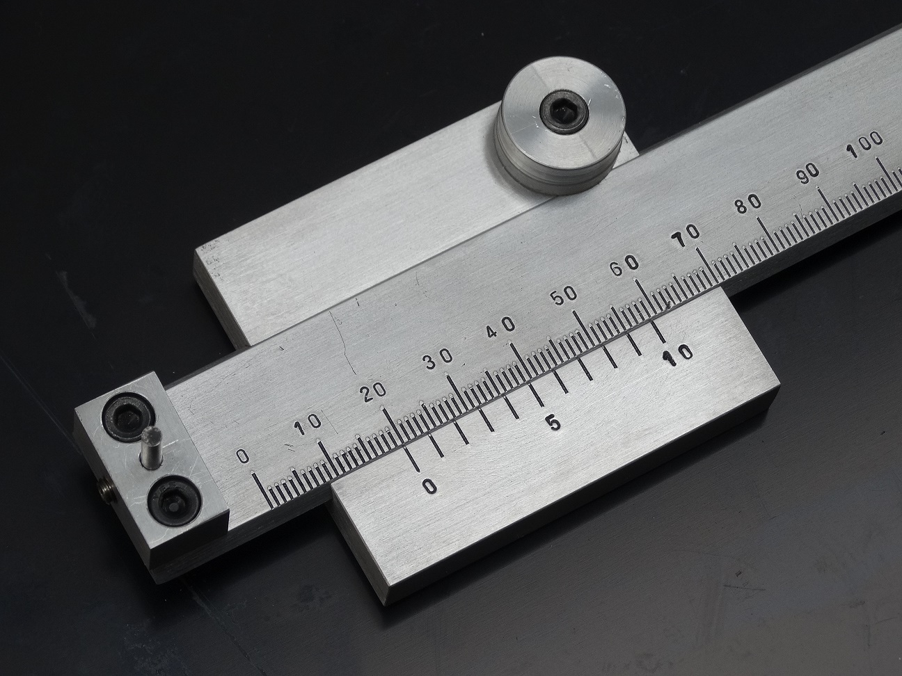

For scales divided into sensible decimal values, designing a vernier isn't very difficult.
Decide the smallest interval on the main scale you wish to further subdivide using the vernier. As an example we'll use the vernier designed in the OP so this value is 1 mm.
Decide the approximate length you wish the vernier to span; this value affects how easily it can be read. In the OP the approximate length of the vernier scale is 40 mm.
Subtract the first value from the second... 40 - 1 = 39 mm
Divide that length into ten units. Thus each interval on the vernier is 39 / 10 = 3.9 mm. Examination of the photographs in the OP shows this to be correct.
A further example... If the vernier were chosen to span a more conventional 10 mm then 10 - 1 = 9 and the vernier would have ten divisions, each 0.9 mm long for a span of 9 mm, or about a centimeter (0.4") which might be hard for old guys with less than perfect vision to read.

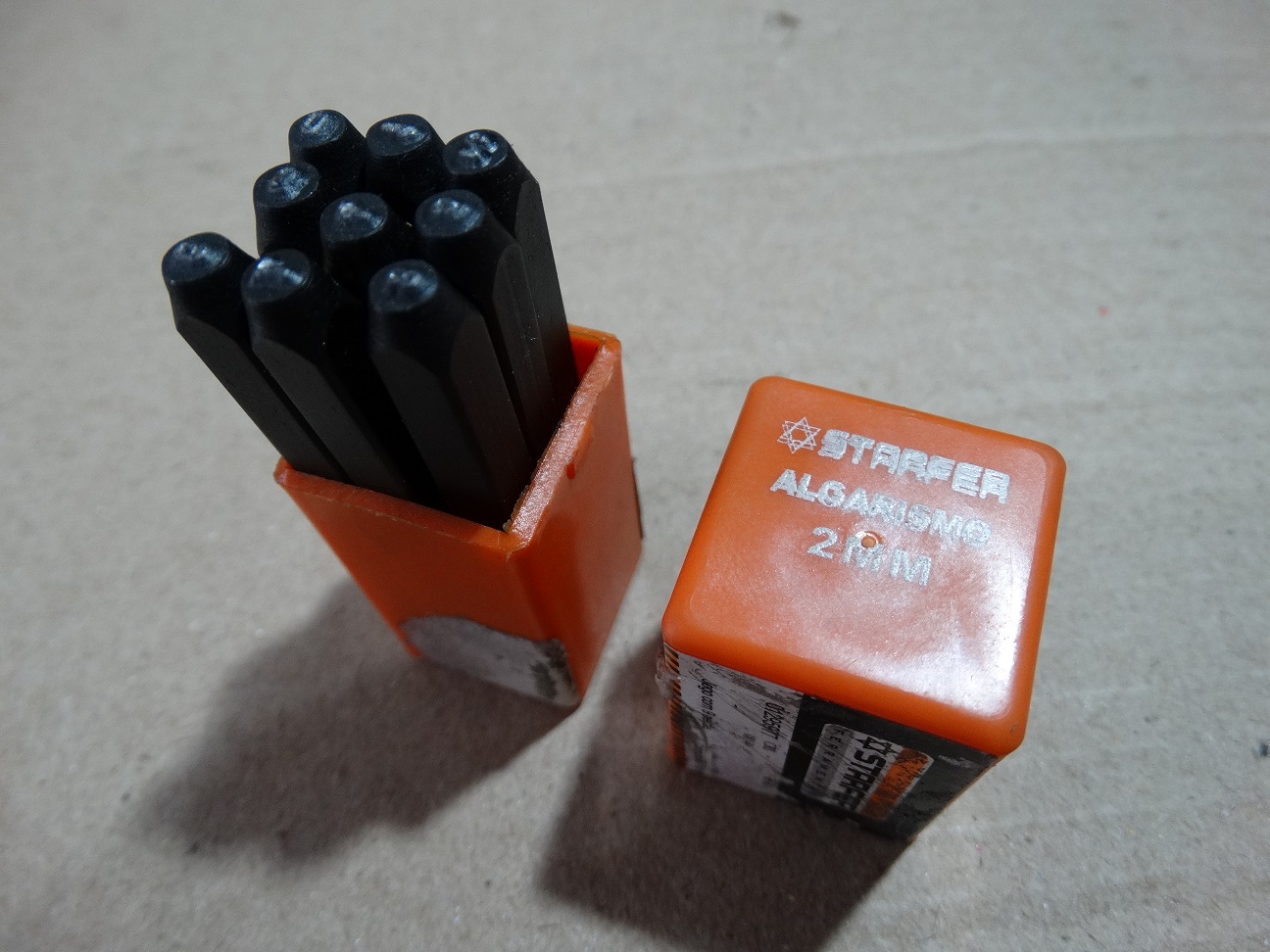

Baddog, the printed numbers are also very easy to make. I used the set of markers (see photo), painted with black automotive paint and then sanded (220 mesh). Just that, nothing more...
Attachment 37320
