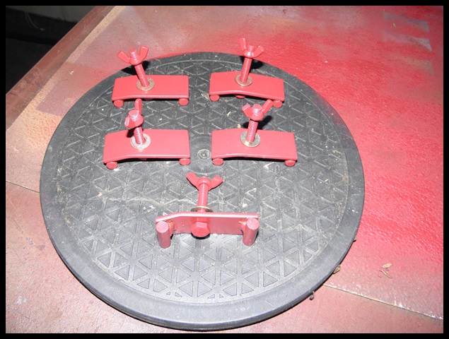

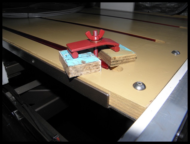

    Material hold downs. Made from 1"x1/8" bar stock,3/8"round stock and 1/4 " bolt with wing nutClick image for larger version.
ID:	15263Click image for larger version.
