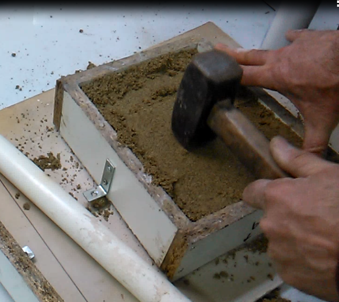

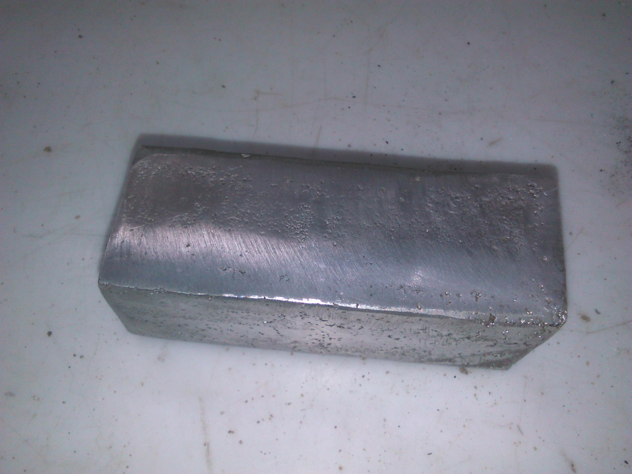

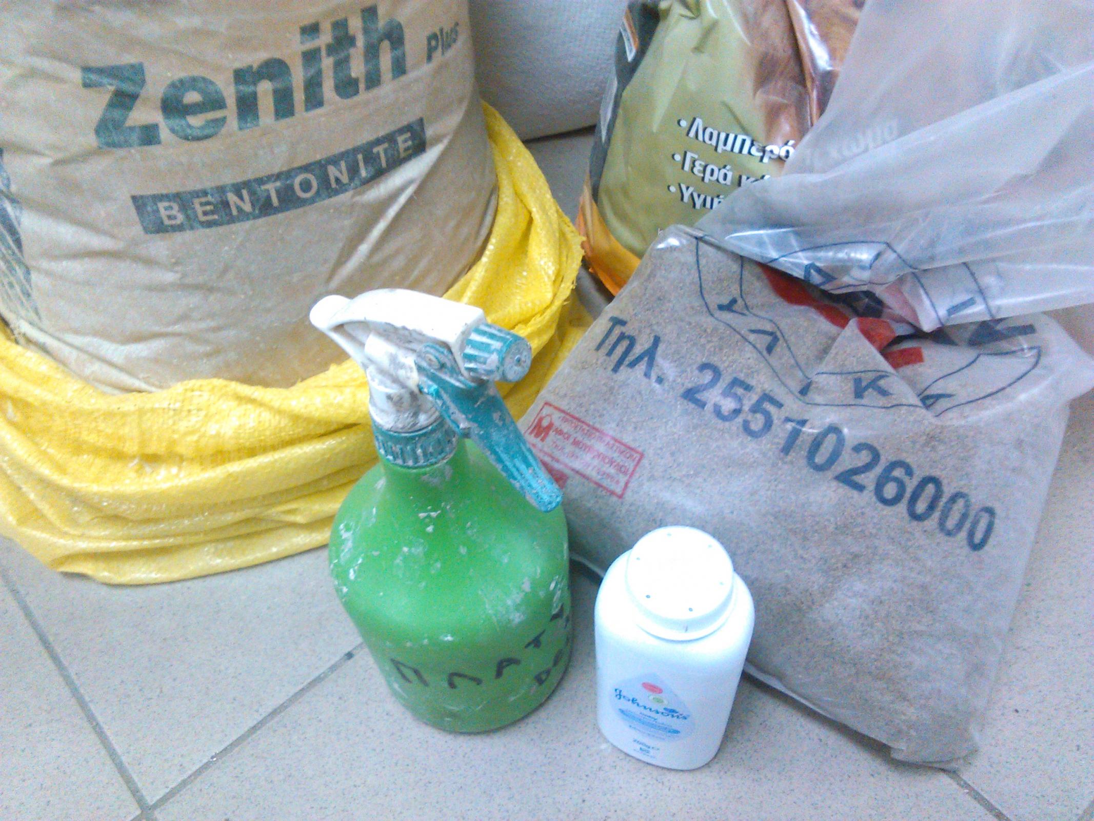

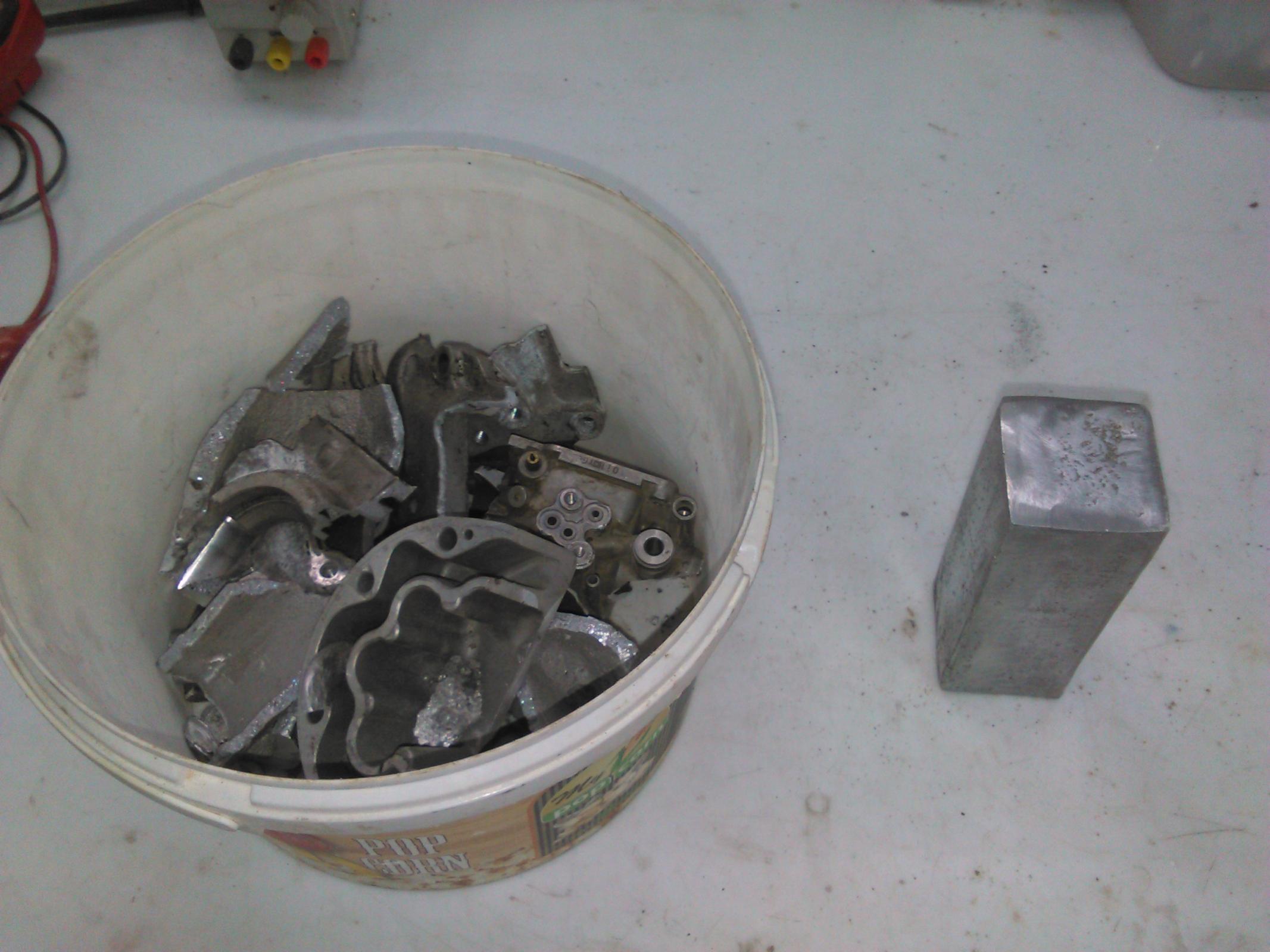

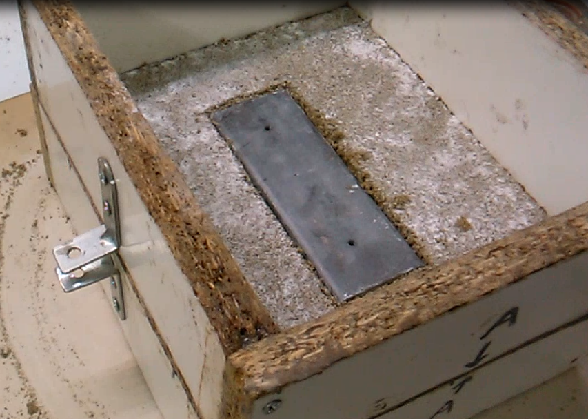

    Here I tried to melt aluminum in homemade sand mold. I ' ve used betonite and sand to make the mold. I' ve put 150 gr of betonite in one kilo of sand. I also put some water and the mixture is ready.
    YOU CAN WATCH HOW I MADE THIS HERE:
