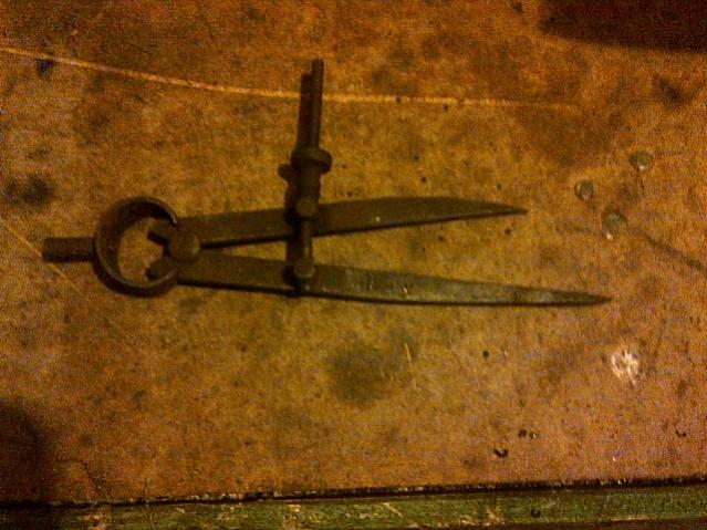

first up is a set of modified dviders where one leg as been shortened and reshaped back to point to make it easier to mark points in from edge of metal box section when needing to mark same point on several pces.

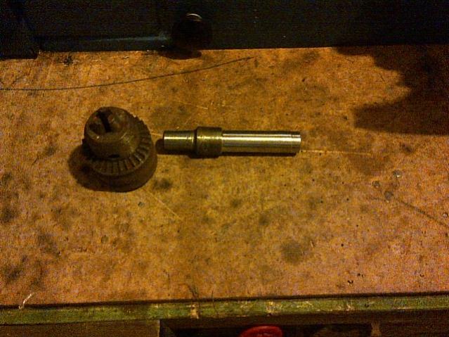

second is a tapered chuck holder that i turned down to use in lathe chuck for a job i was doing.Attachment 671Attachment 672
