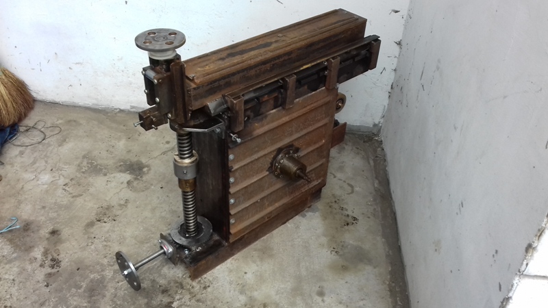

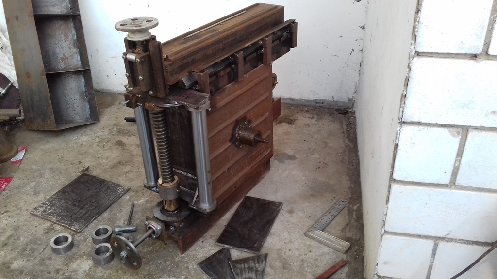

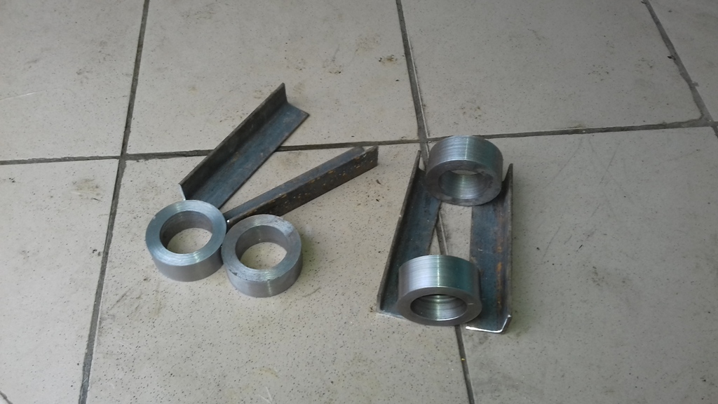

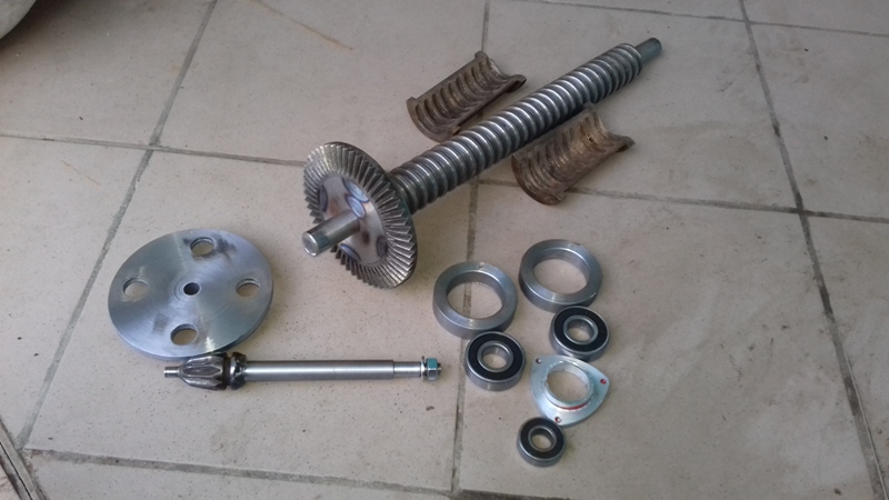

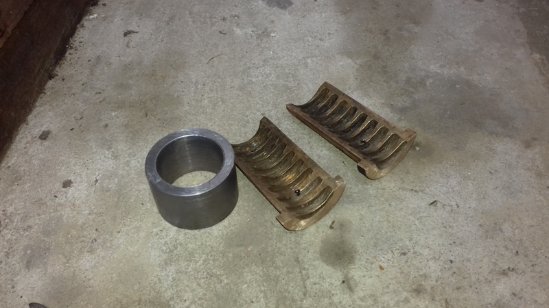

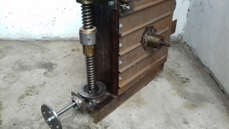

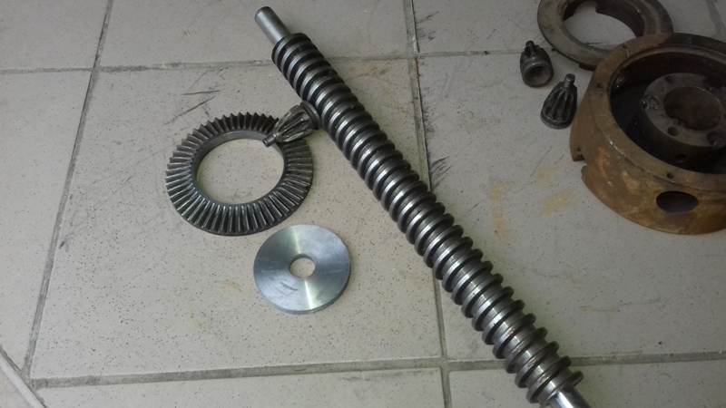

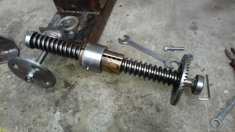

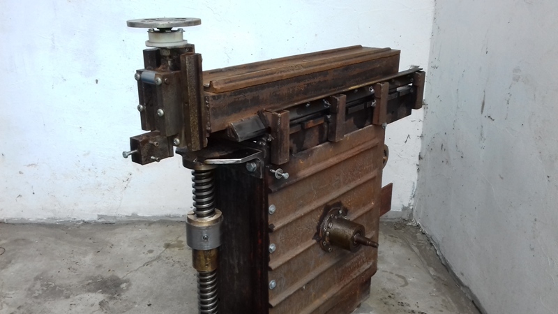

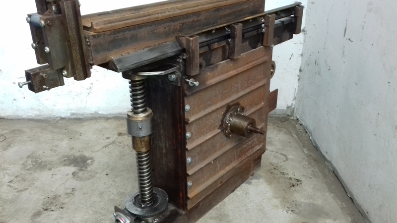

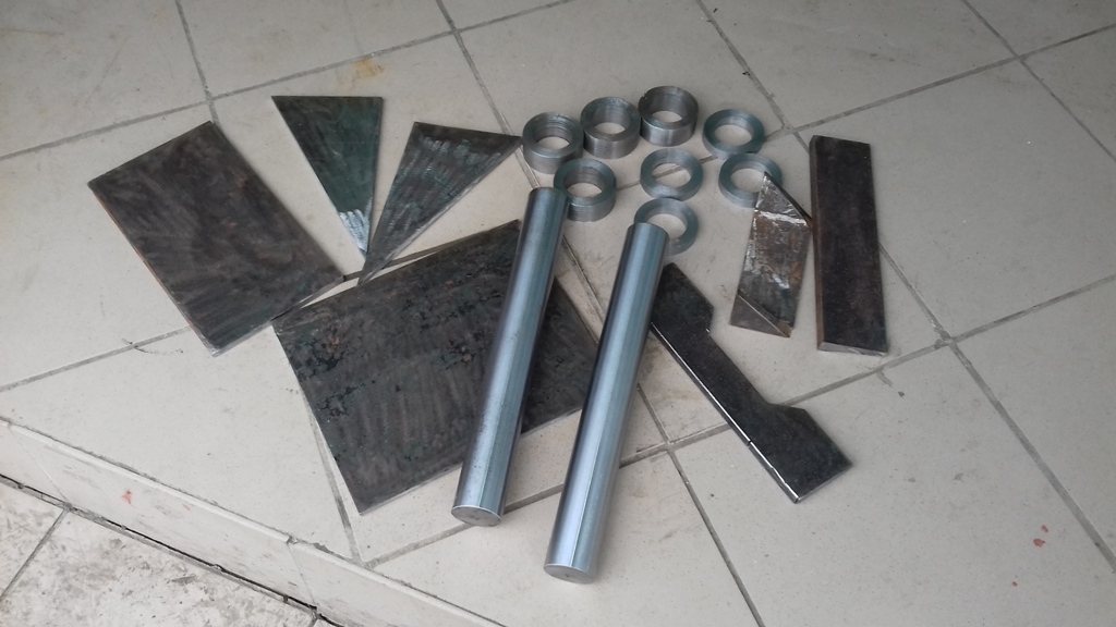

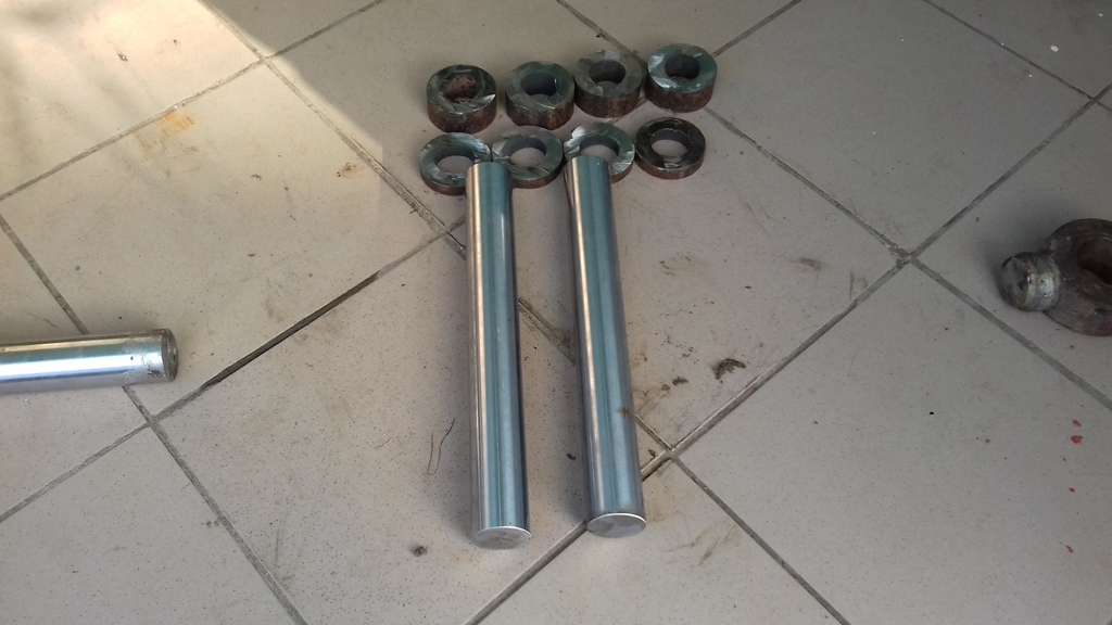

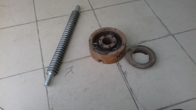

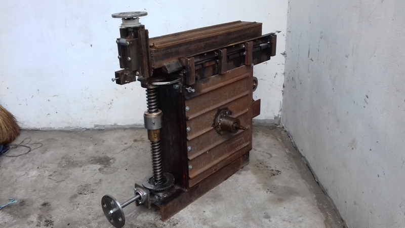

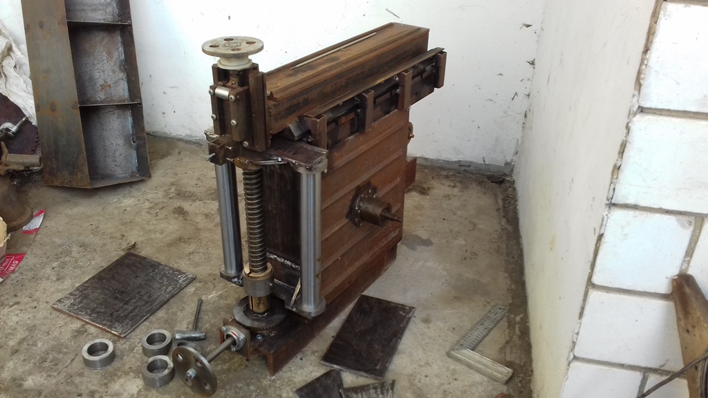

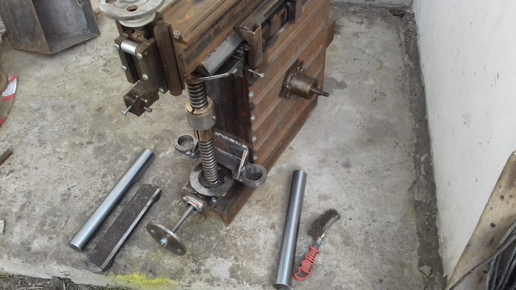

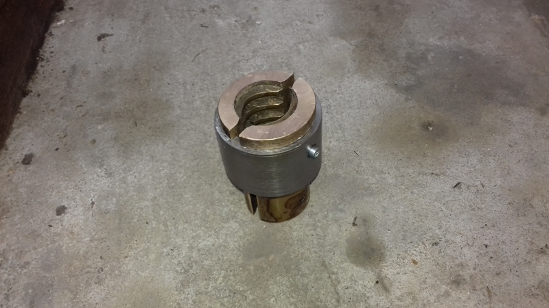

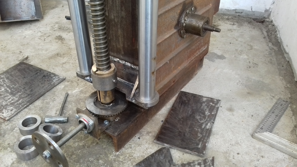

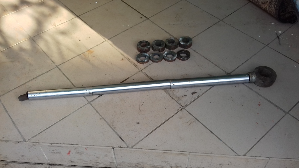

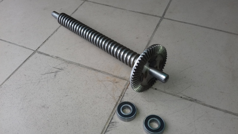

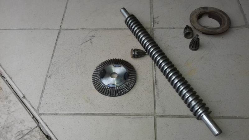

Resumption of work on the project
Attachment 32459 Attachment 32460 Attachment 32461 Attachment 32462 Attachment 32463 Attachment 32464 Attachment 32465
The next stage is the production of the coordinate table.
