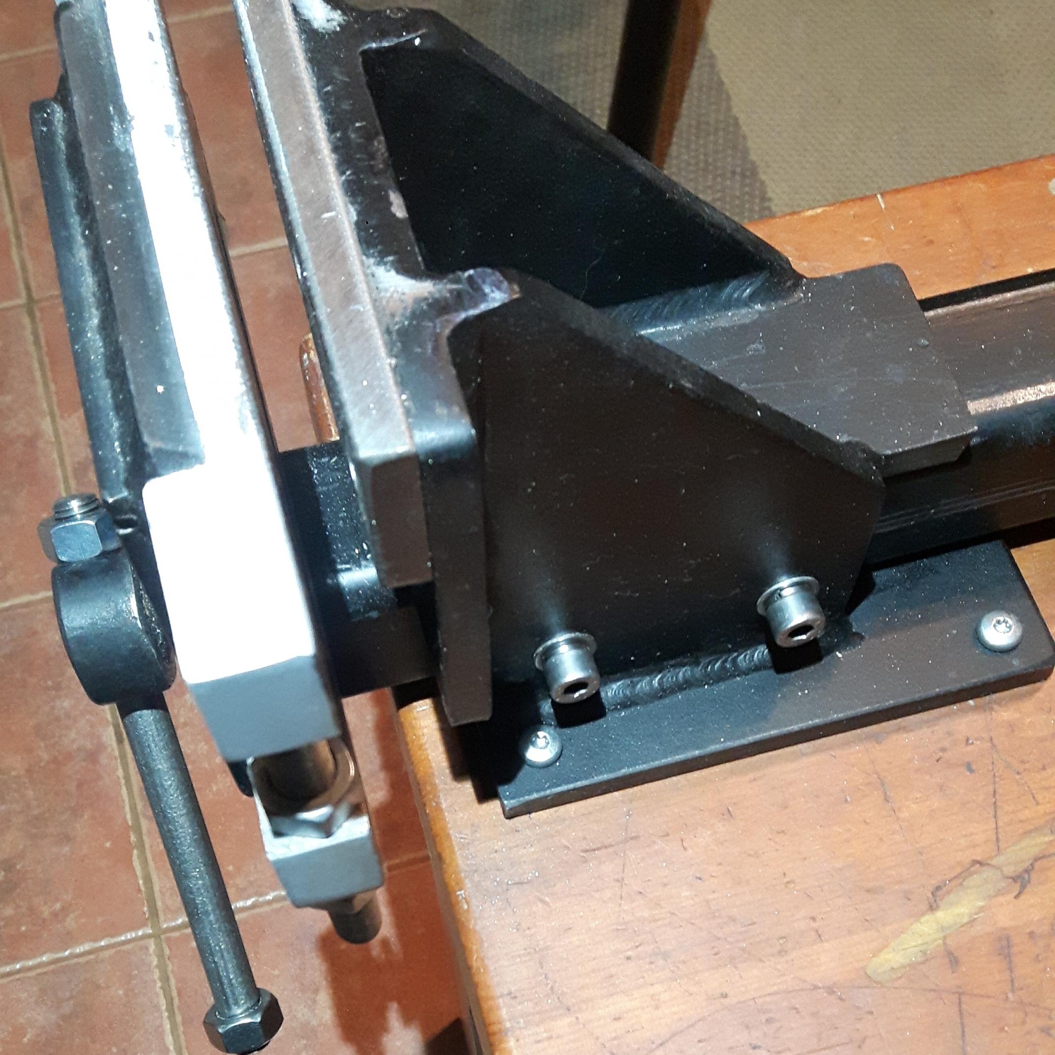

    Made a metal vise.
    Materials:
    10mm steel plate.
    50mm x 50mm x 5mm square tubing
    12mm bar stock for handle
    30mm x 30mm bar stock for connecting handle.
    Trapezoidal threaded rod and a nut.
    Very simple design.

  10. #7
    Jun 2016
    Jyväskylä Finland
    832
    558
    Thanked 1,839 Times in 507 Posts
    Tuomas's Tools
    Vise had little too much clearance on sideways. Fixed that with two M10 bolts on the both sides.
    Those leans against slide and keeps jaws straight when using only one end of the jaws. That gives little better hold, and even pressure.
    Bolts are cut to suitable lenght and locked with spring washers.
