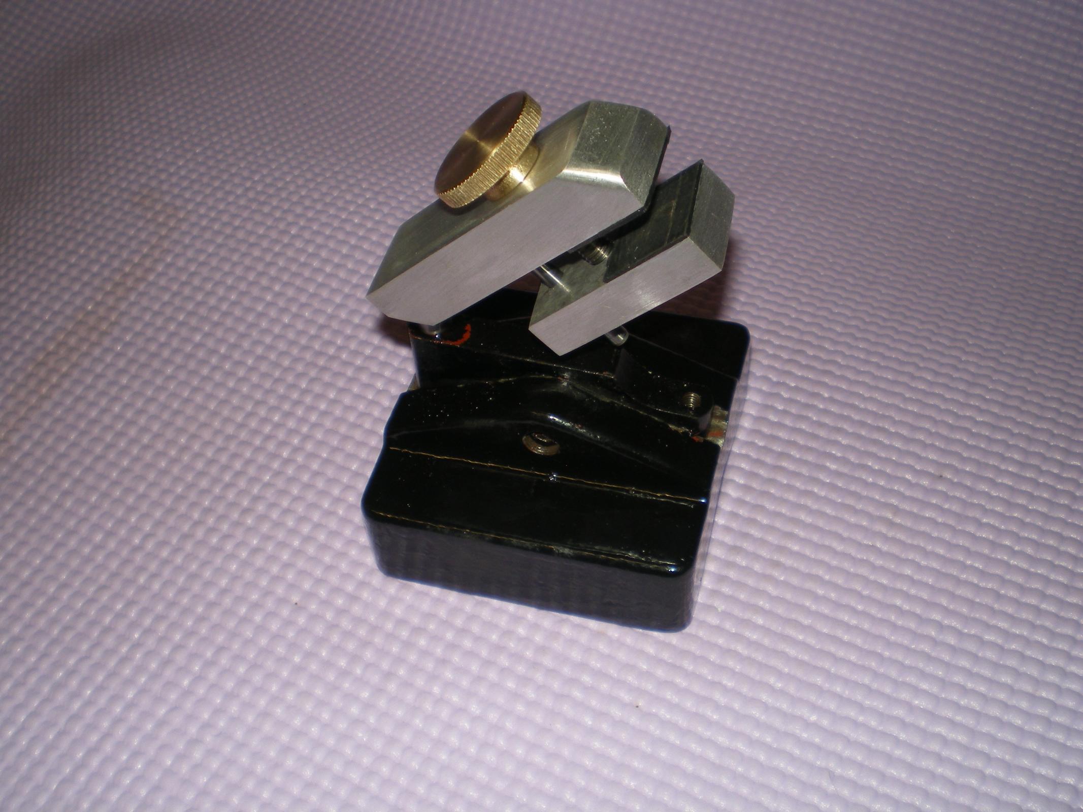

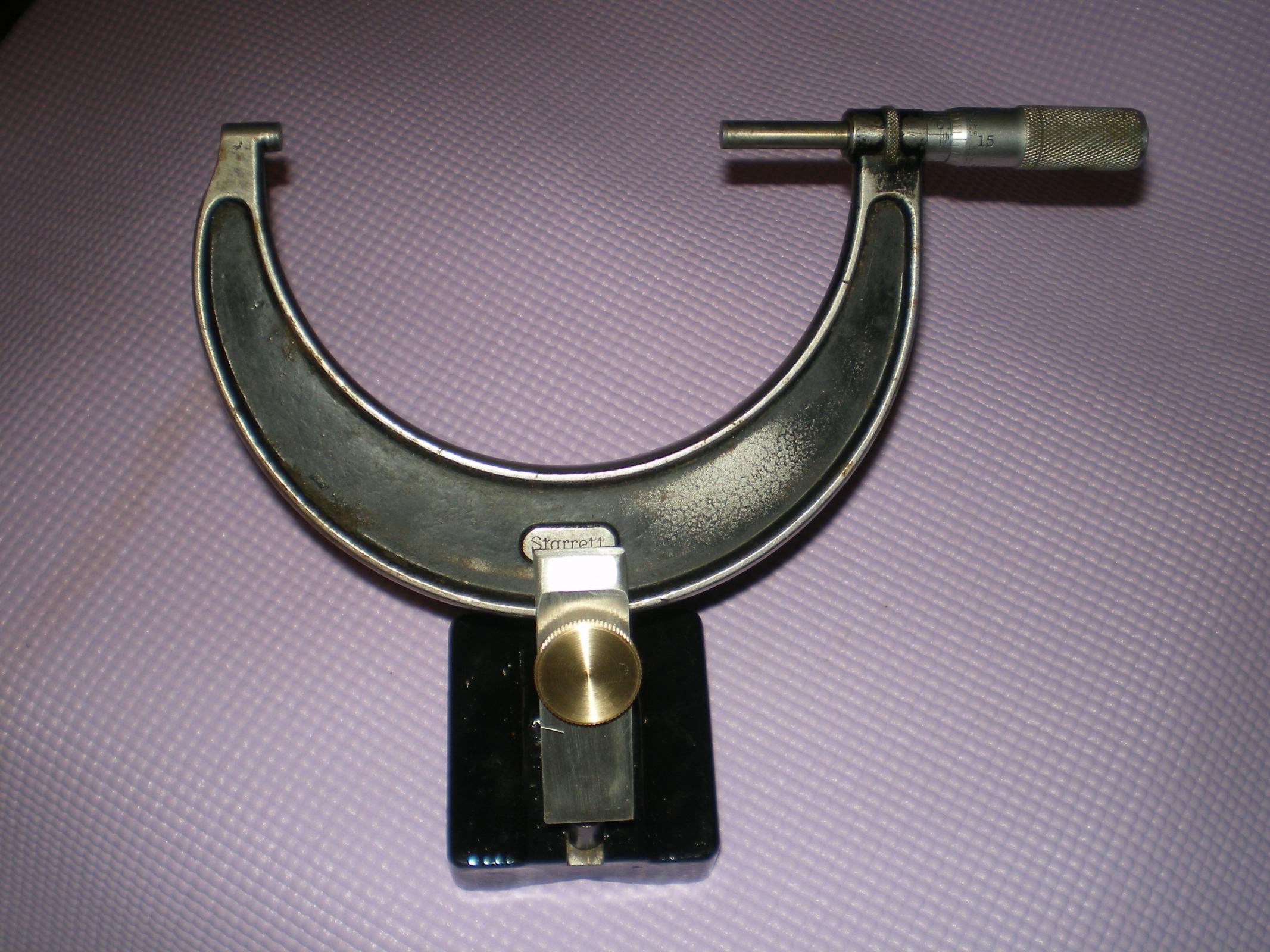

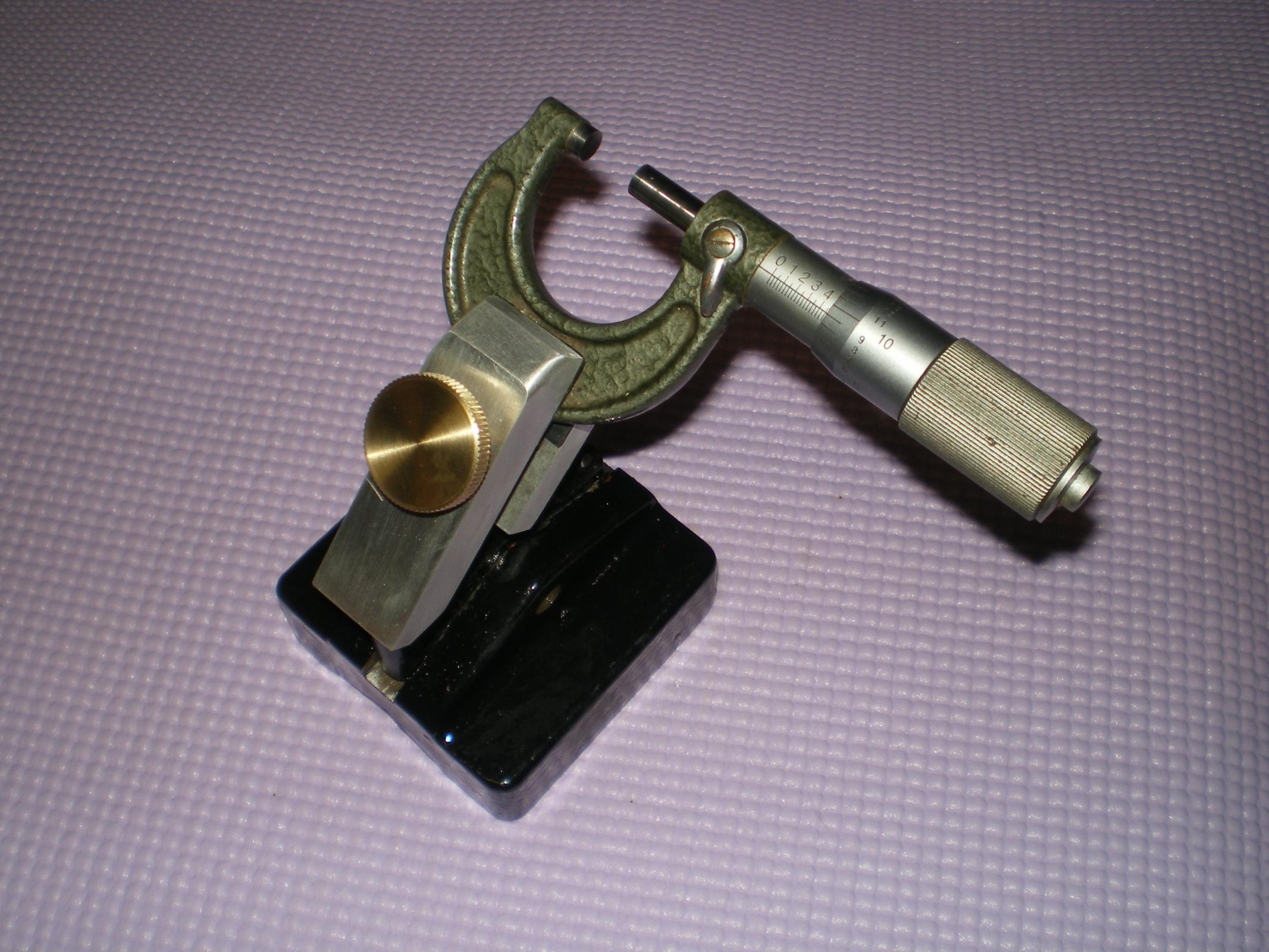

    This uses a cast iron scriber base that was surplus (I have a better one) and some alloy from the scrap bin, only took a couple of hours to make. Not much else to say, its nice and heavy and does the job and easily holds large micrometers.
