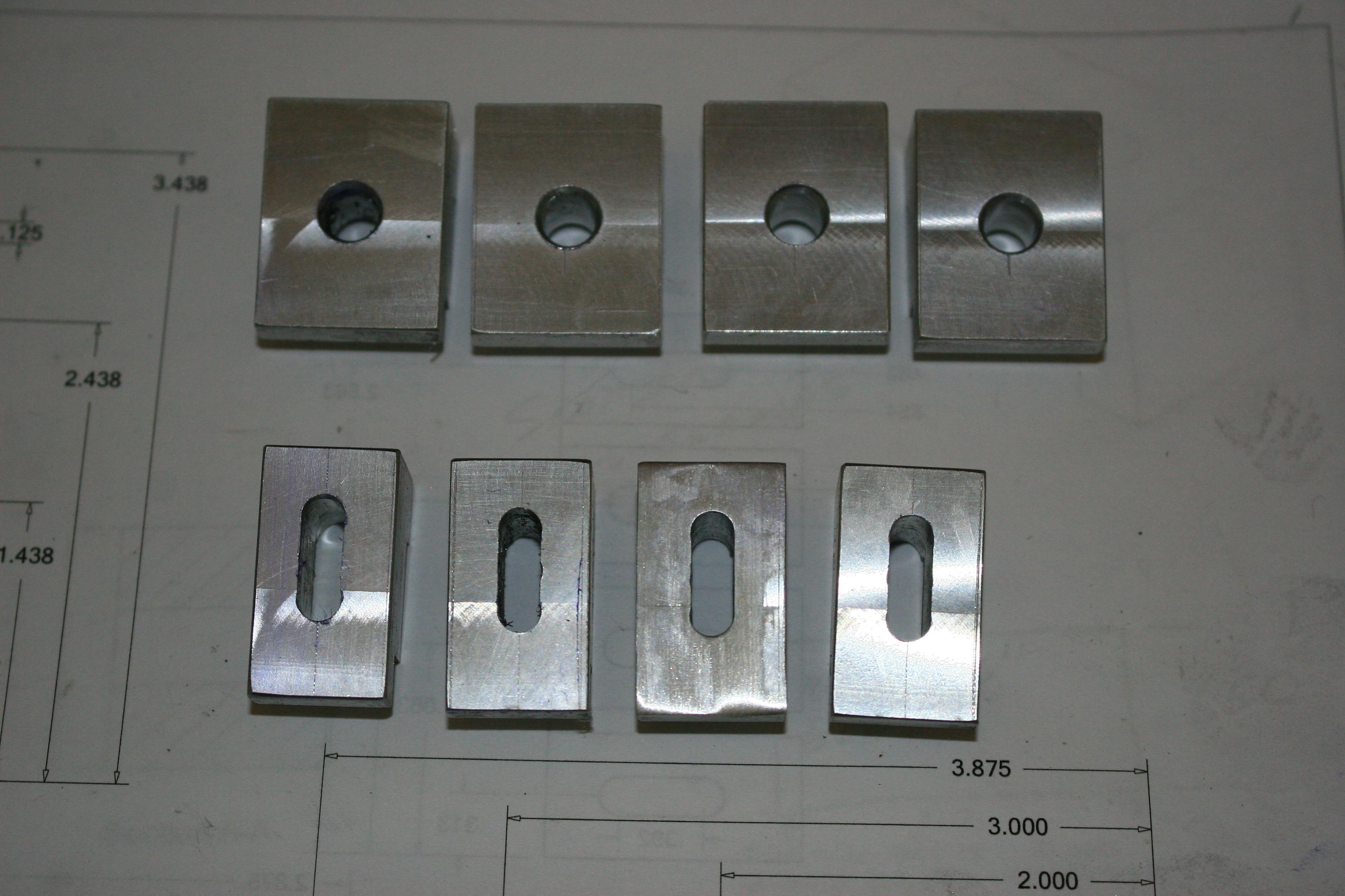

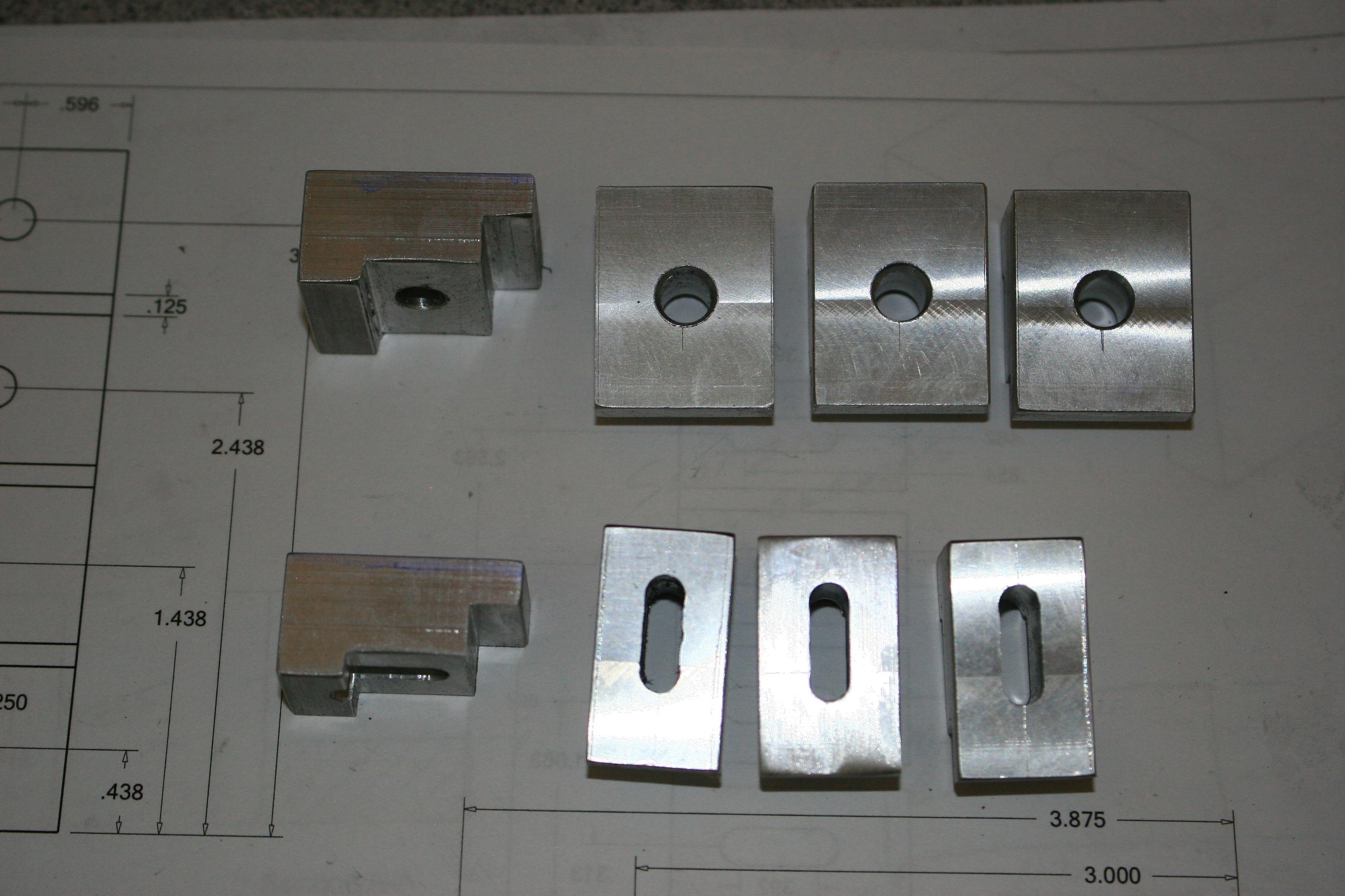

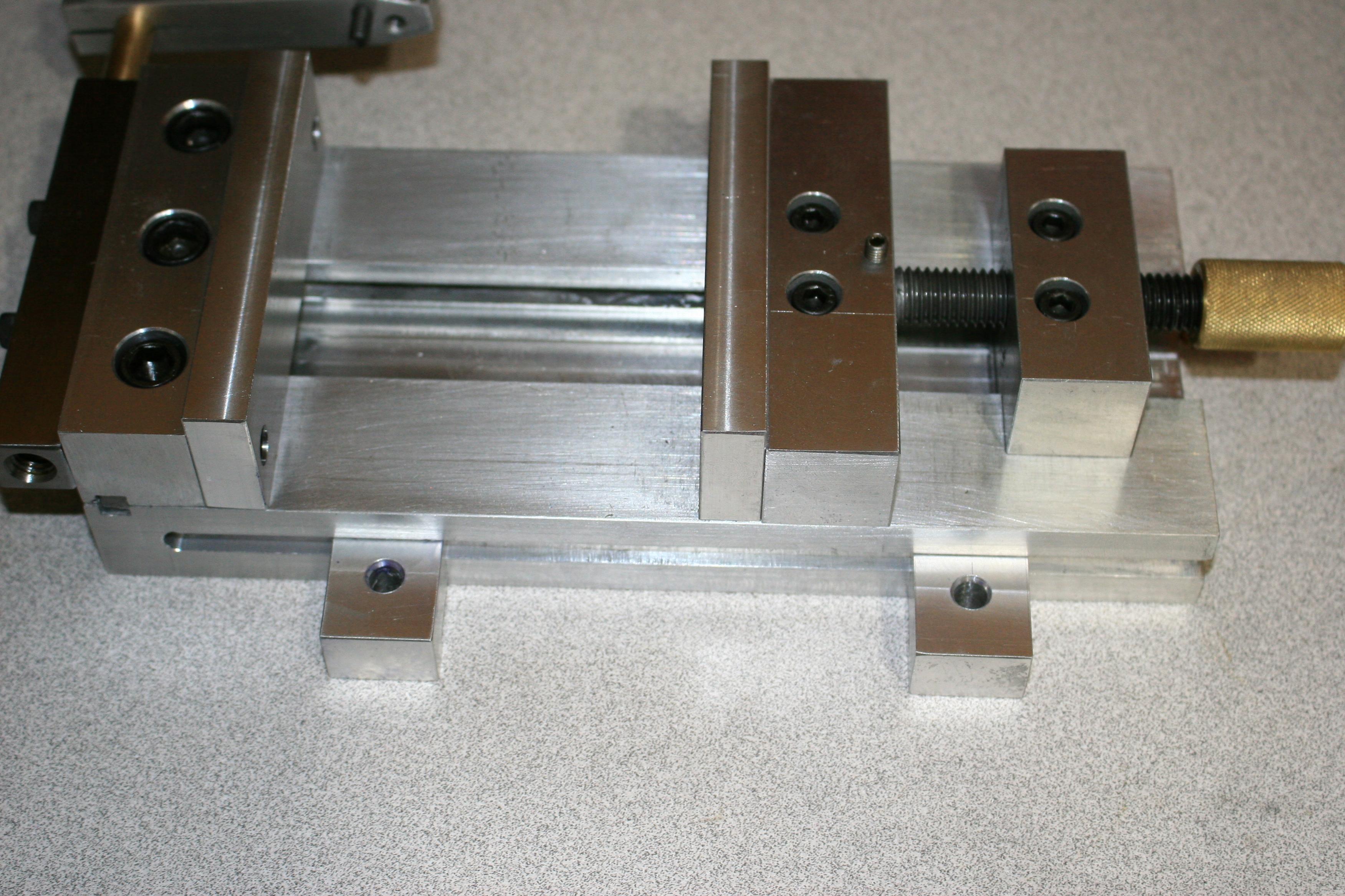

    The smaller clamps with the slot are for a tooling plate with 10-32 holes spaced 1/2" apart.
    The larger clamps are for my mini mill table slots using 1/4" hardware and T-Nuts.
    Easy to change a couple of dimensions to fit your exact needs.
    Cheers, JR
