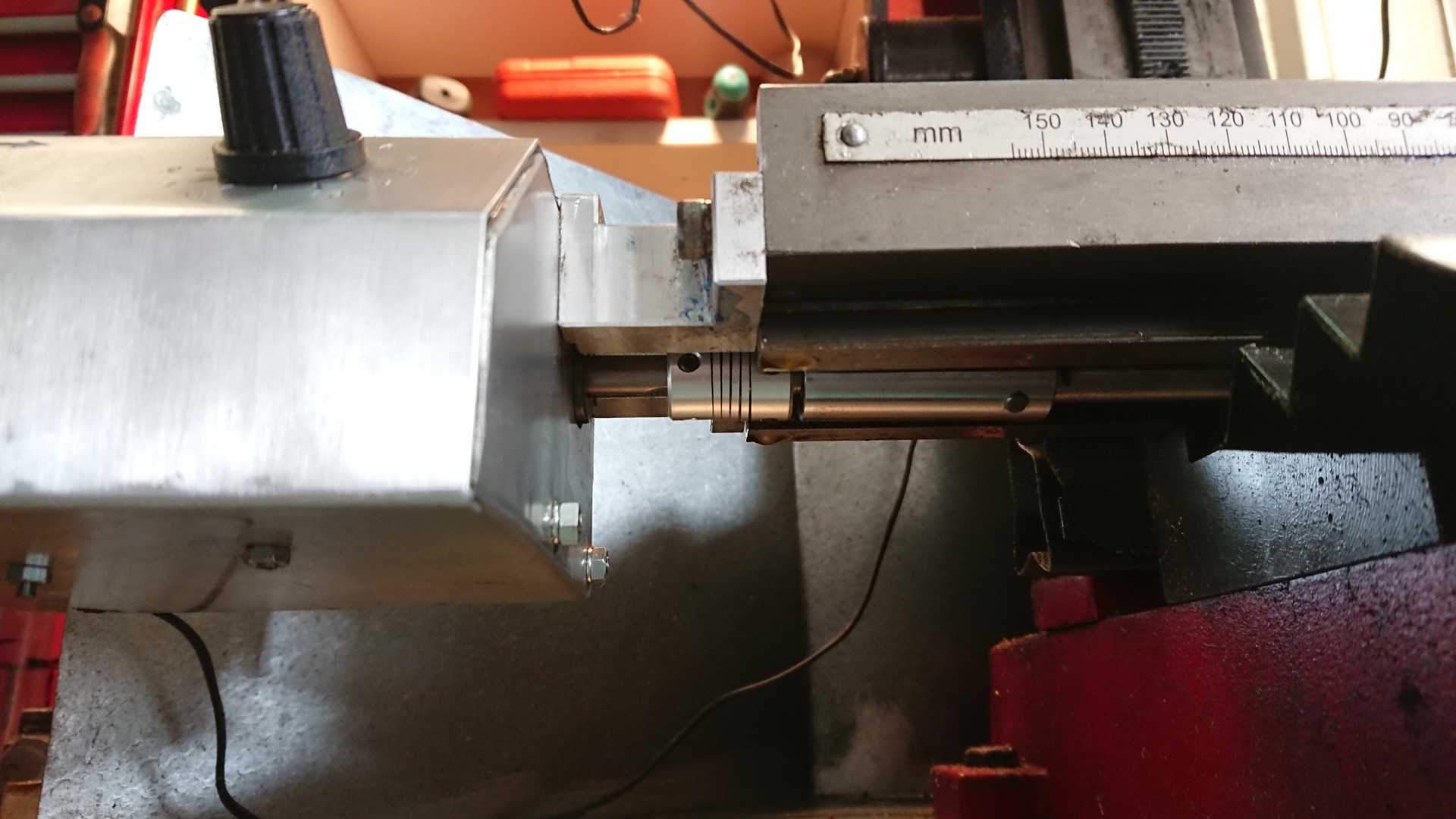

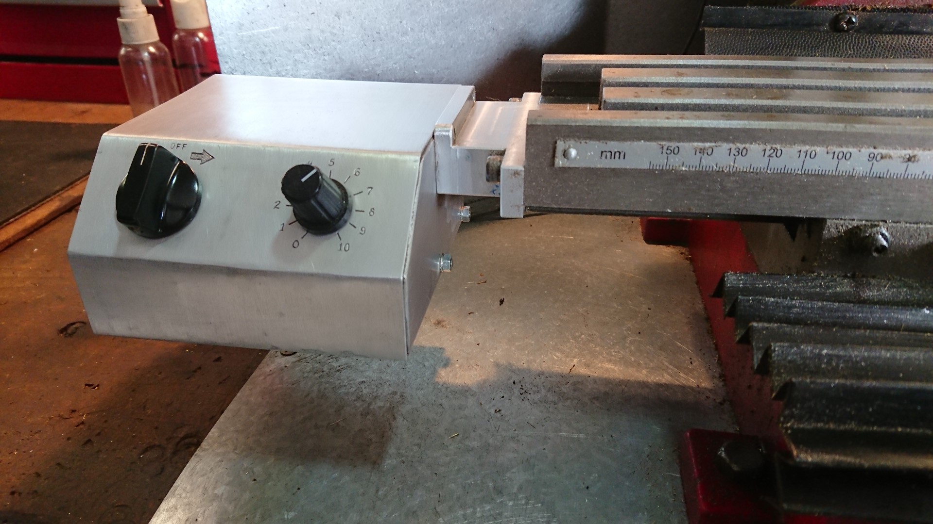

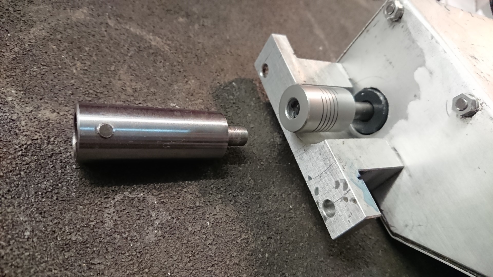

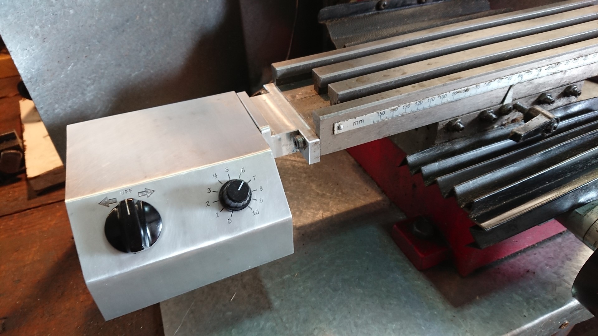

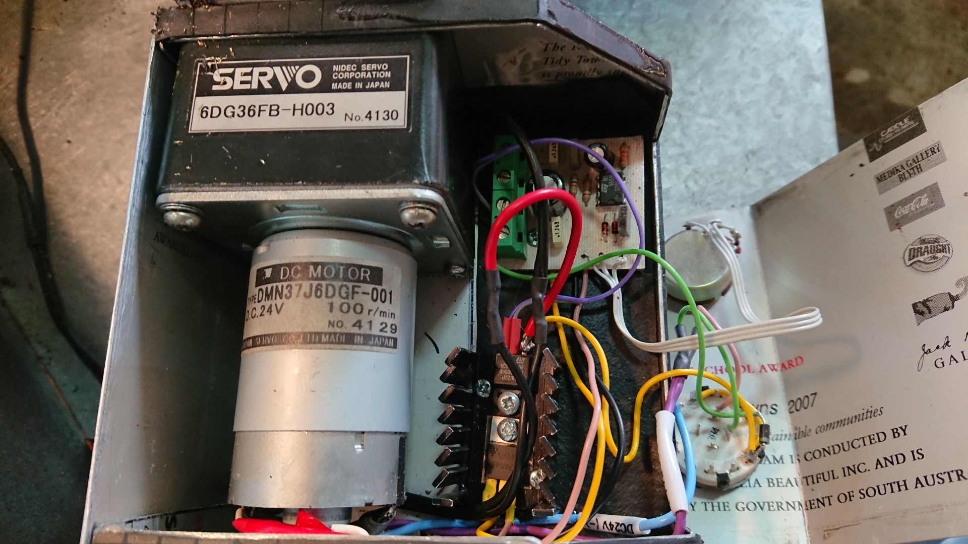

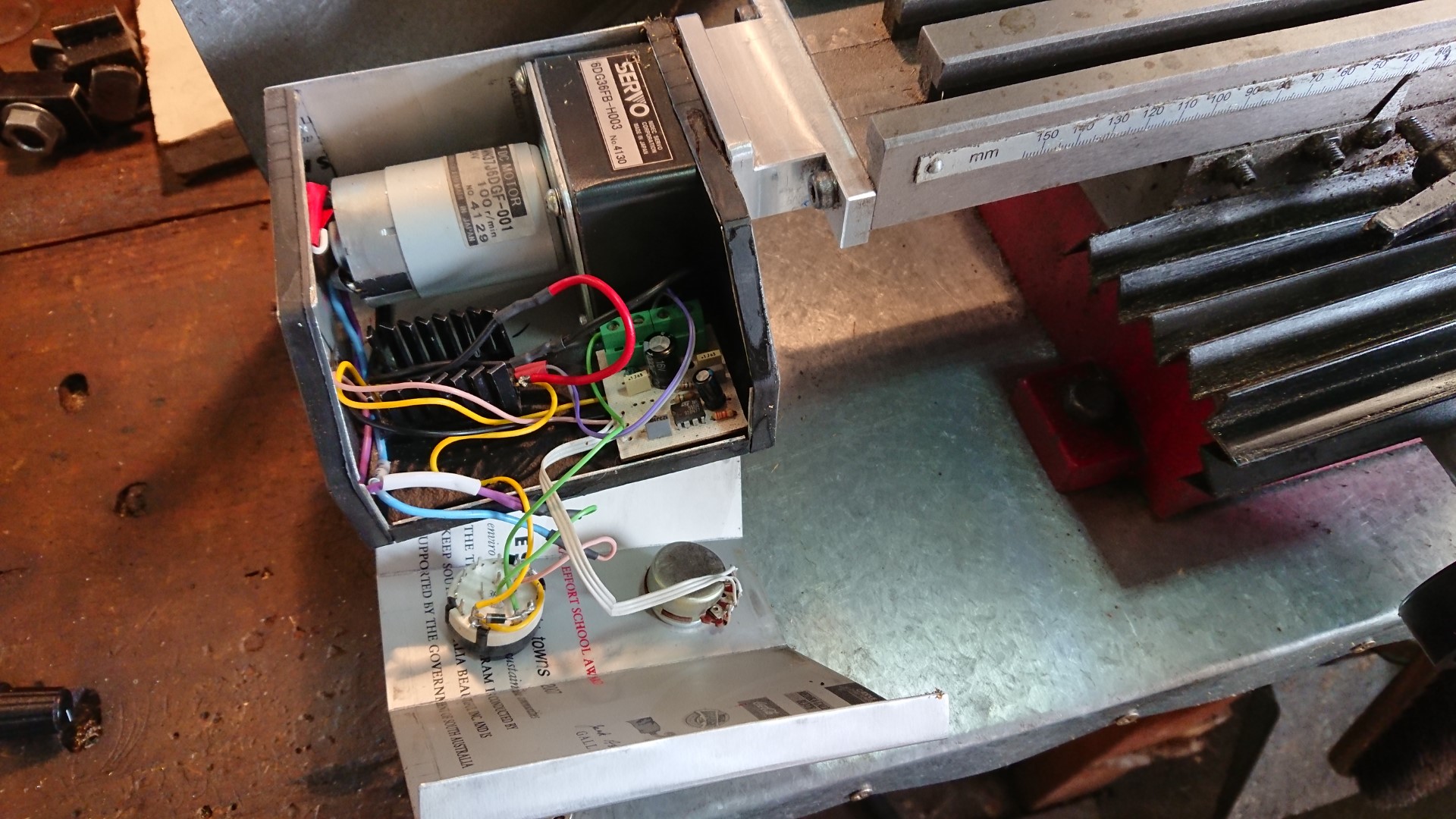

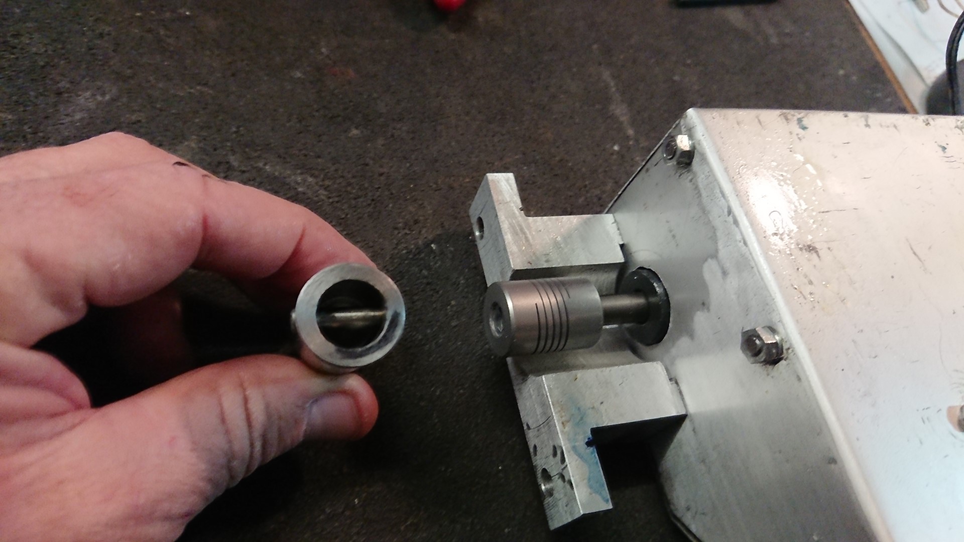

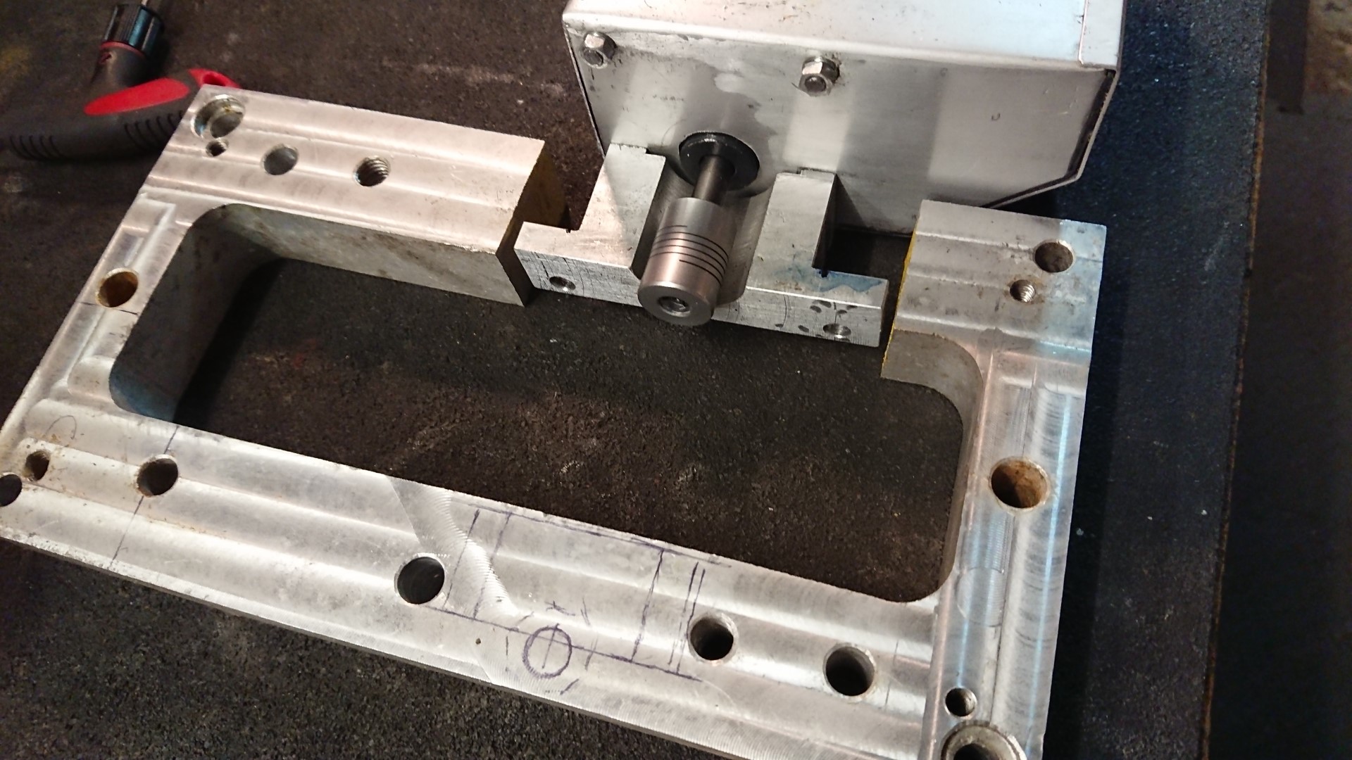

Developed RSI after turning the x axis for hours on end, hence had to make power feed device. OMG... never gunna do it the old way ever again!!
Here's what I came up with...
