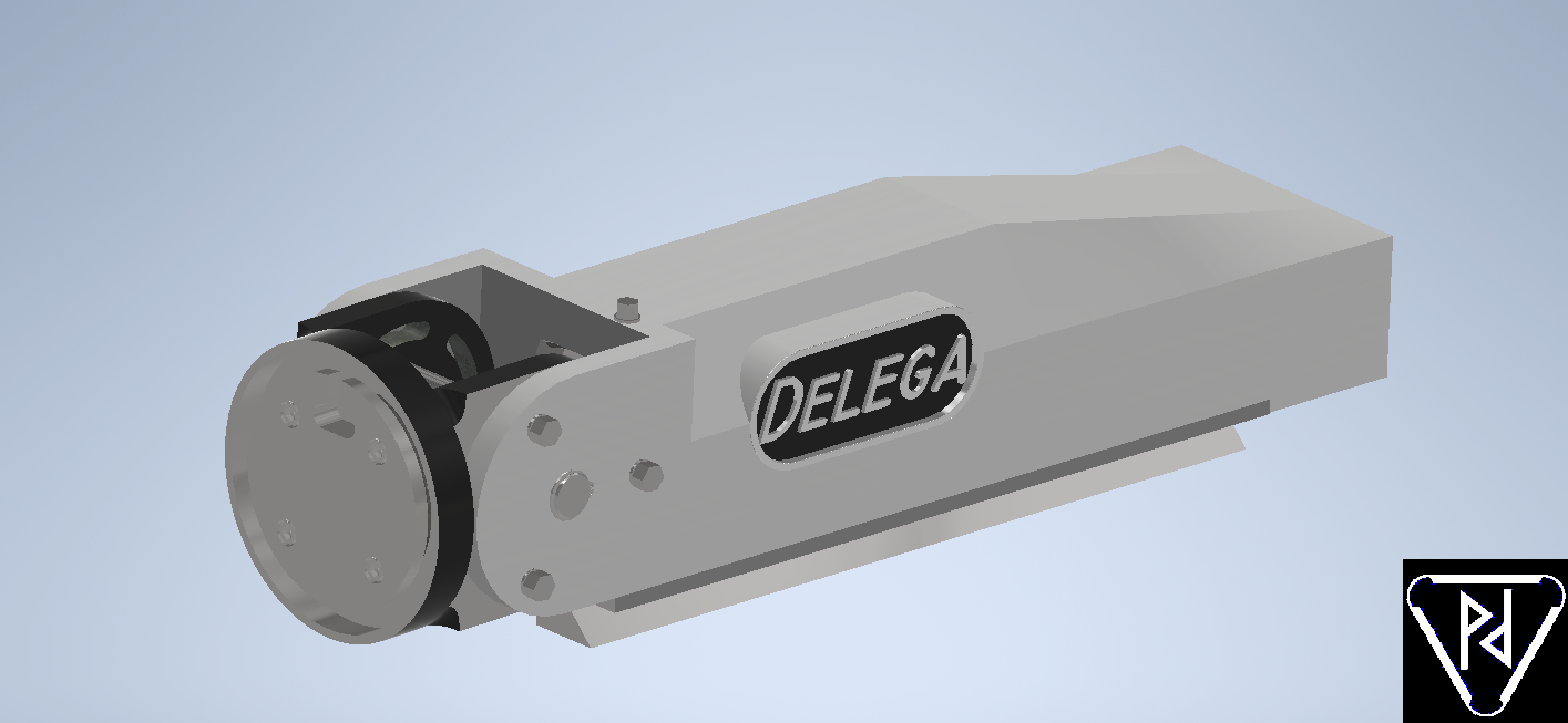

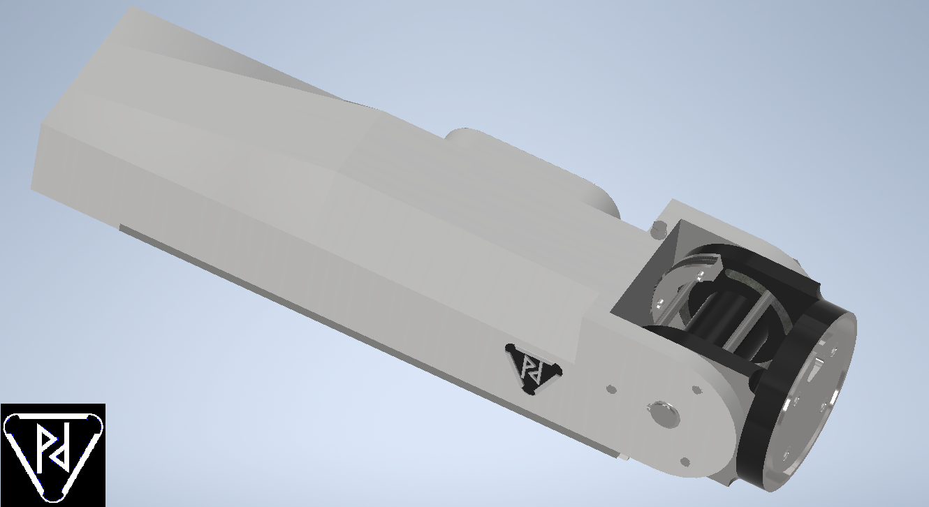

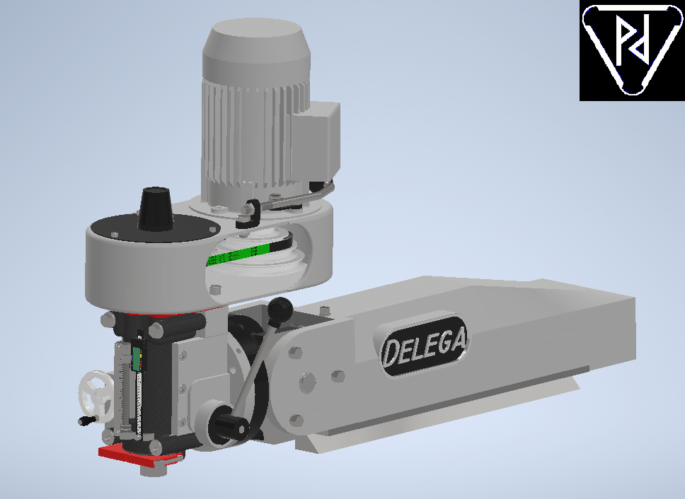

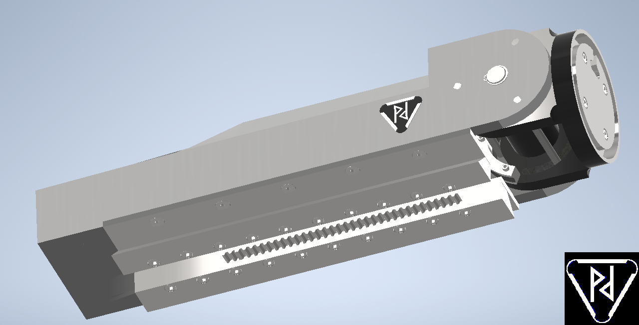

    Still nothing new in "real" build however I'm making full 3D model of the machine.
    This is how will look the ram of my machine.
    Milling machine - video-ram1.pngMilling machine - video-ram2.pngMilling machine - video-ram3.png
    And assembled with milling head.
    Weight of head and ram assembly is 165 kg.
    I will post next updates of 3D model.

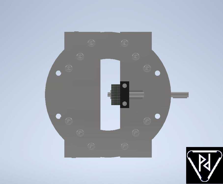

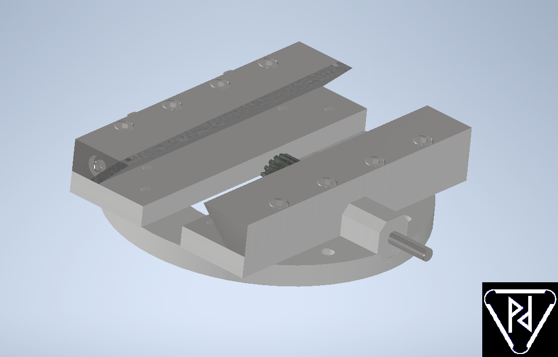

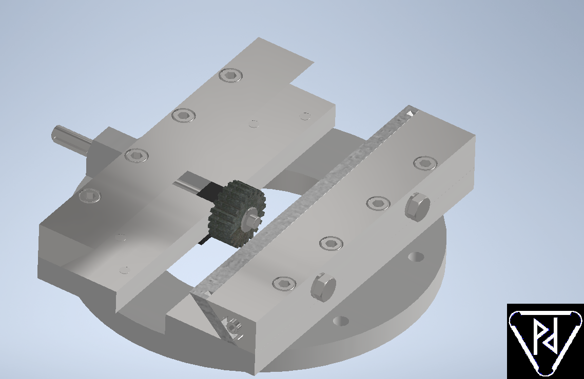

    Turret assembly.
    Milling machine - video-turret1.pngMilling machine - video-turret2.pngMilling machine - video-turret3.png
    Main body of my machine will be made mostly from HEB 280 [mm]

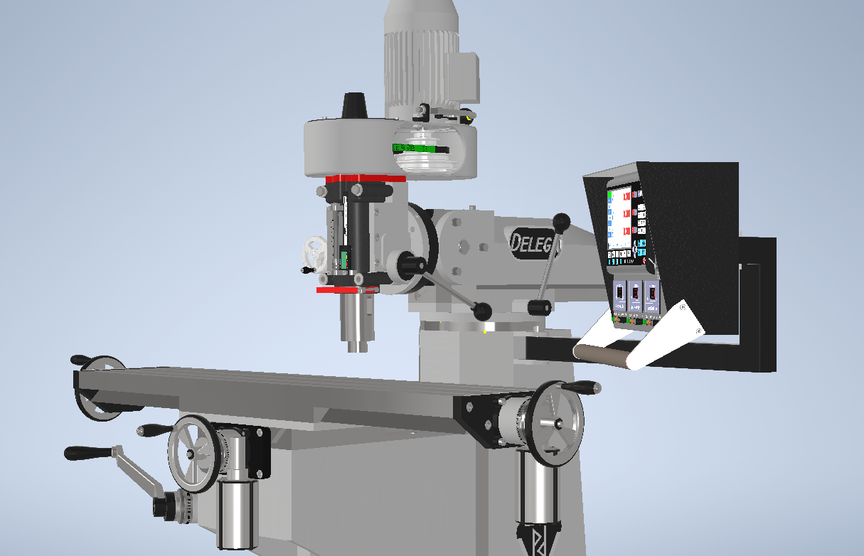

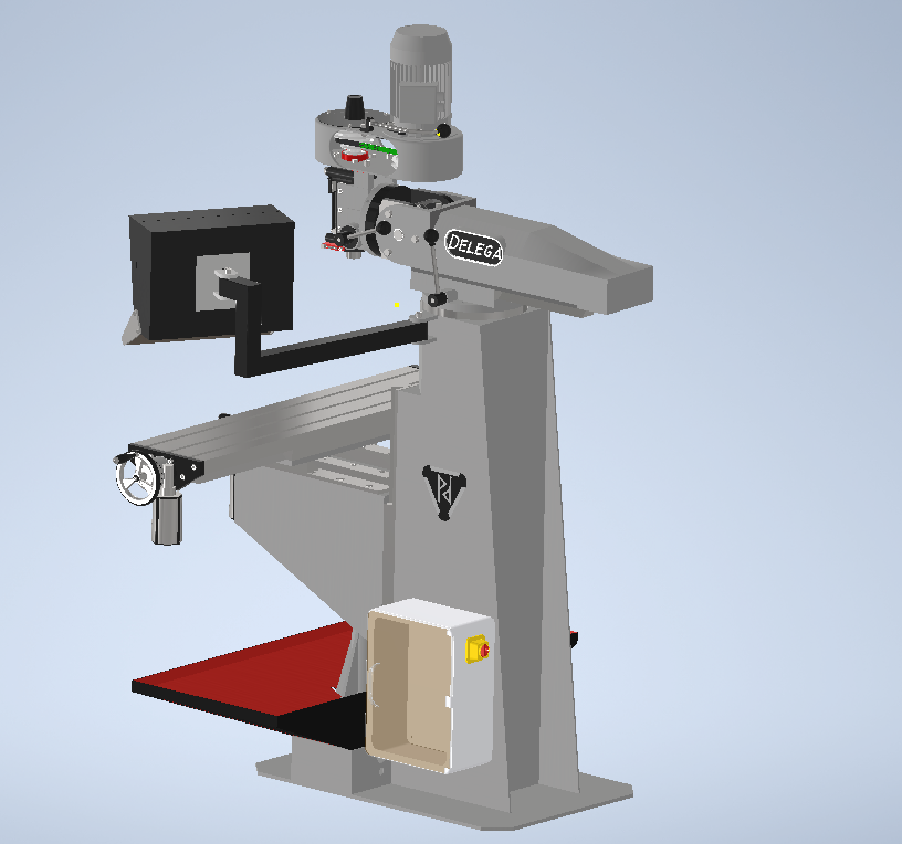

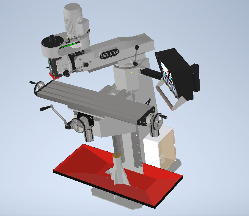

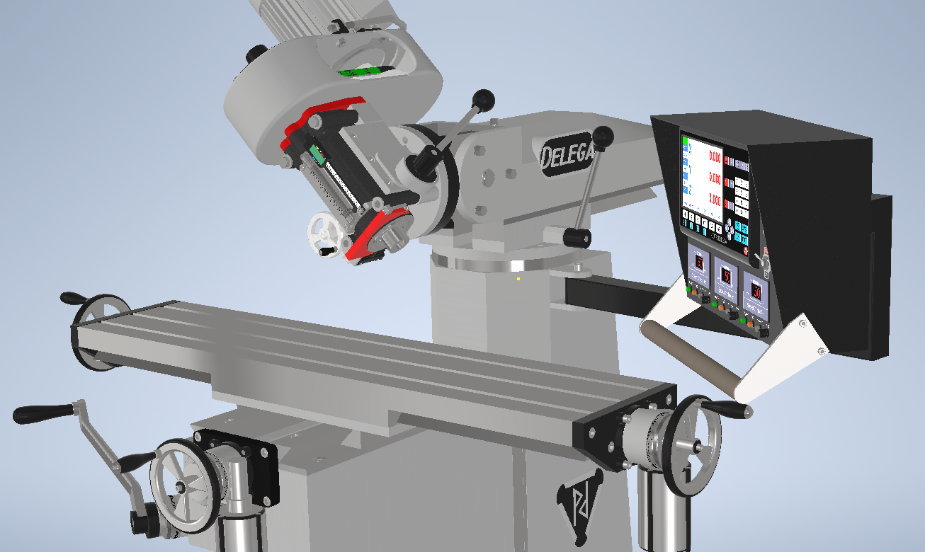

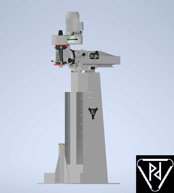

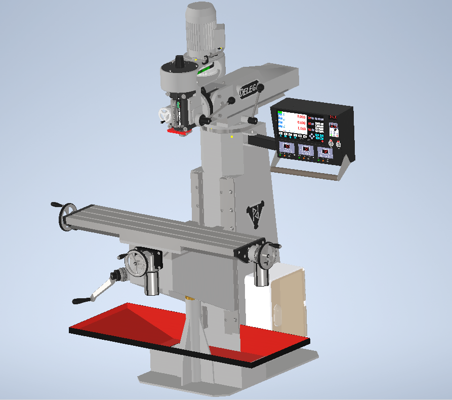

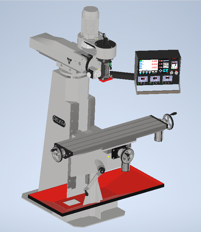

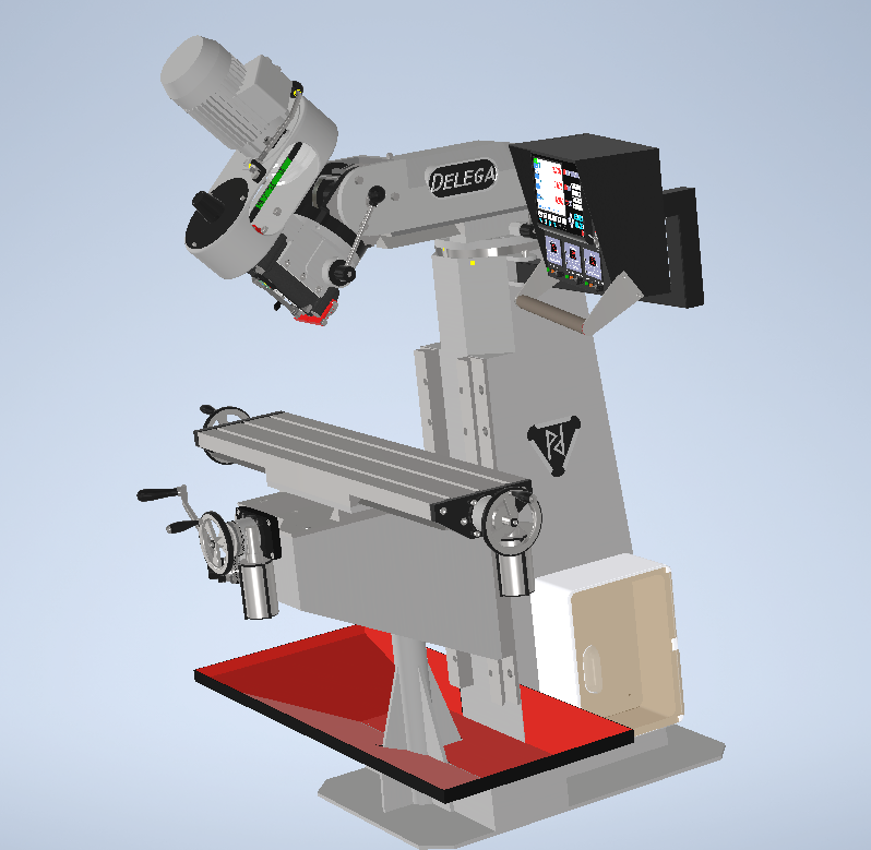

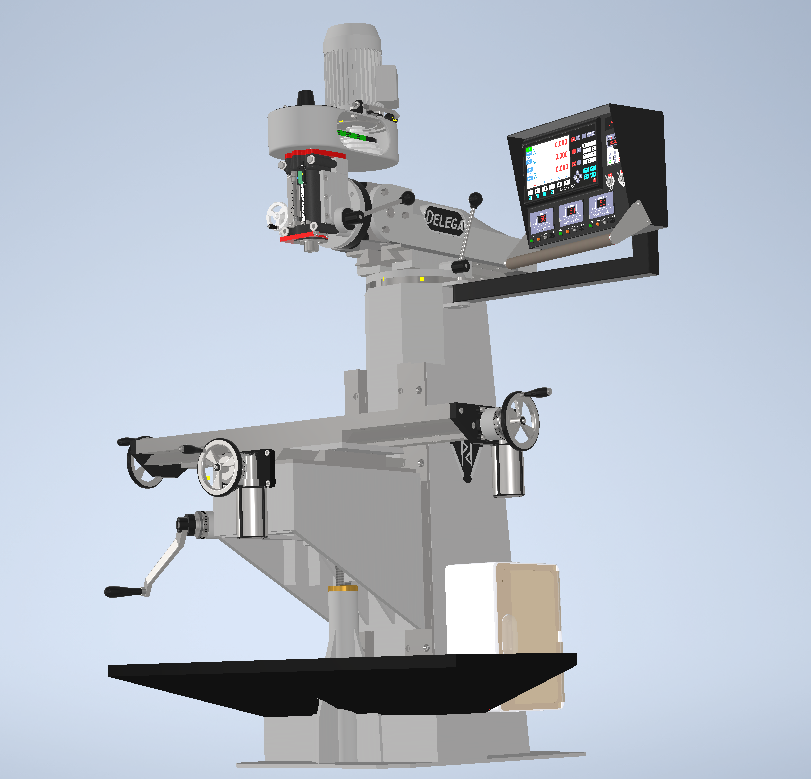

    3D Model is finished in 90%
    Some changes are possible because I still don't know what I will use for power feeds.
    I also included "extra" space for machine vise and collet chuck in Z axis travel.
    Milling machine - video-1.pngMilling machine - video-2.pngMilling machine - video-3.pngMilling machine - video-4.pngMilling machine - video-5.pngMilling machine - video-6.pngMilling machine - video-7.pngMilling machine - video-8.png

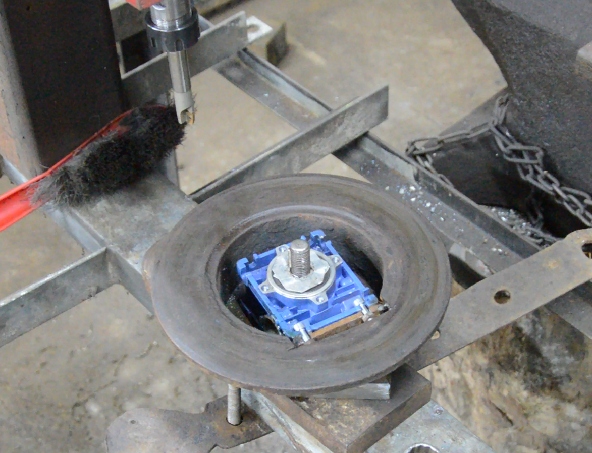

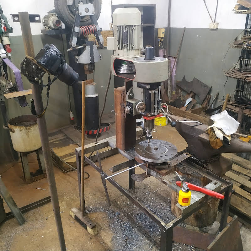

    I am making a flange for turret out of 20 [mm] thick steel plate. Diameter is 280 [mm].
    Specially for this task I attached 1:80 ratio worm gear (I bought it couple months ago and never used) to brake disc and rotary table was ready. As a temporary solution works well but this is not how It supossed to be.

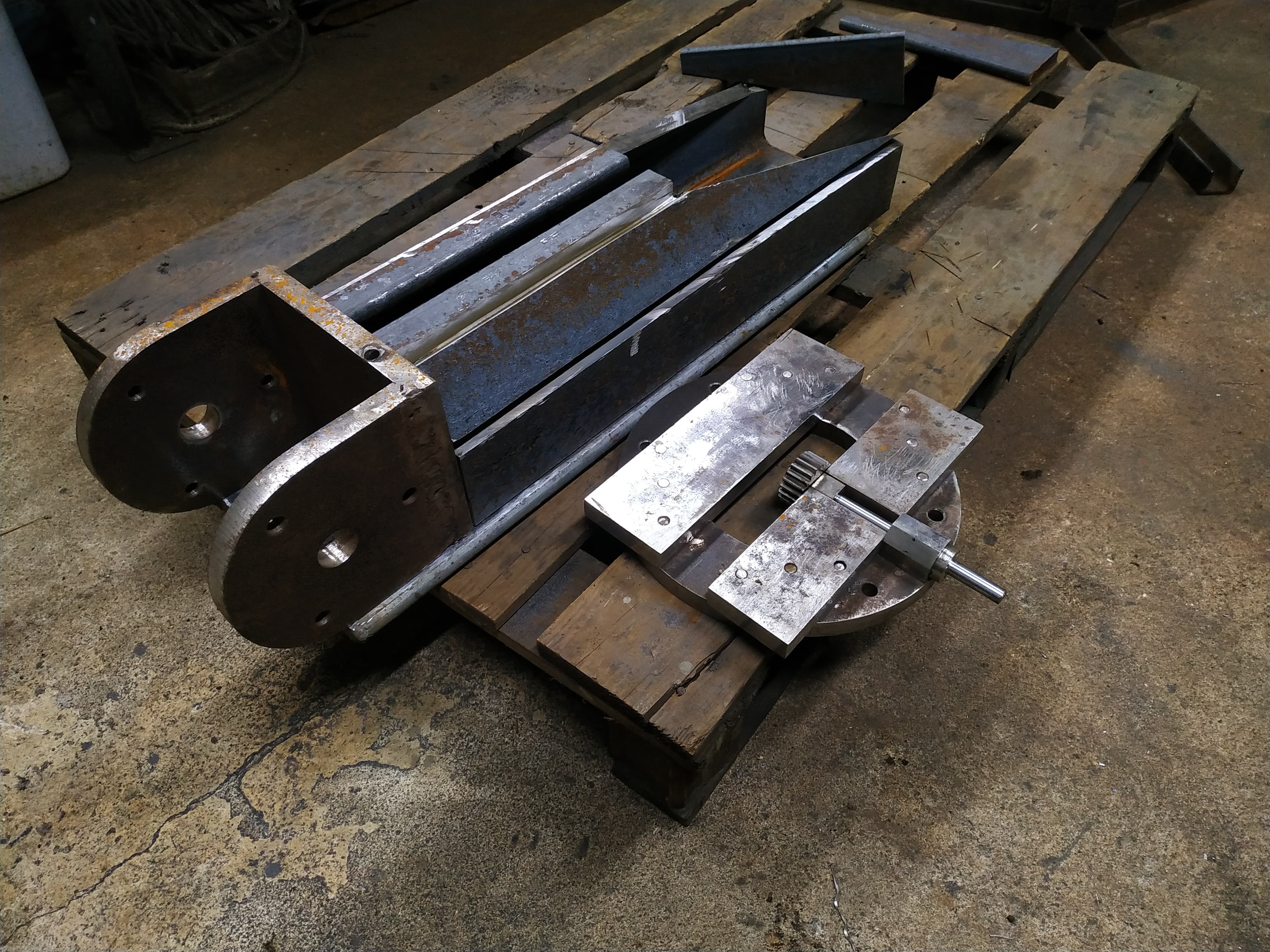

    Ram is ready for welding. Body of ram is made from 17 [mm] thick 180x180 [mm] angle iron. Turret is almost ready, only thing missin are dove tail guides.

    Now you will have great ability to use the mill head, but less rigidity.

    Quote Originally Posted by mwmkravchenko View Post
    It will be much more rigid that current setup. Now I have to figure out how to cut dove tail guides. New video will be uploaded in the end of this week.
