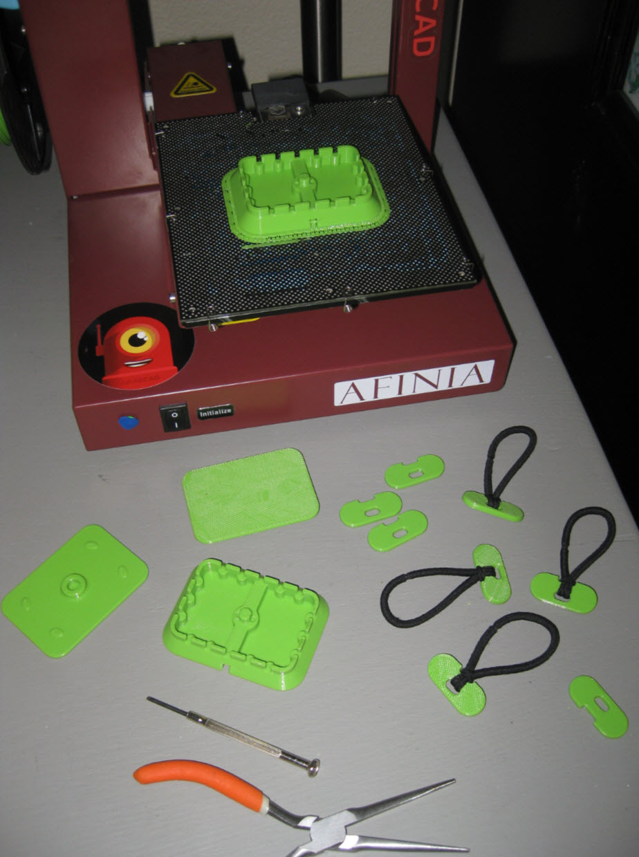

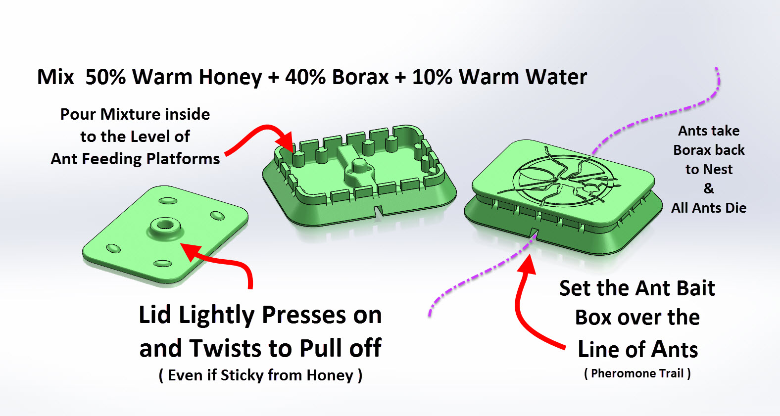

    So 3 Years ago 3D-Printed up Borax & Honey Ant Bait Boxes ...
    Changed the design today to make it easier to remove the lids when they get dry Honey on them ... and that is why I am posting this NEW version.

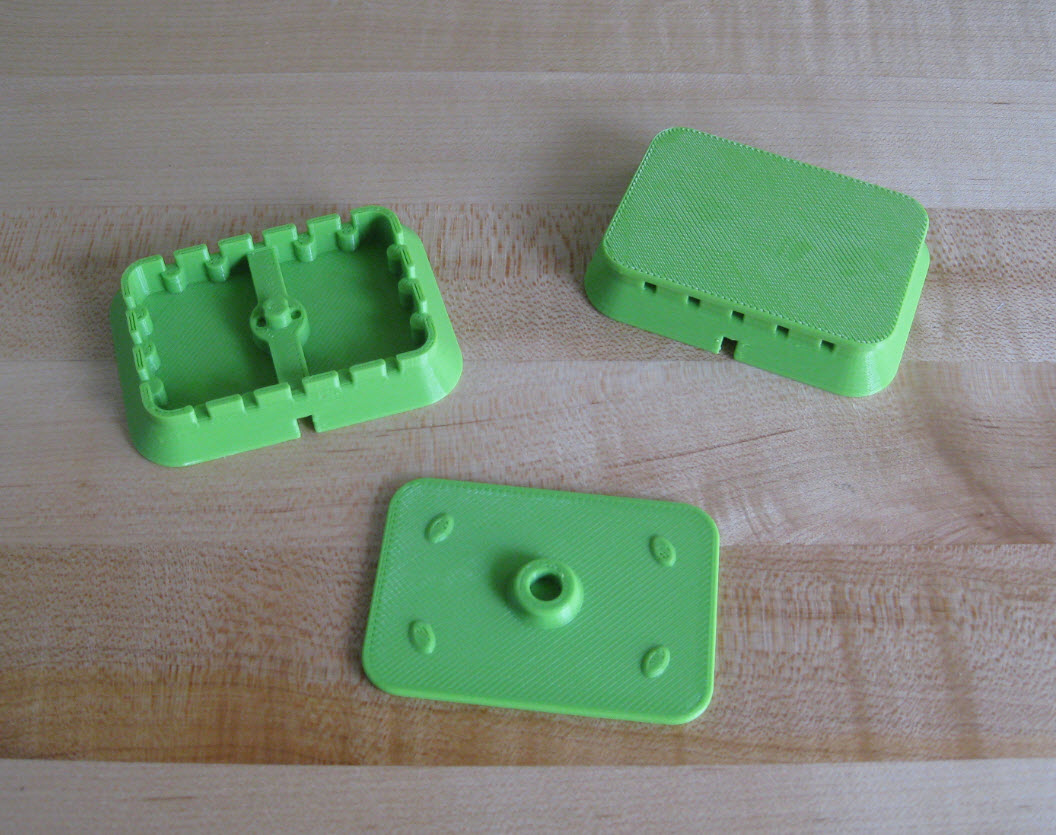

    Unfortunately, 3D-Printed items are not as strong as injection molded plastic; however, it seems each year the materials are getting stronger.

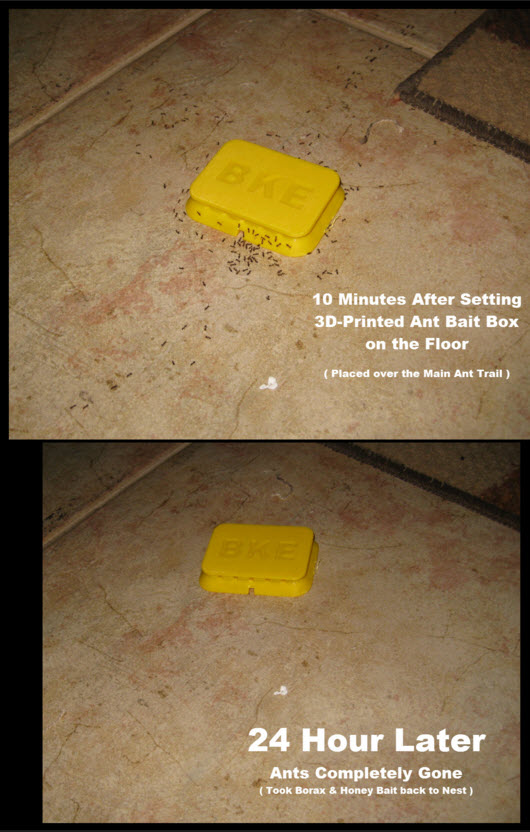

    For 3 years now, after 24 hours of the ants eating the honey with Borax in it and then taking it back to their nest ...
    The next day no more ants for the rest of the year

    Changed the design this year to make the Lids easier to remove:
