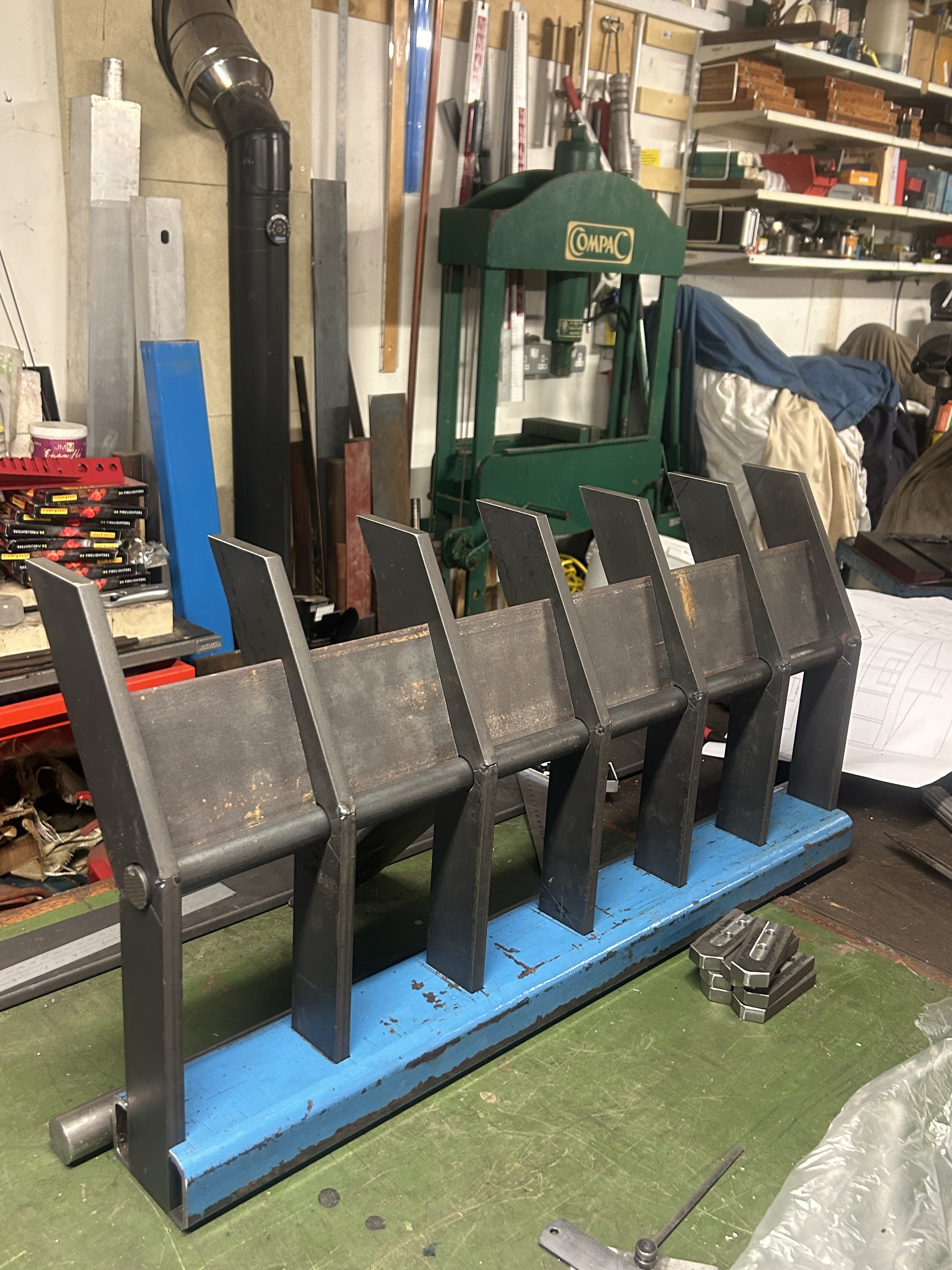

Attachment 48055The 90mm x 50mm rectangle section (painted blue) was from a skip dive a few months back all other materials purchased.

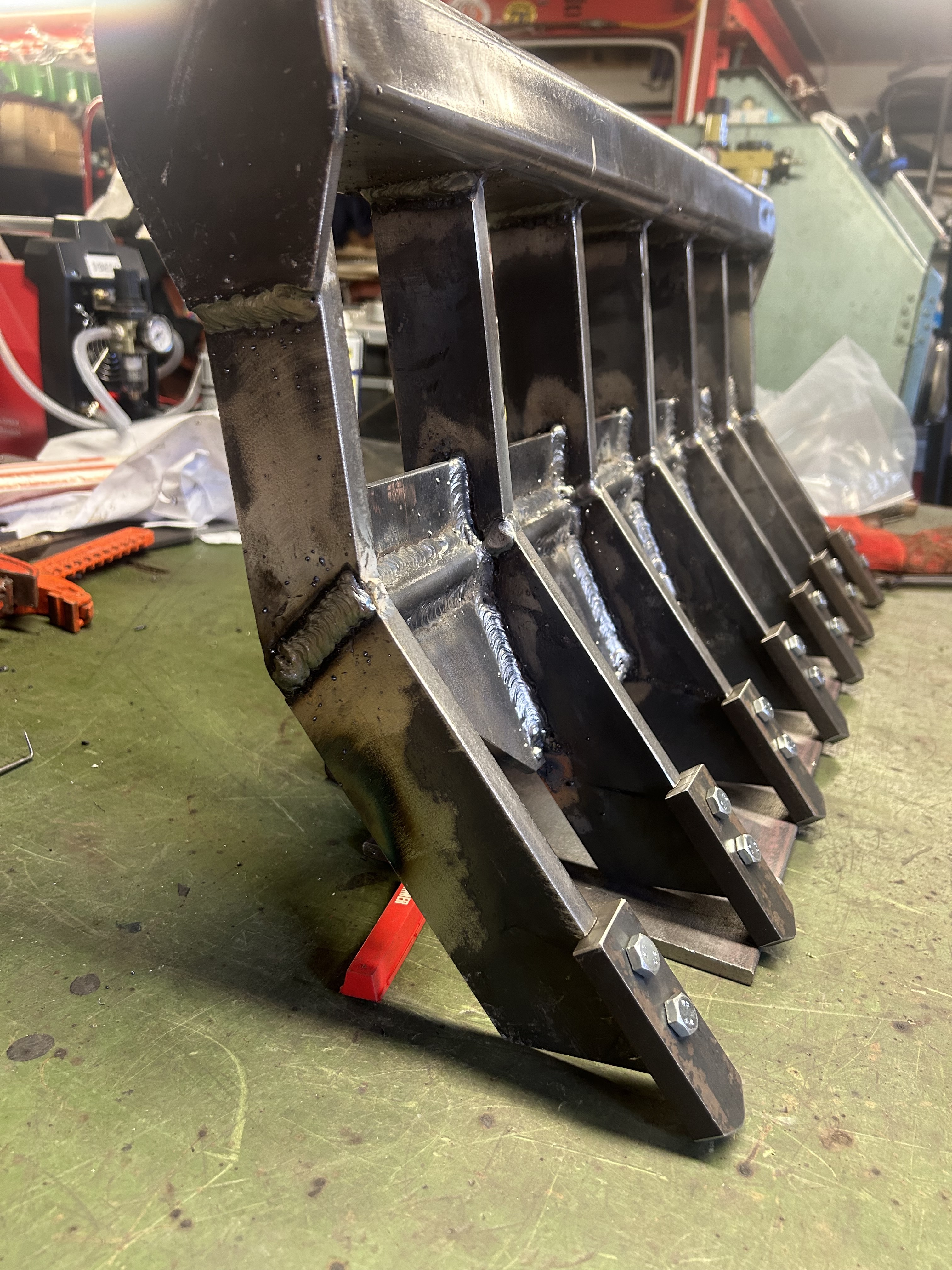

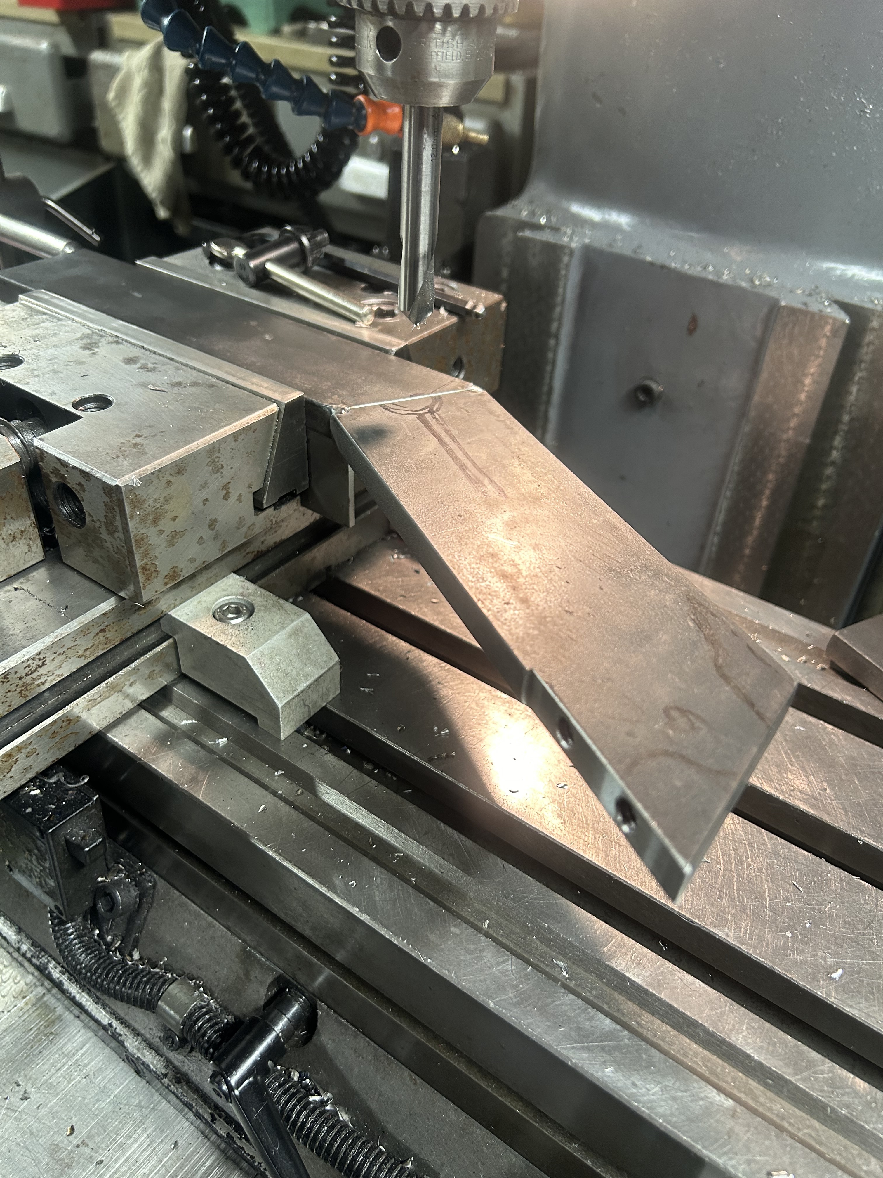

Attachment 48056The tines were cut from 12mm thick material and tack welded then drilled to accept the 25mm diameter steel spine.

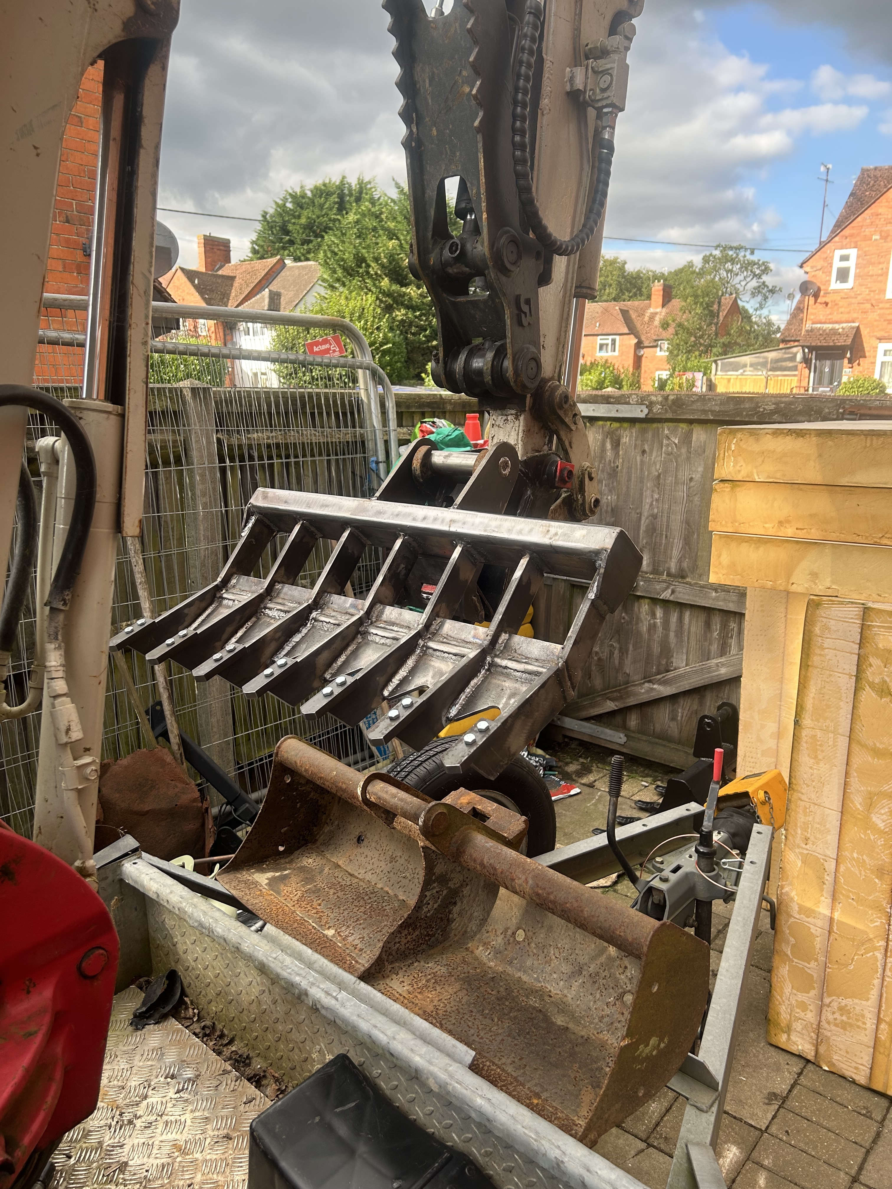

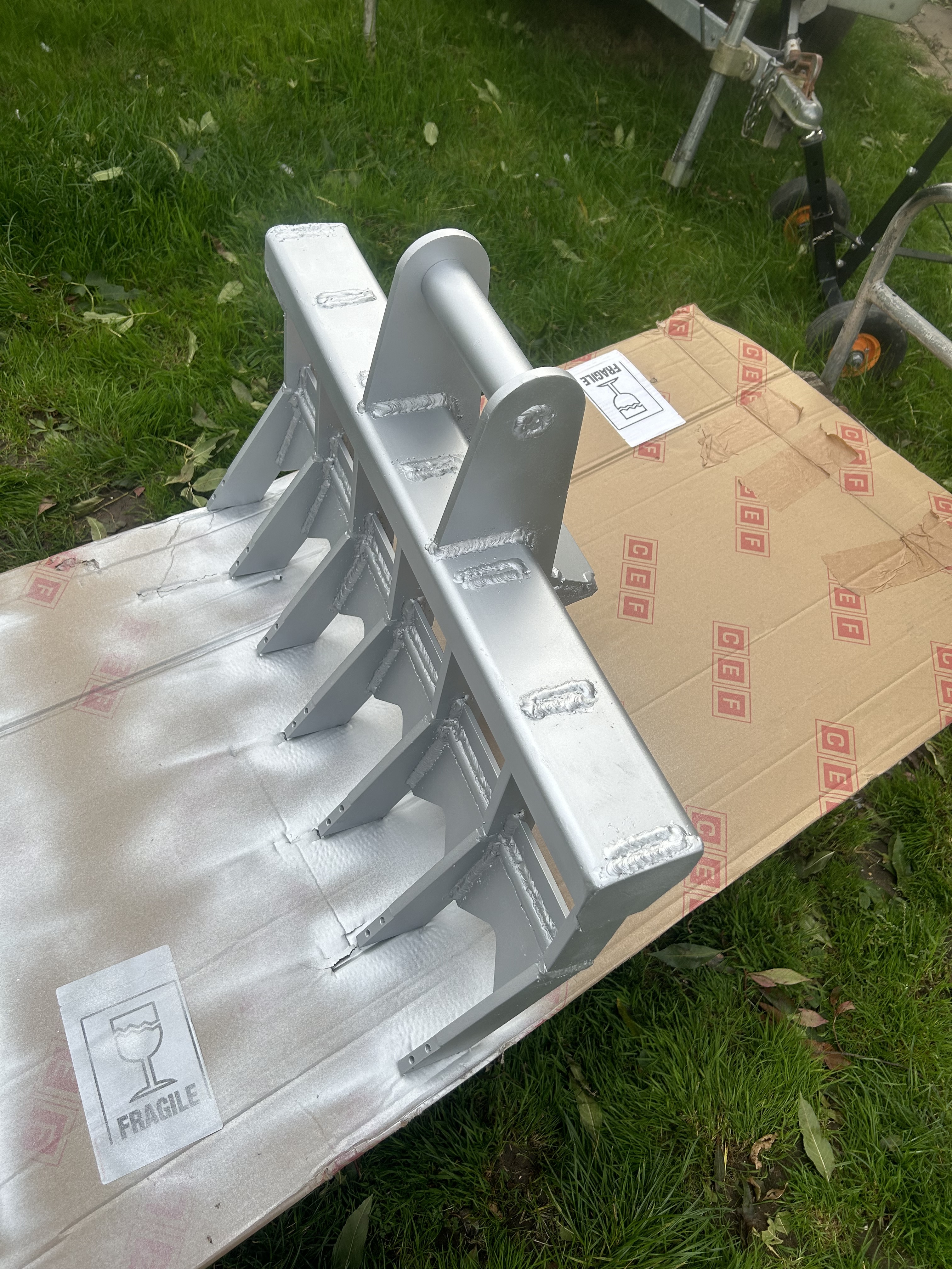

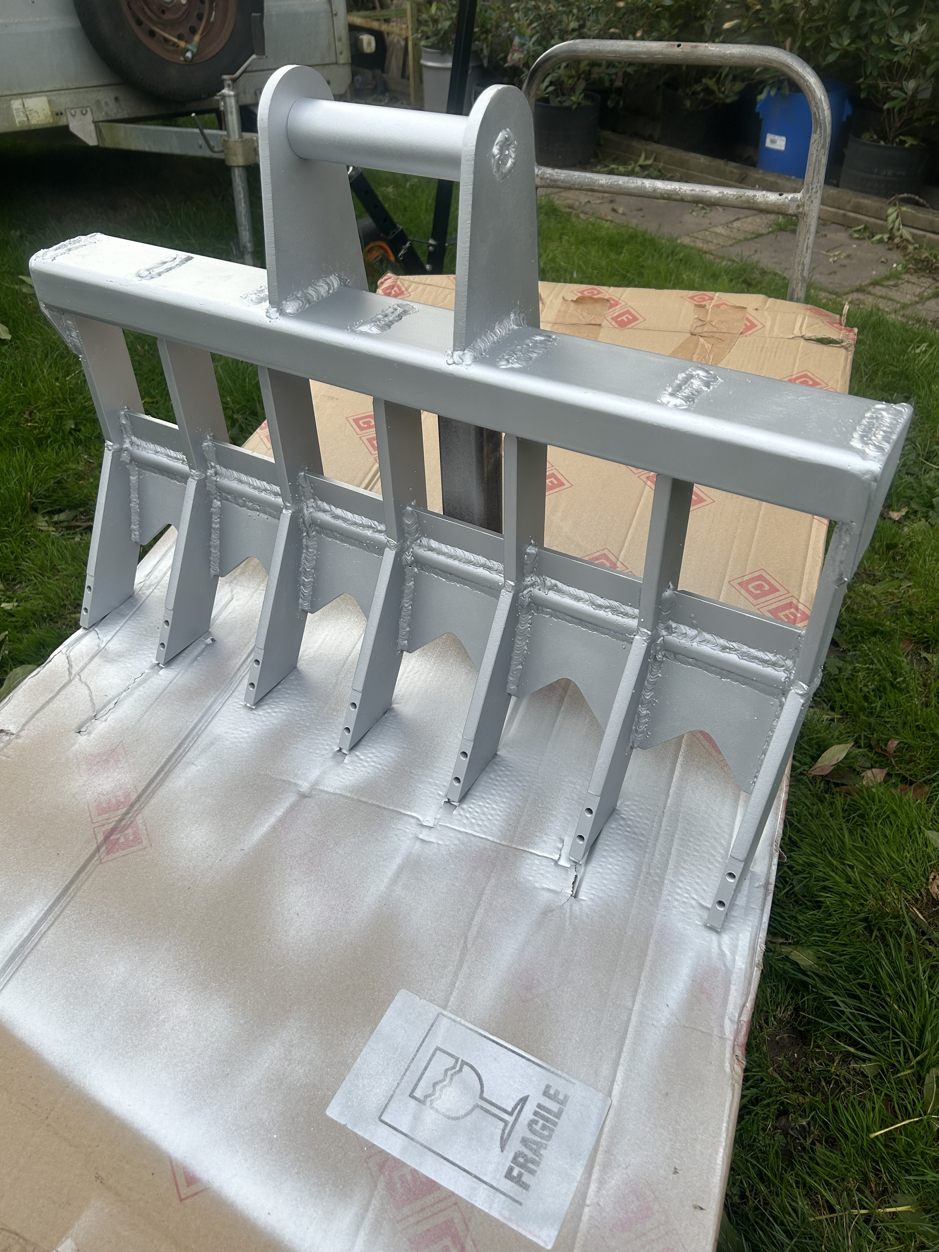

Attachment 48058Rake fully welded and replaceable teeth bolted in position to check fit. The webs are made from 6mm thick material.

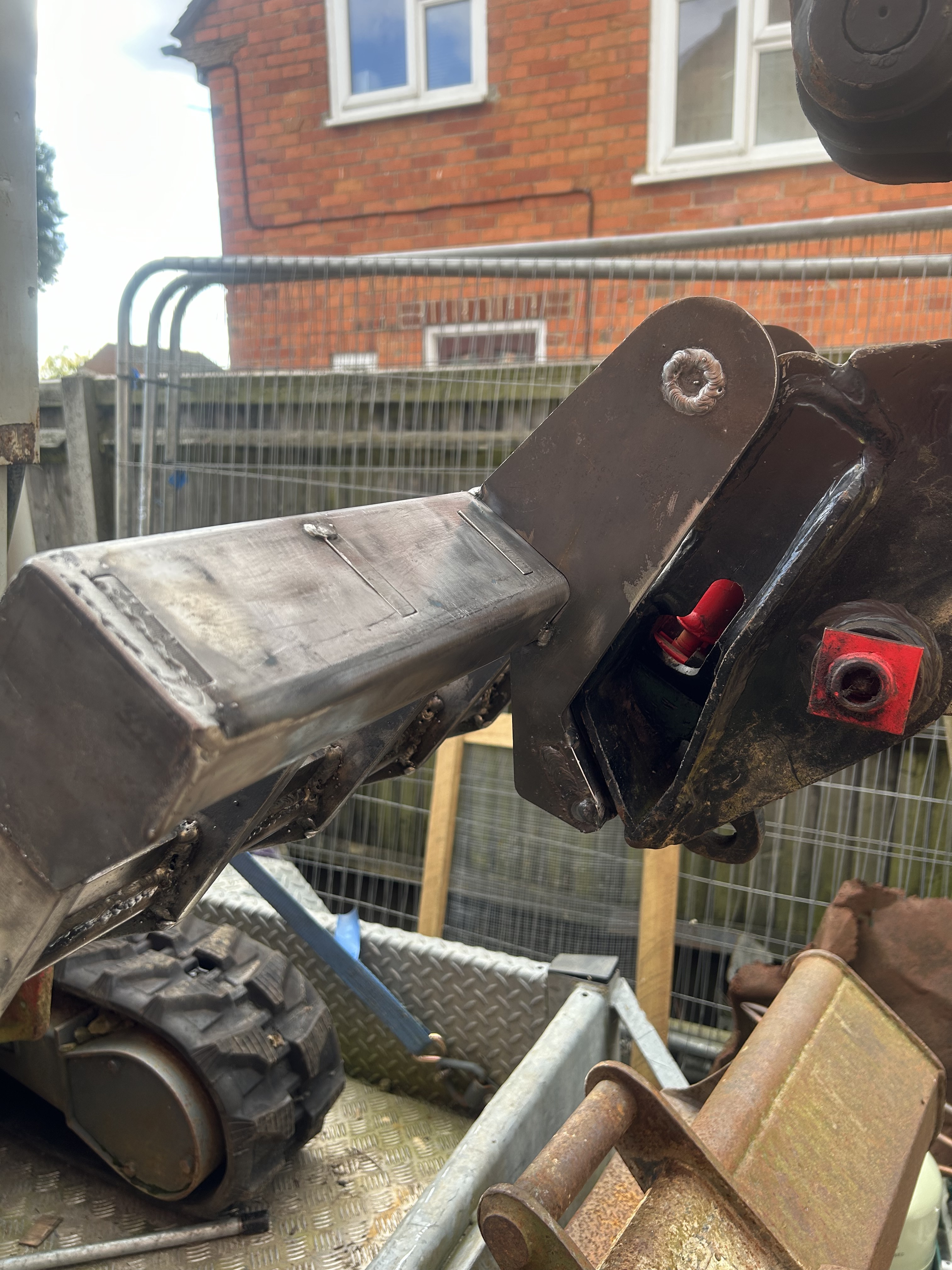

Attachment 48057Harford hitch tack welded to check fit on digger.
Attachment 48059Rake locked in position on hitch.

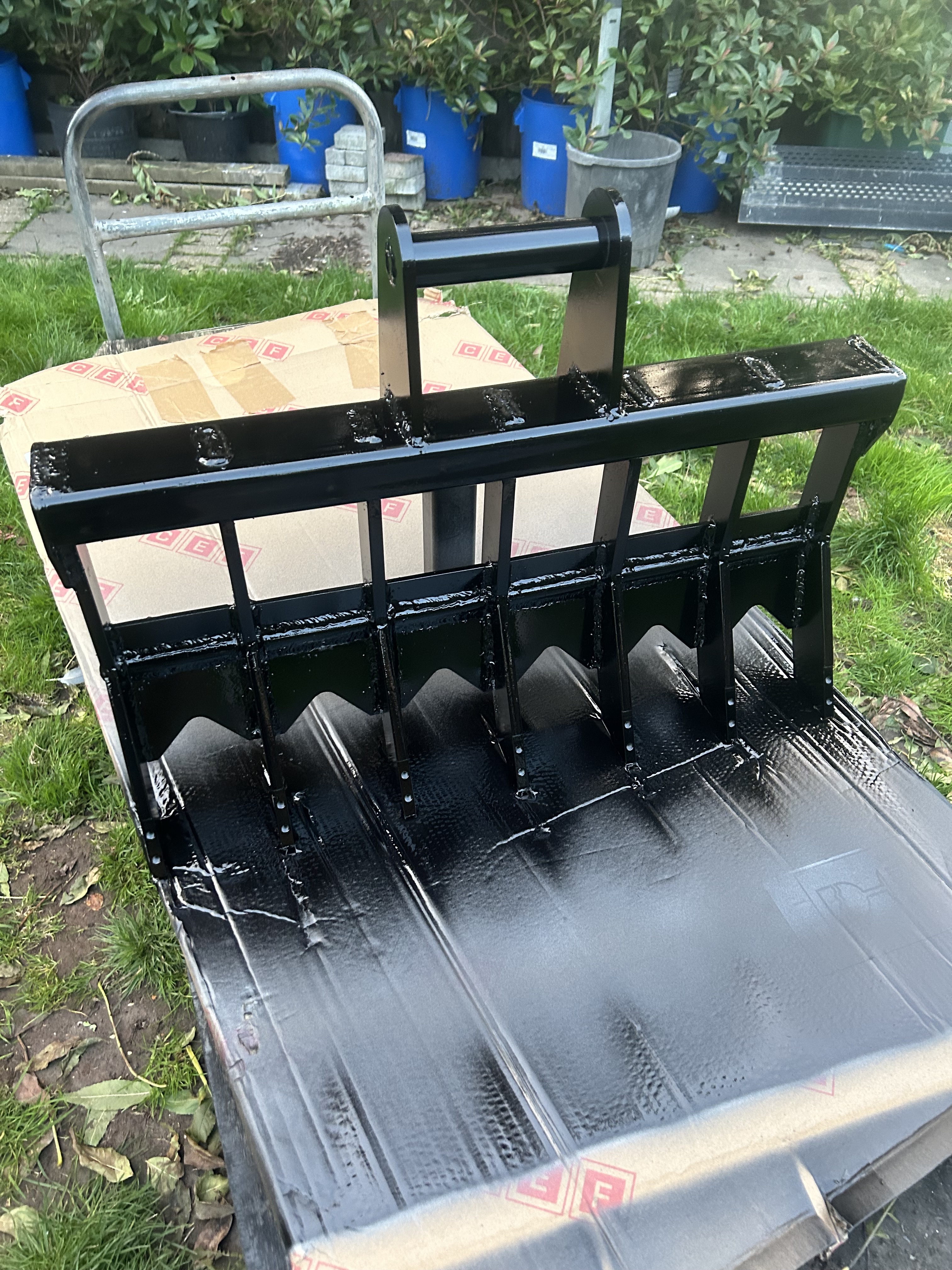

Attachment 48060 Attachment 48061Coat of cold galvanised spray to add a bit of protection.

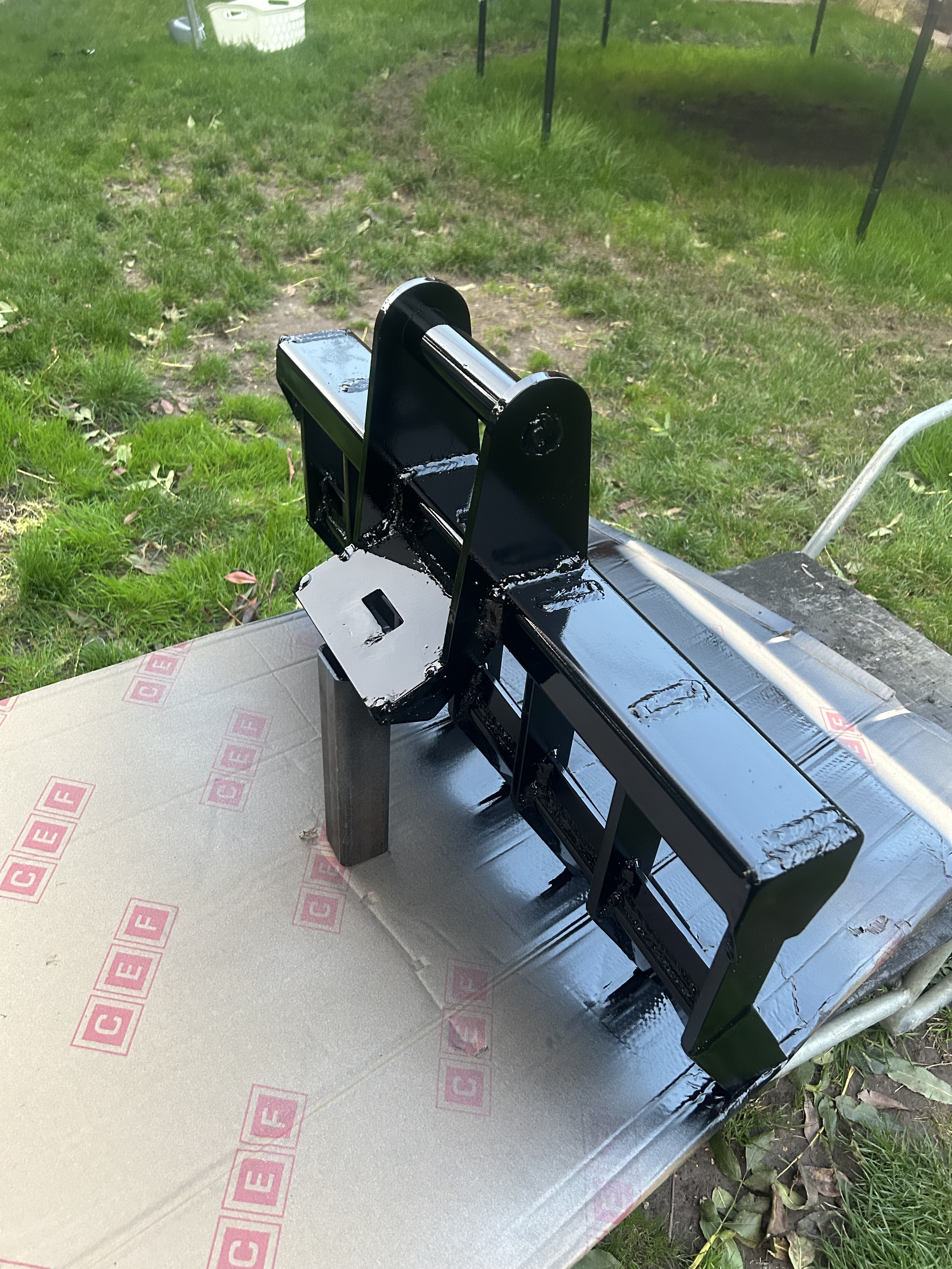

Attachment 48062 Attachment 48063A coat of black spray.

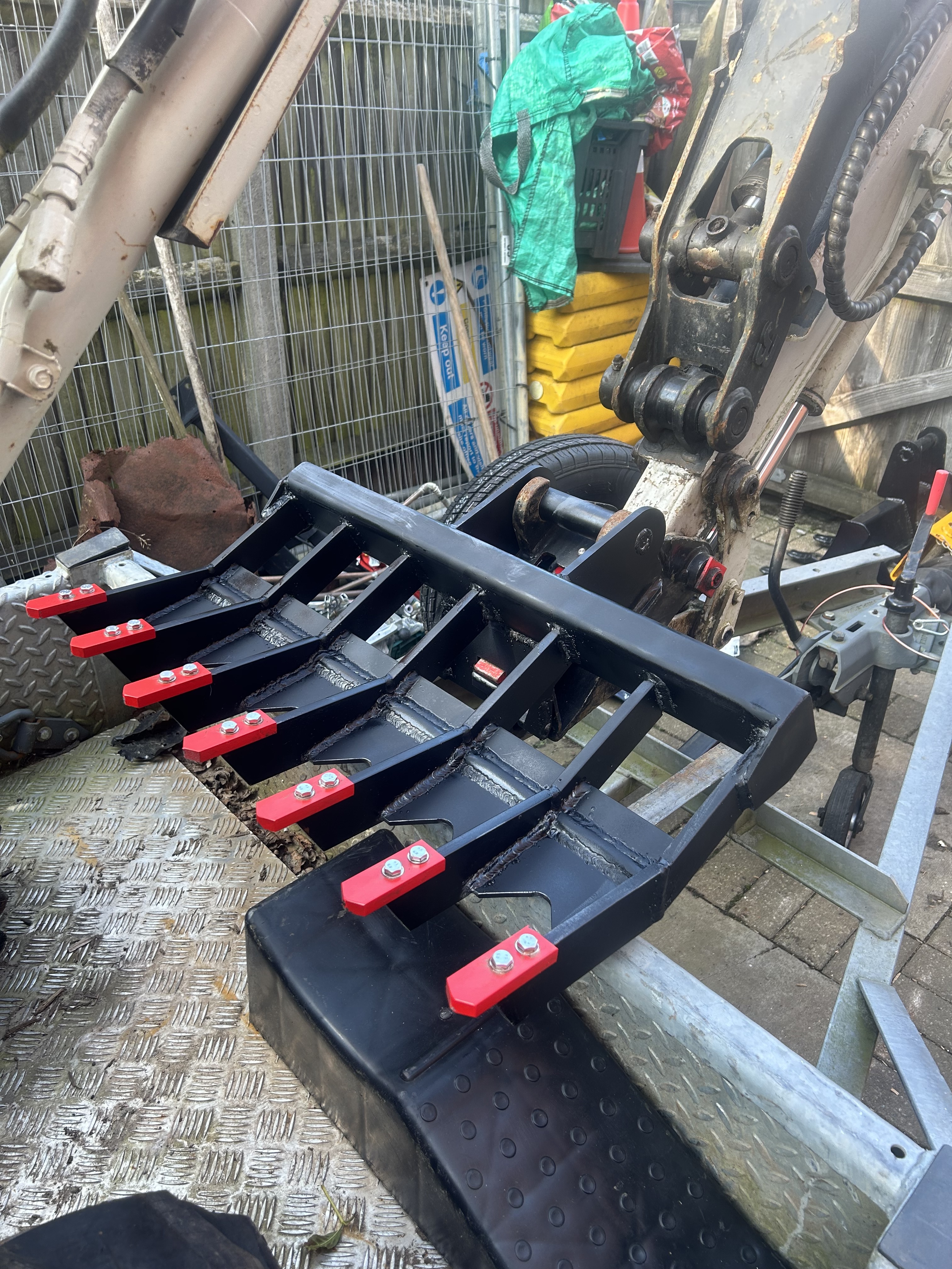

Attachment 48064Replaceable teeth ready to be fitted.
Attachment 48065Completed and ready to rough up the paint job.
