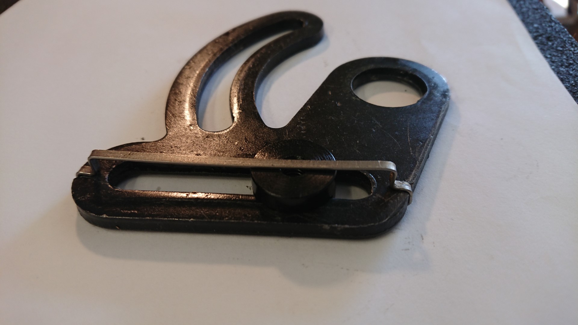

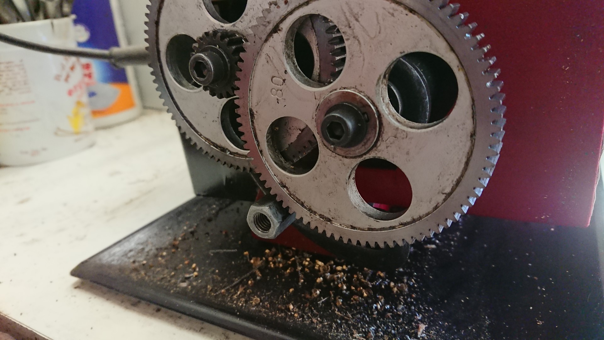

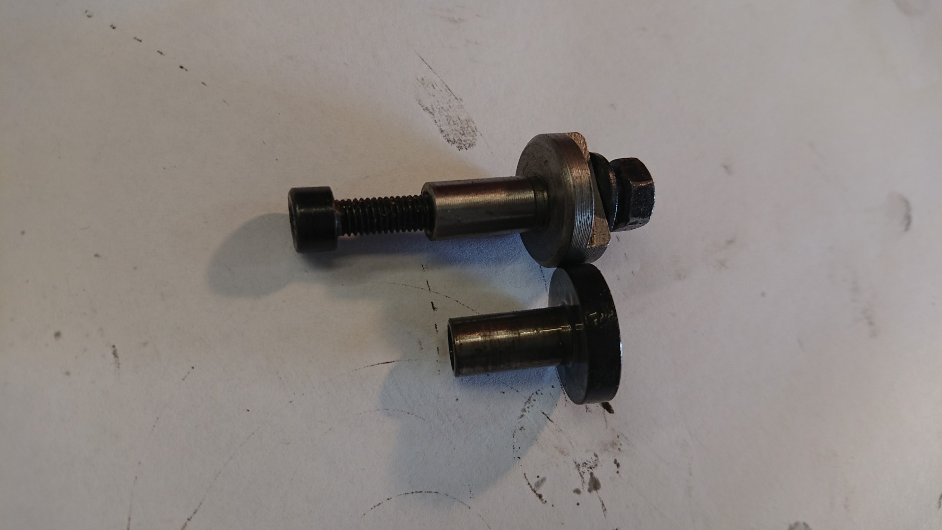

The Chinese mini lathe is often described like a kit you have to assemble, adjust and redesign properly. I have a Sieg C2.
The most annoying and ridiculous design fault is the gear change system. One has to be an ambidextrous contortionist to change gears on these things, so for those that aren't, here is my solution...

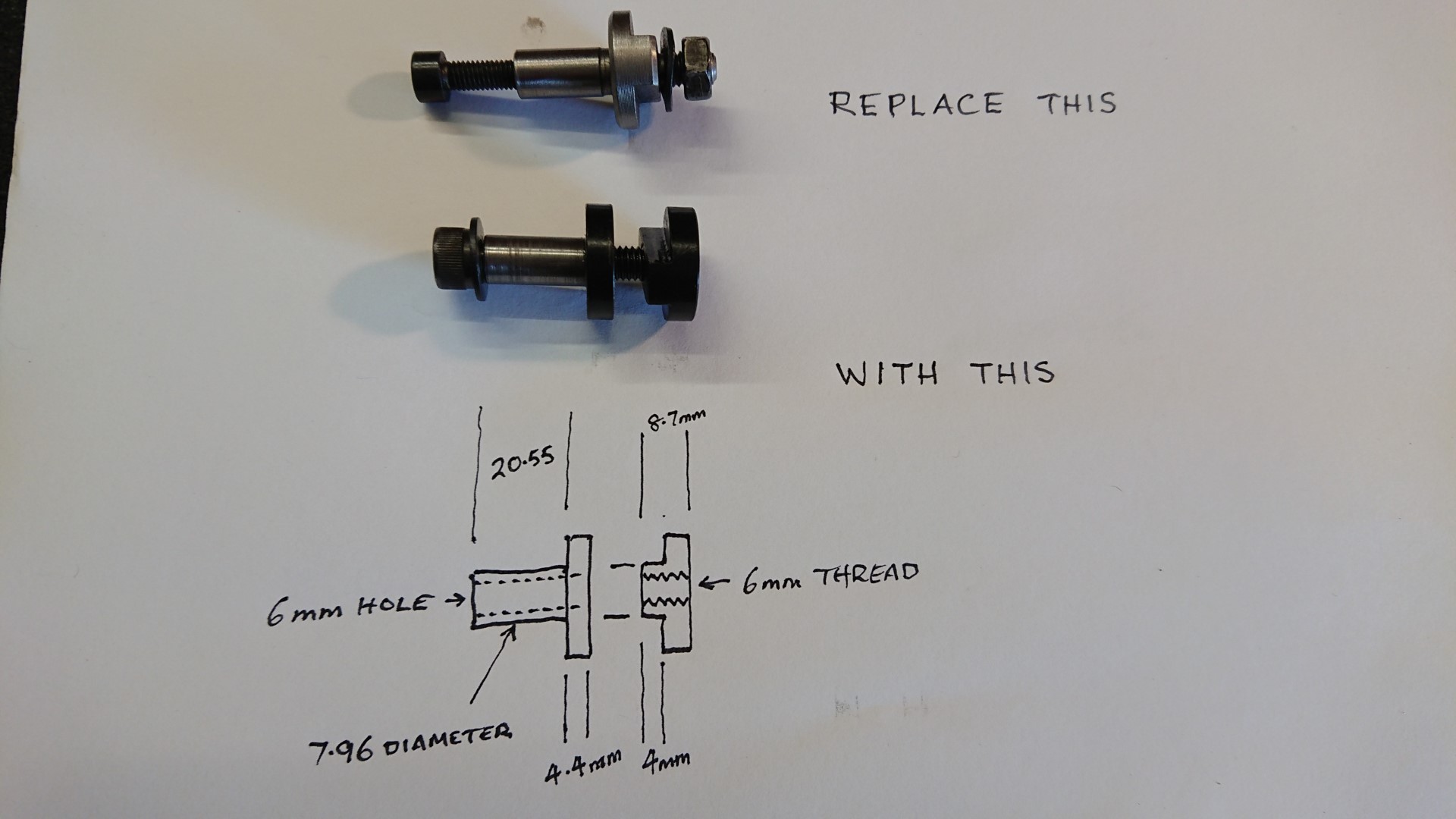

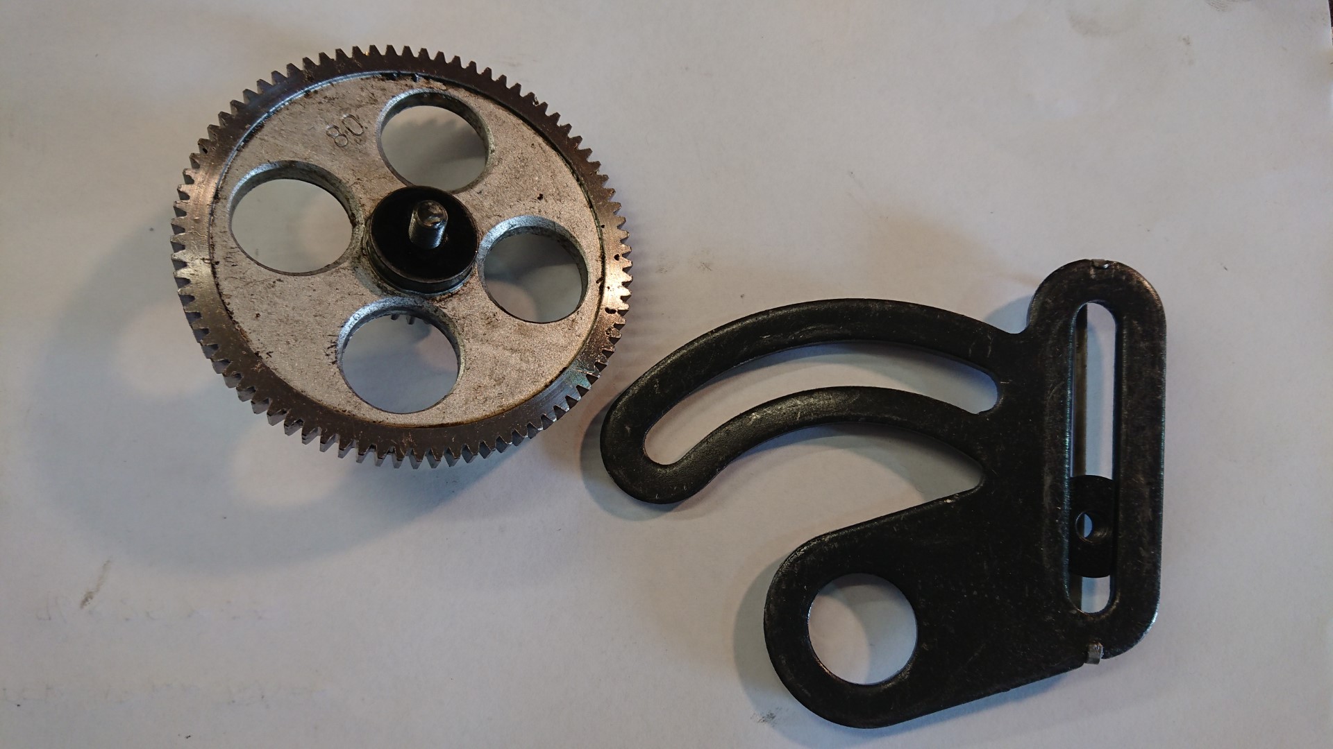

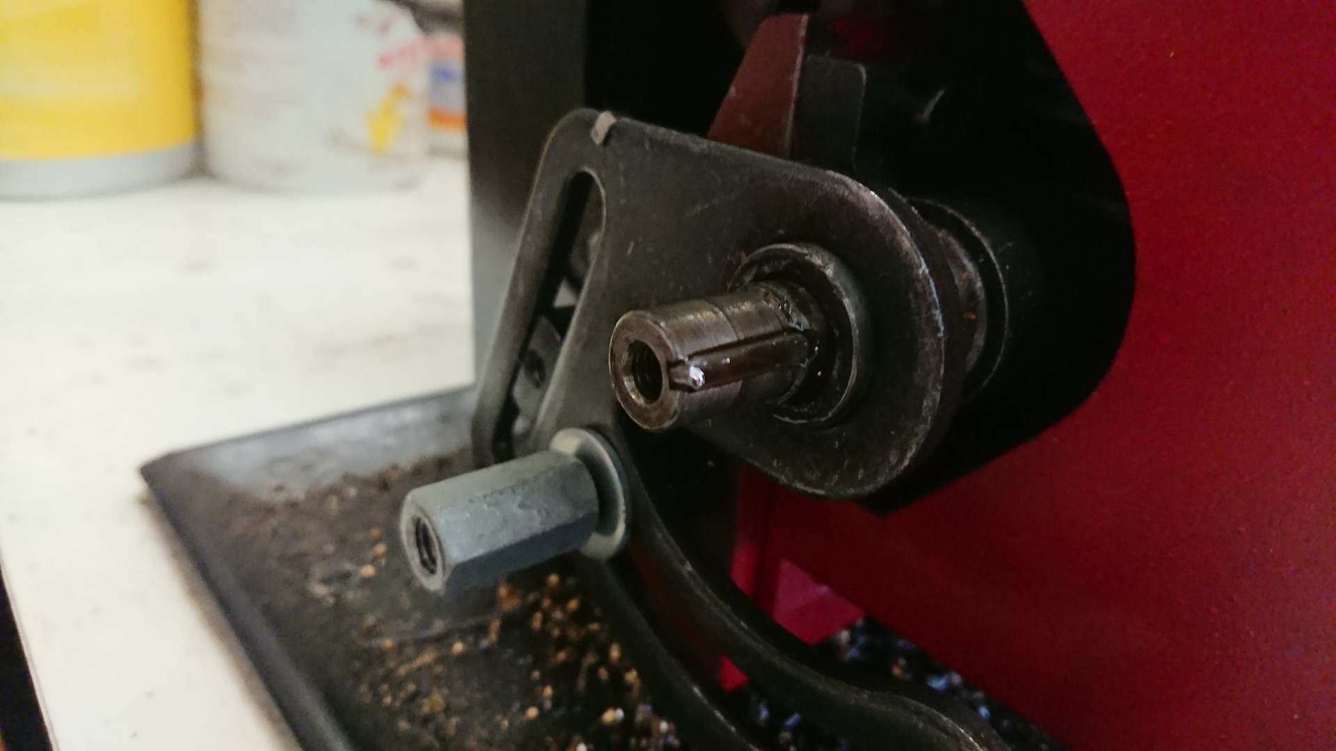

Firstly the bottom curved slide nut, replace with a joiner nut that clears the gear wheel or make one out of brass hex.
Attachment 24323
Attachment 24324

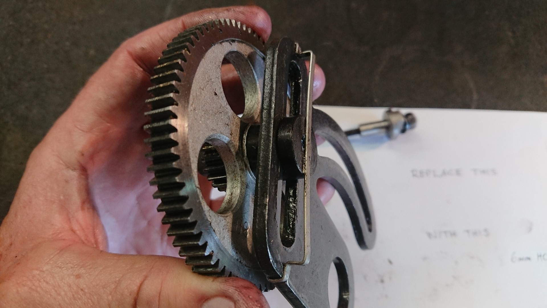

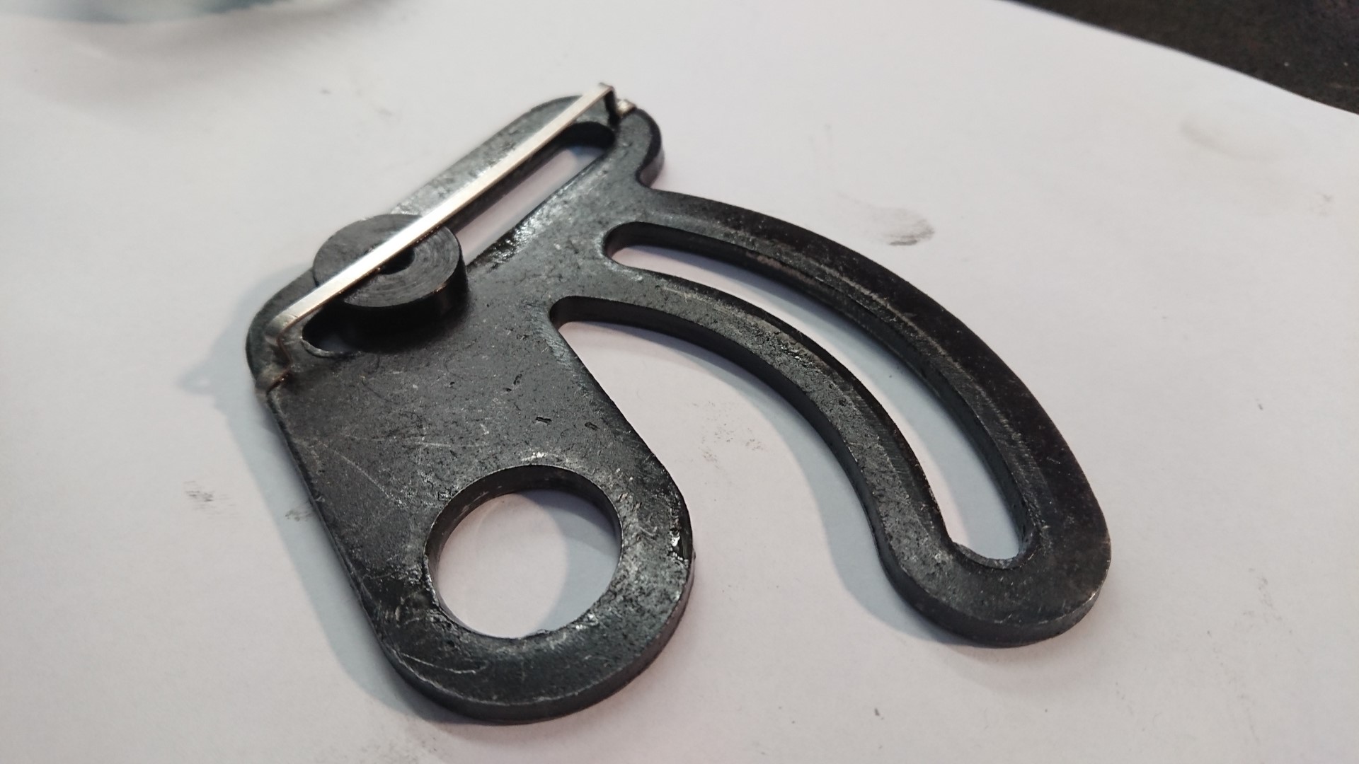

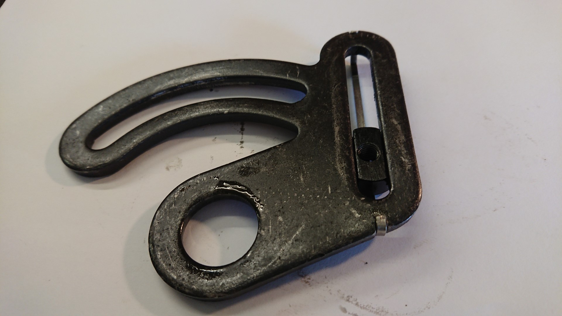

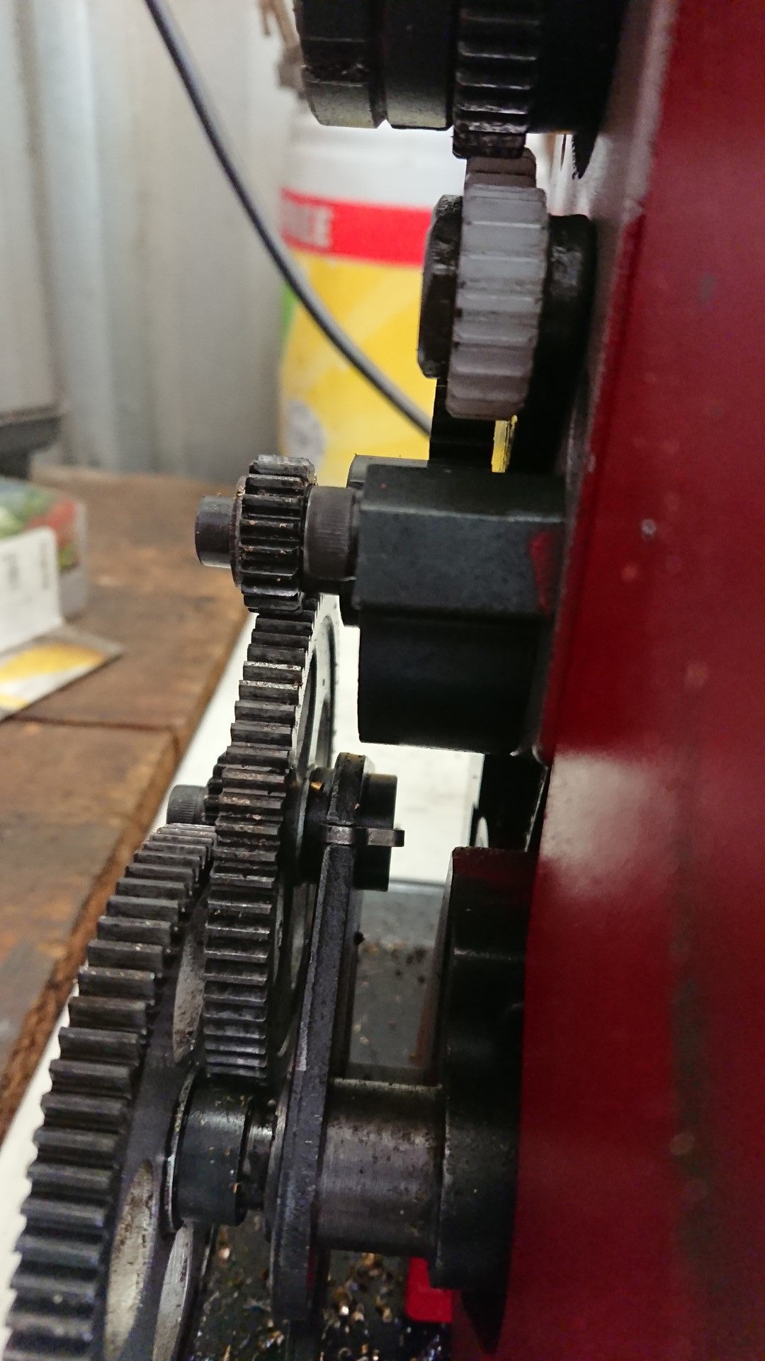

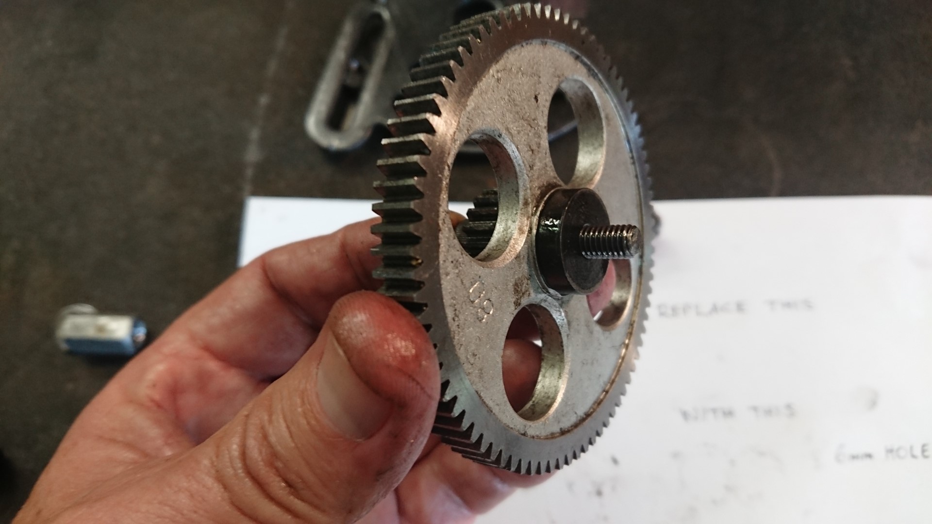

The straight slide is adjusted by an almost inaccessible nut which to loosen or tighten requires numerous re-positioning of spanner...Grr
This design allows tightening of gear and position simultaneously.
Attachment 24325
(measurements will vary on different machines)
Attachment 24326
Attachment 24327
Attachment 24328
Attachment 24329

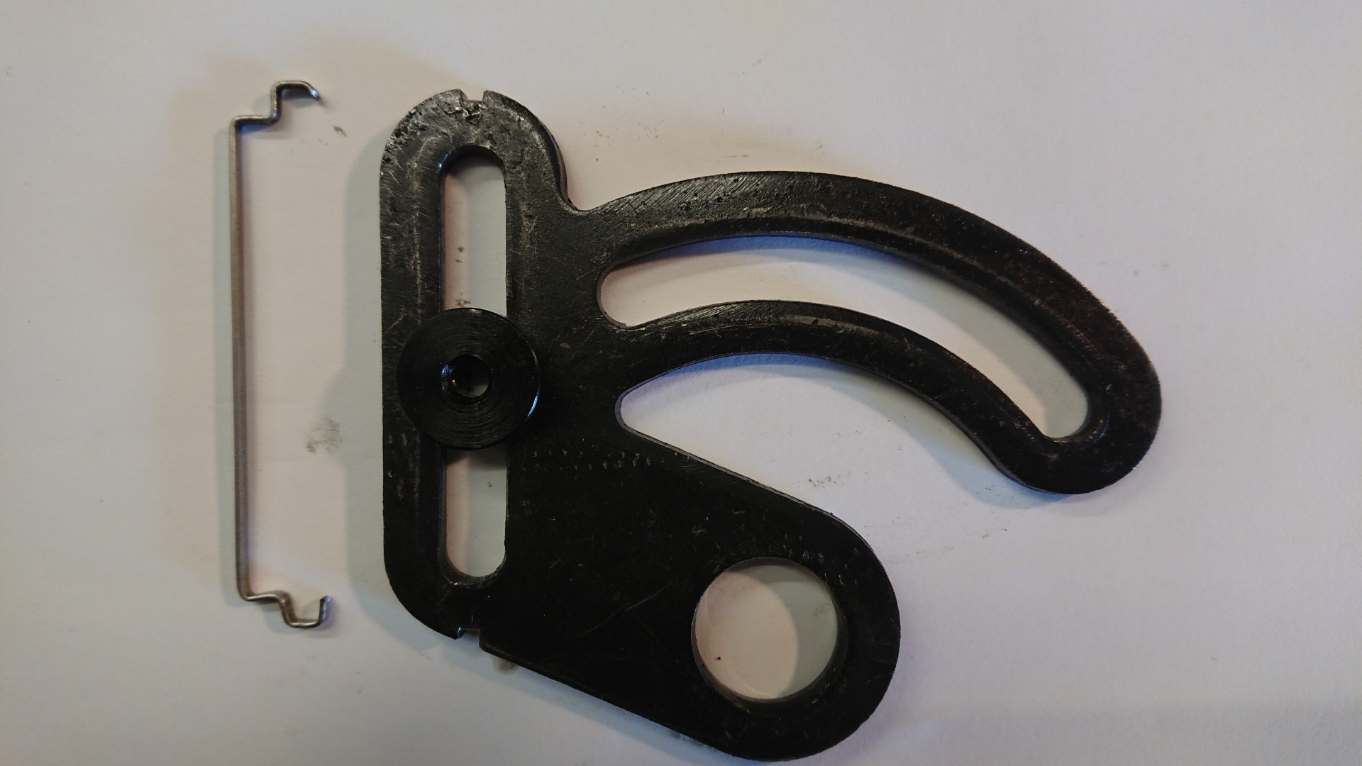

The clip spring is the spline from a car windscreen wiper blade, bit of bending and a couple of slots in bracket to hold in place.
