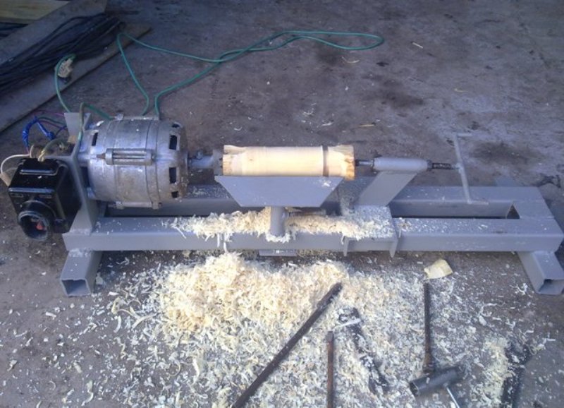

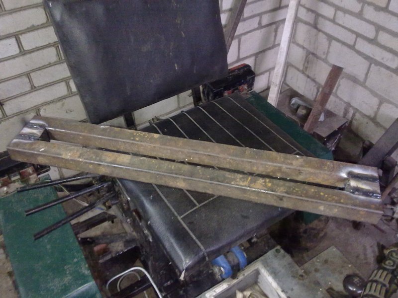

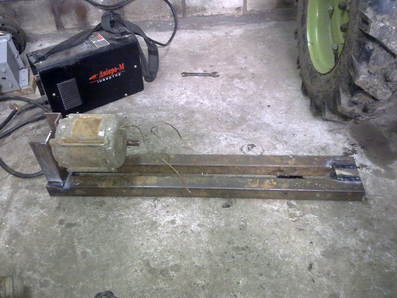

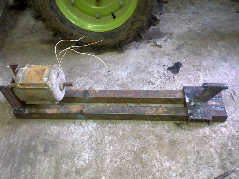

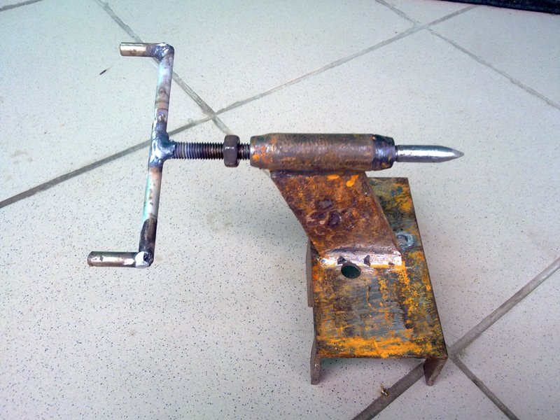

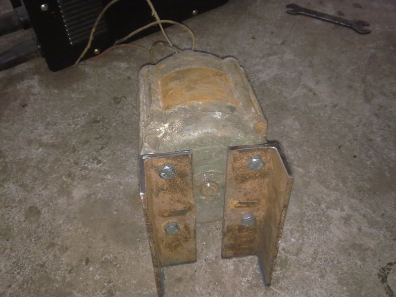

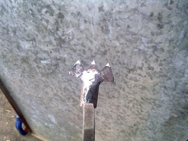

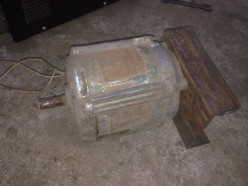

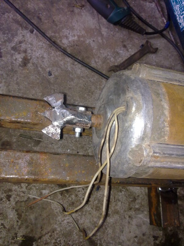

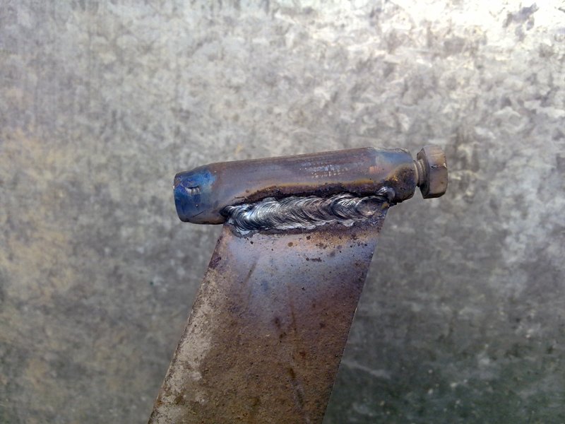

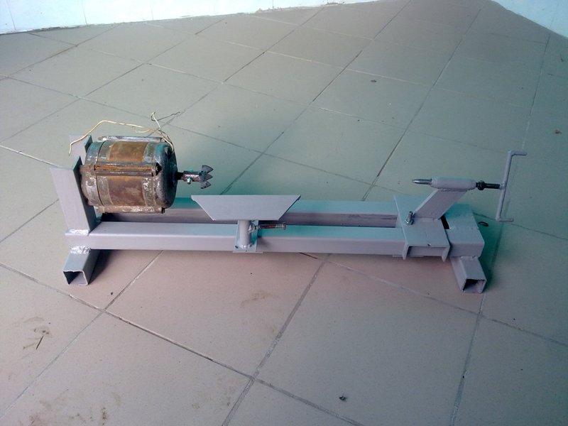

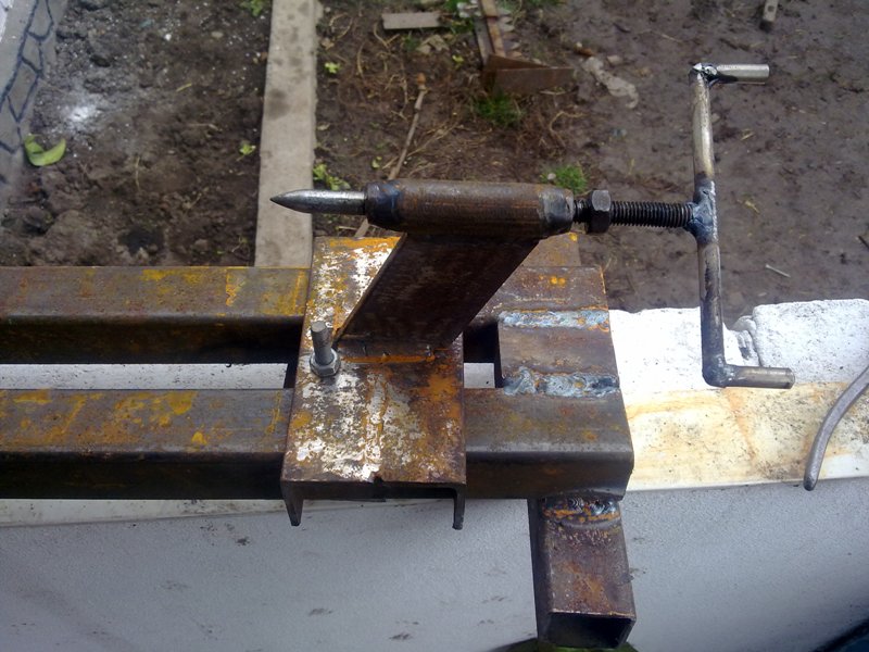

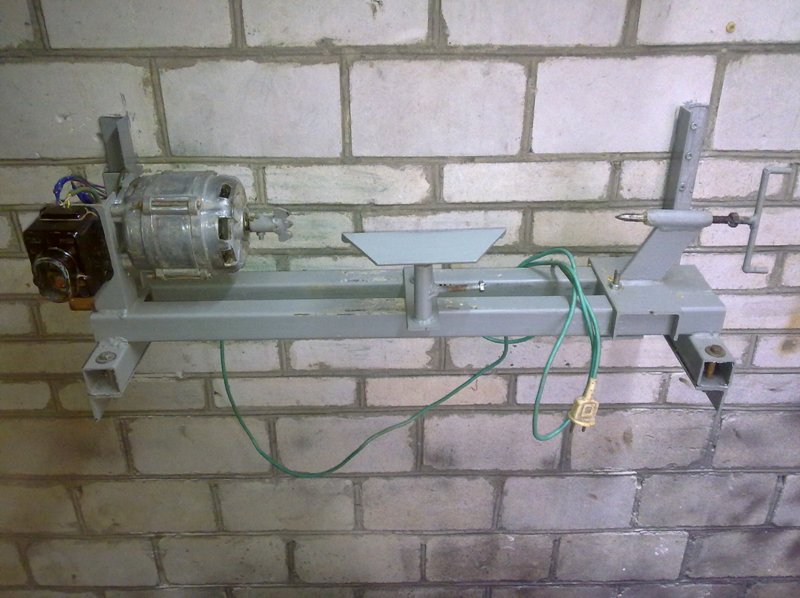

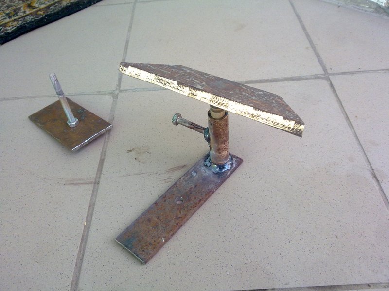

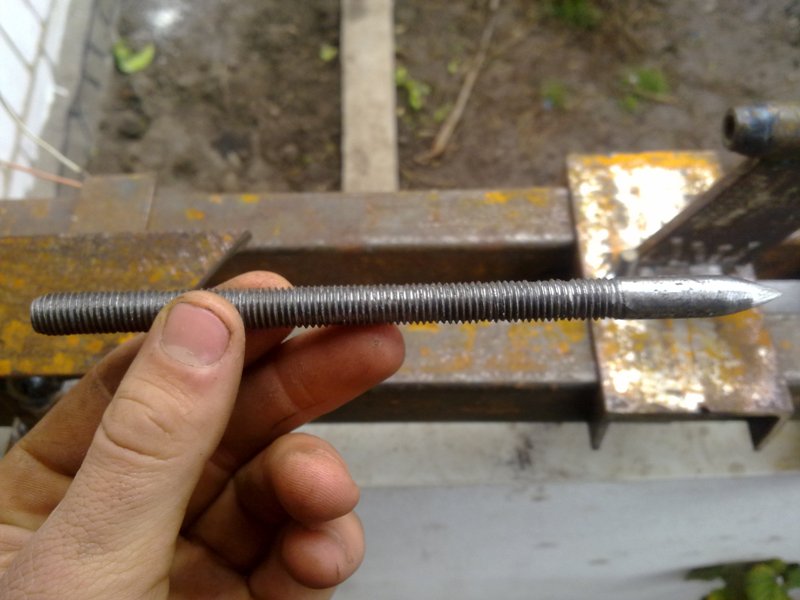

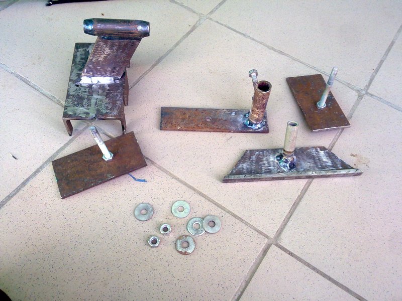

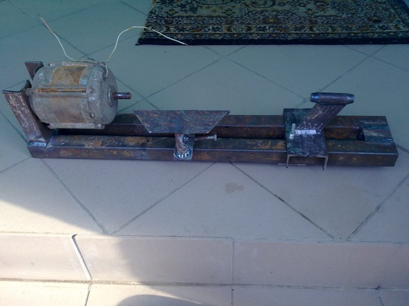

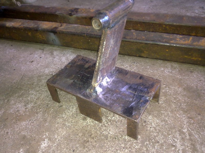

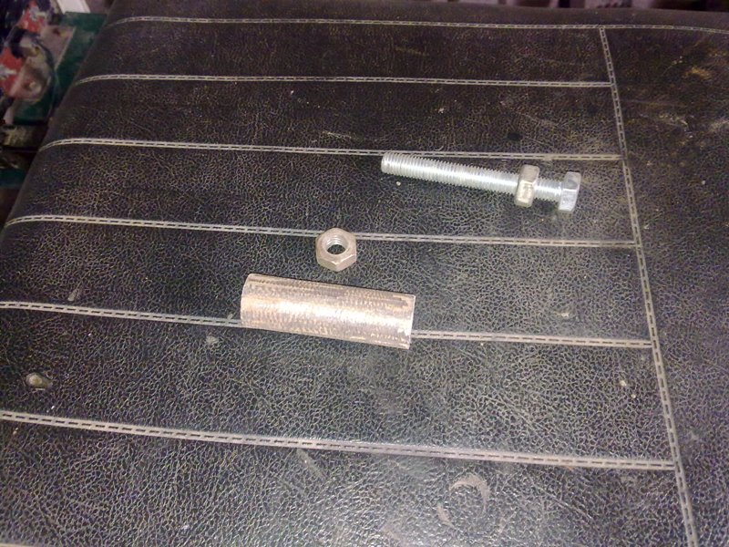

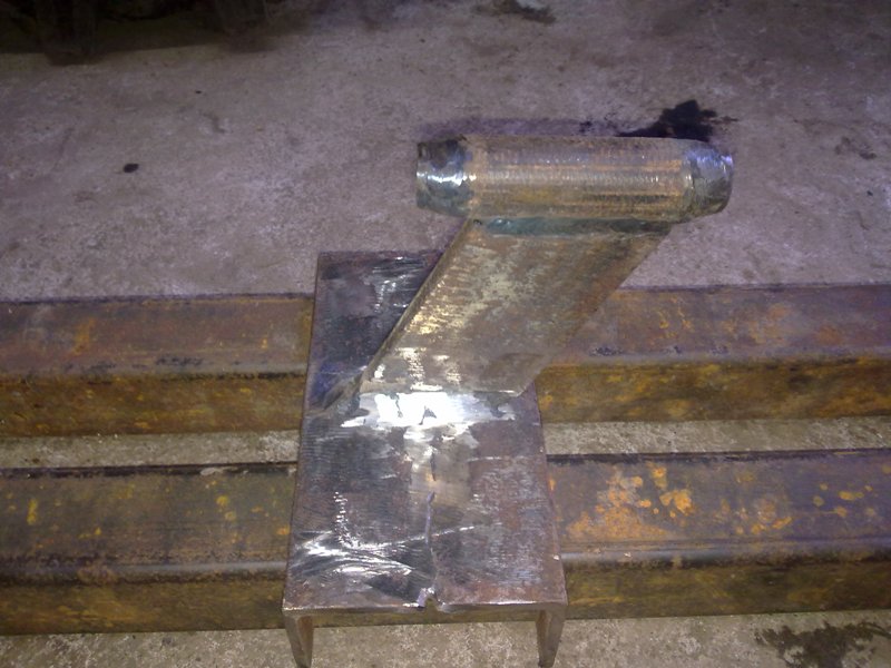

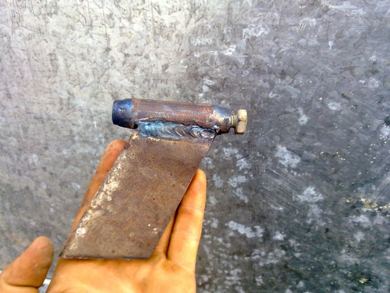

Hi. My first lathe for wood. It was built in 2013 with readily available materials. To create I spent 3 days, old motor of 180 watts washing machine 1380 rev / min. The frame is made of profile pipes 4x40mm.
Attachment 9345 Attachment 9346 Attachment 9347 Attachment 9348 Attachment 9349 Attachment 9350 Attachment 9351 Attachment 9352 Attachment 9353 Attachment 9354

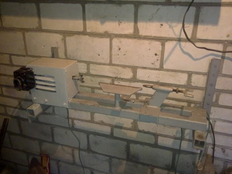

After I installed the new motor, it has a similar characteristic.
Attachment 9366 Attachment 9367 Attachment 9368

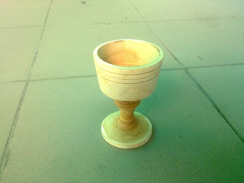

1 Attachment(s)
Made during the trial lathe.
Attachment 9370
