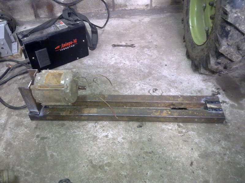

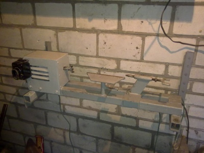

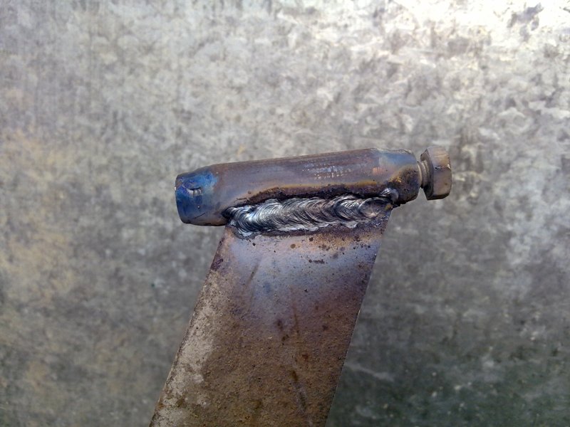

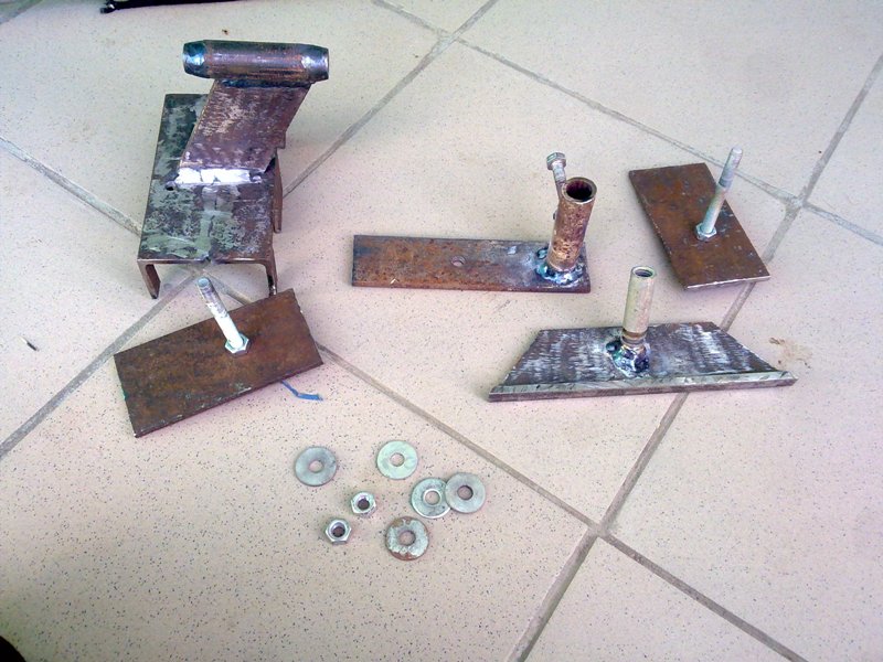

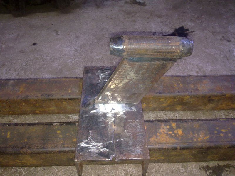

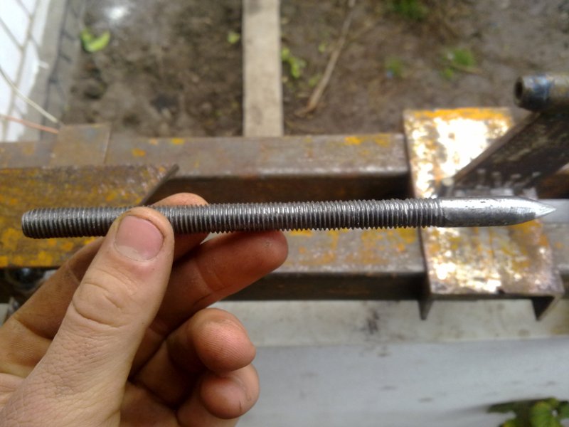

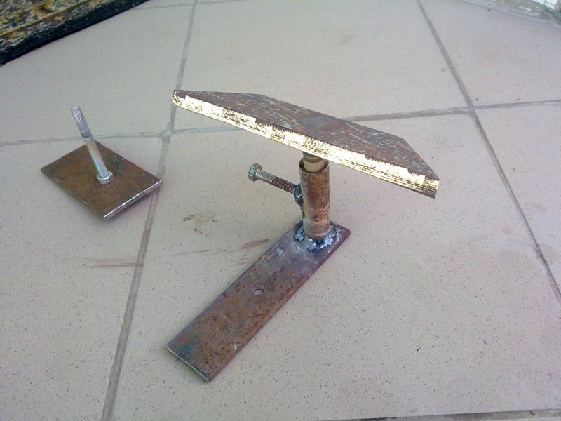

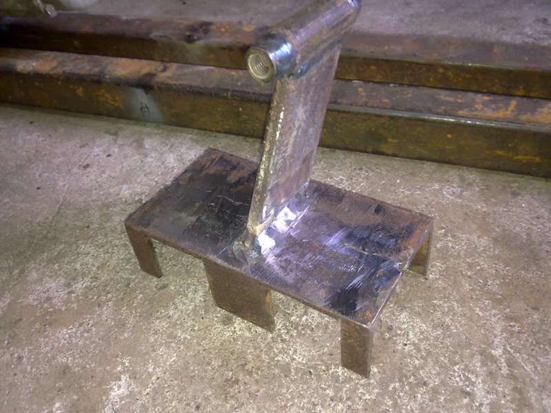

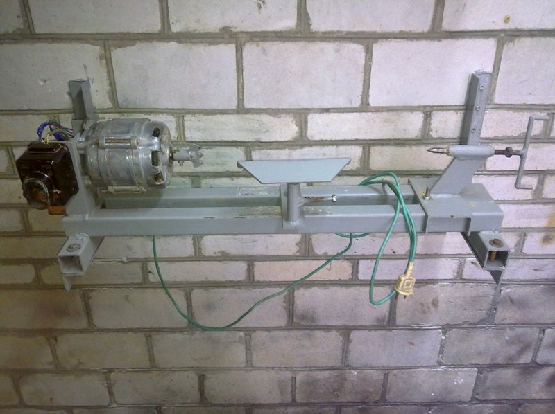

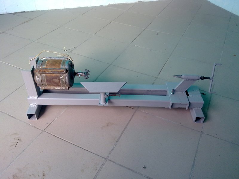

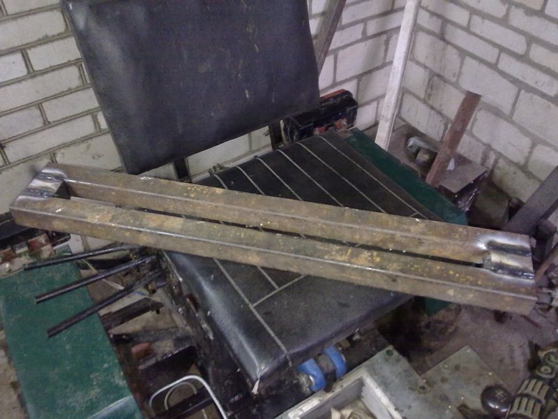

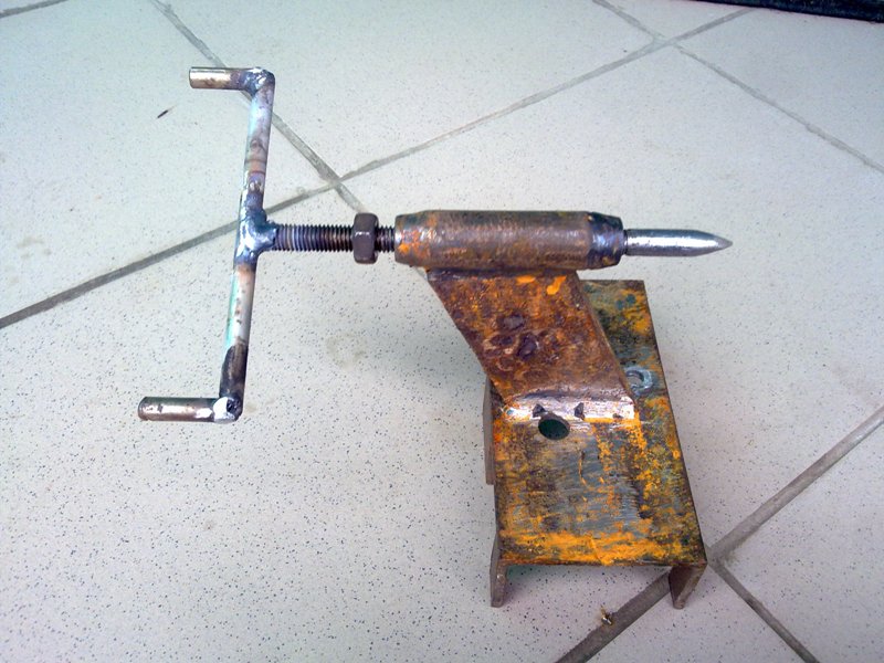

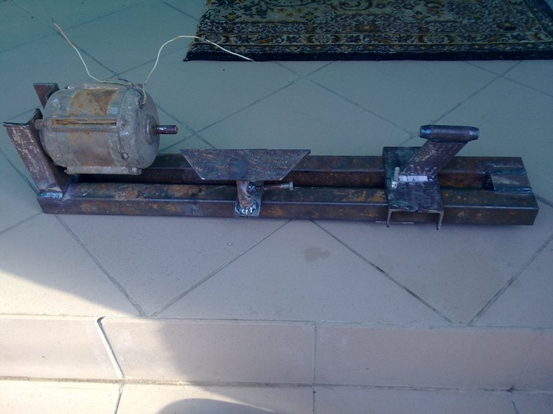

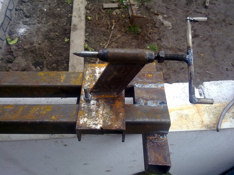

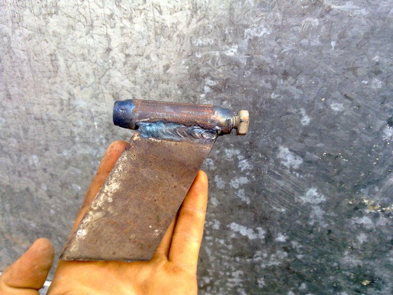

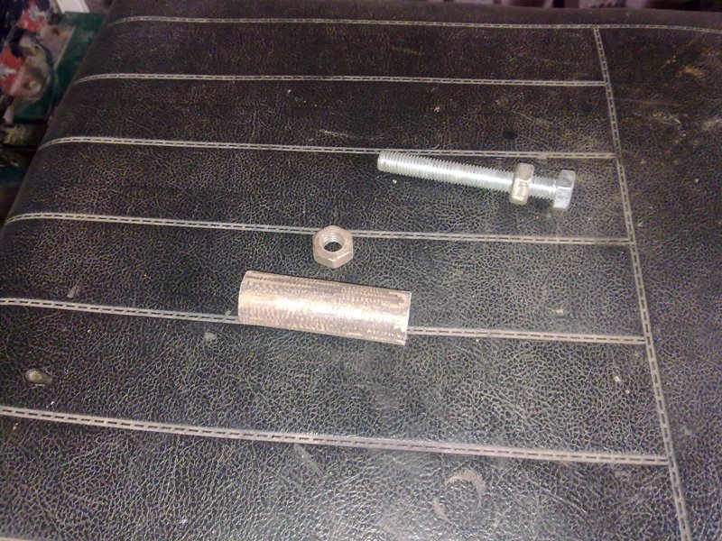

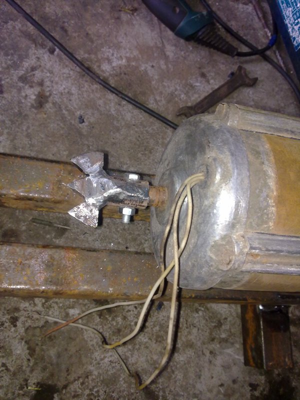

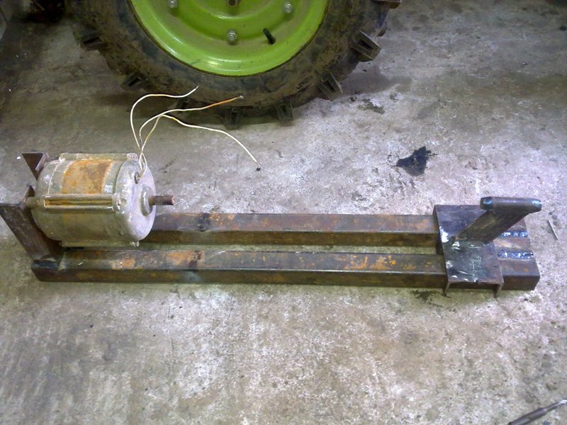

    Hi. My first lathe for wood. It was built in 2013 with readily available materials. To create I spent 3 days, old motor of 180 watts washing machine 1380 rev / min. The frame is made of profile pipes 4x40mm.
    Mini lathe for wood-05112013514.jpg Mini lathe for wood-05112013517.jpg Mini lathe for wood-05112013518.jpg Mini lathe for wood-05112013519.jpg Mini lathe for wood-05112013521.jpg Mini lathe for wood-05112013522.jpg Mini lathe for wood-05112013523.jpg Mini lathe for wood-06112013524.jpg Mini lathe for wood-06112013525.jpg Mini lathe for wood-06112013526.jpg

    Mini lathe for wood-06112013527.jpg Mini lathe for wood-06112013528.jpg Mini lathe for wood-06112013529.jpg Mini lathe for wood-07112013533.jpg Mini lathe for wood-07112013534.jpg Mini lathe for wood-07112013535.jpg Mini lathe for wood-07112013537.jpg Mini lathe for wood-07112013538.jpg Mini lathe for wood-07112013539.jpg

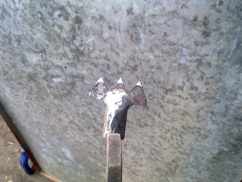

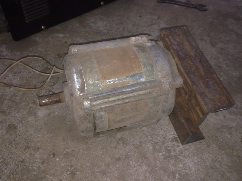

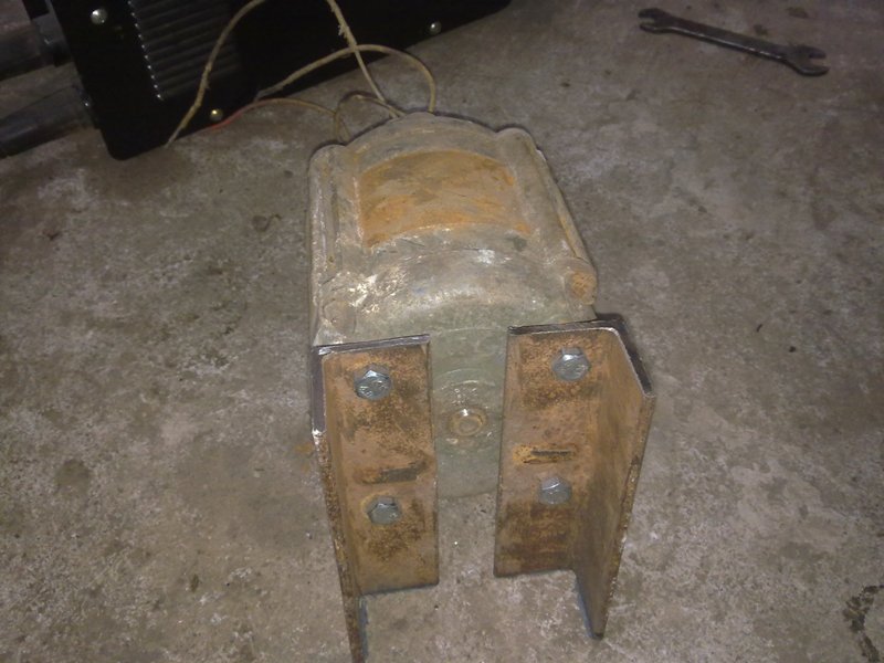

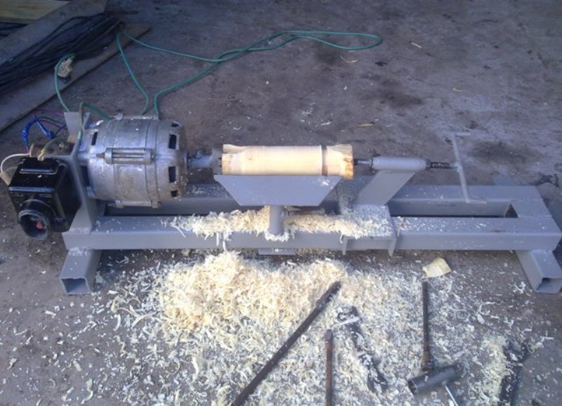

    After I installed the new motor, it has a similar characteristic.
    Mini lathe for wood-09112013541.jpg Mini lathe for wood-14112013550.jpg Mini lathe for wood-fory7ekmhjq.jpg

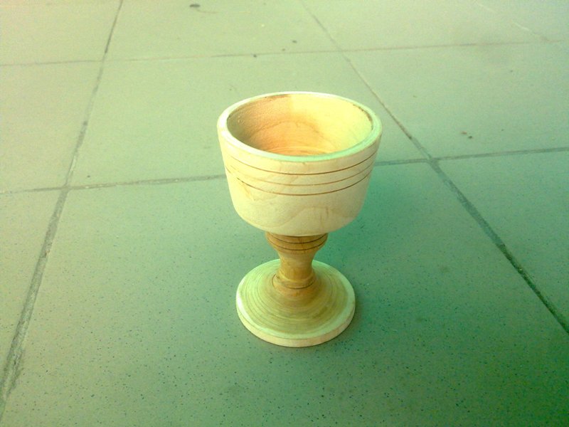

    Made during the trial lathe.

    Tests after 1:45 minutes
