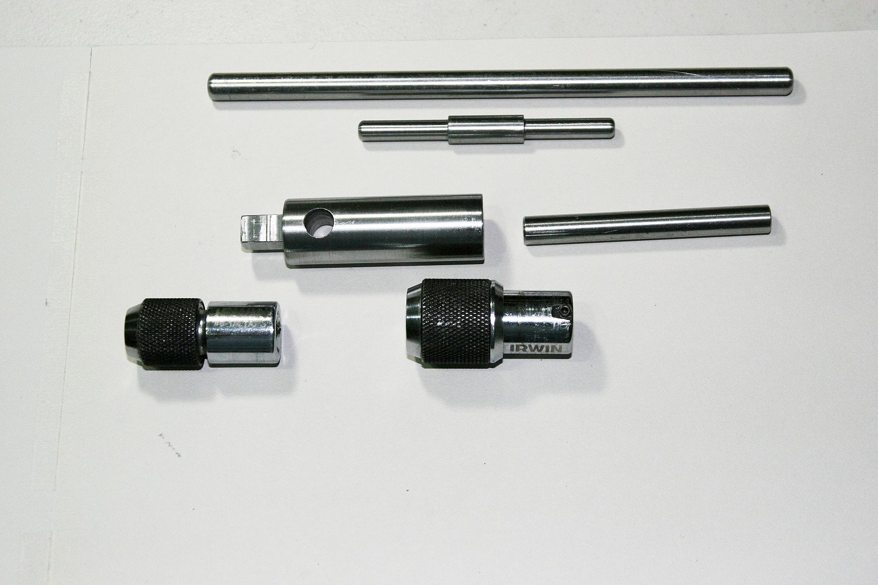

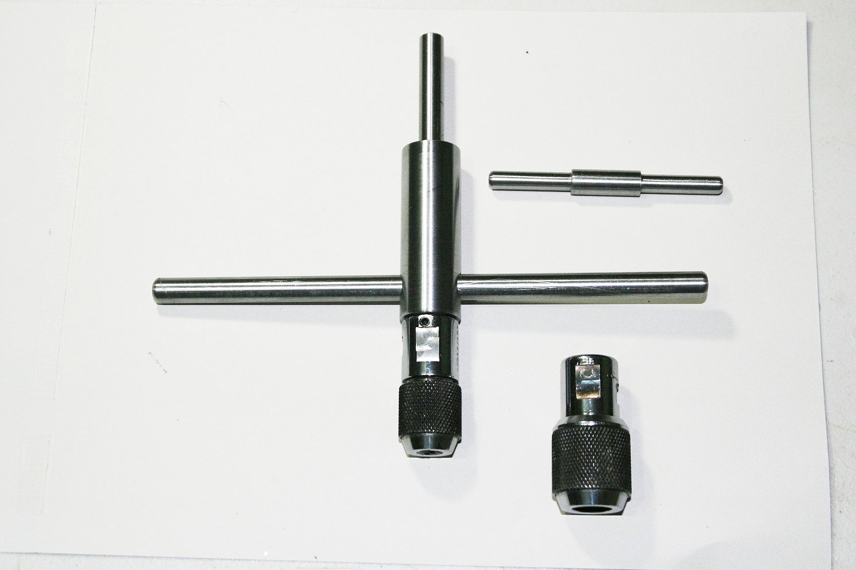

    I was about to make a tapping stand and then thought about how it would be used.
    Mostly after drilling on the Mill or Drill Press I would tap the holes or use the small
    brass threading adapters in the previous thread. Now I already had two Irwin
    tap chucks that were designed to be used with 3/8" socket drive handles or ratchets.
    These chucks hold very well and I tested the run out in my lathe which was about .004".
    So I thought it was worth making another tap adapter for the Mill and Drill Press so that
    I would not need to make the tapping stand. Well here it is:
    3/8 drill rod for the arbor that will fit in the chuck.
    3/8 drill rod for the long and short tommy bars. Why two bars? Well one for smaller taps and
    the long one should be good up to about 1/2".
    One 3" chunk of Hot rolled for the main housing. Turned it to 7/8" then added the square end
    for entry into the Irwin chuck. Drilled and reamed the housing 1.5" deep for the arbor and then
    cross drilled and reamed for the tommy bars.

    Thanks Marv, I like the idea of flutes on the body for use on the smaller taps. I think I will do that mod.
    No problem on the other type of tap guides for the smallest taps. I had designed my tapping stand using
    your T-handle tap wrench thread. I would have turned down the larger of the two (I have a 3 piece set)
    tap wrenches to match the smallest. (not much difference in the ones I have). Then the main shaft for the
    tapping stand would have had 3 cross drilled holes in the end that would line up with the T-handle tap wrenches.
    I like the Irwin chuck method better since I found it to have less run out than the T-handles. Of course my T-handle
    chucks were not Starrett.
    Cheers, JR
