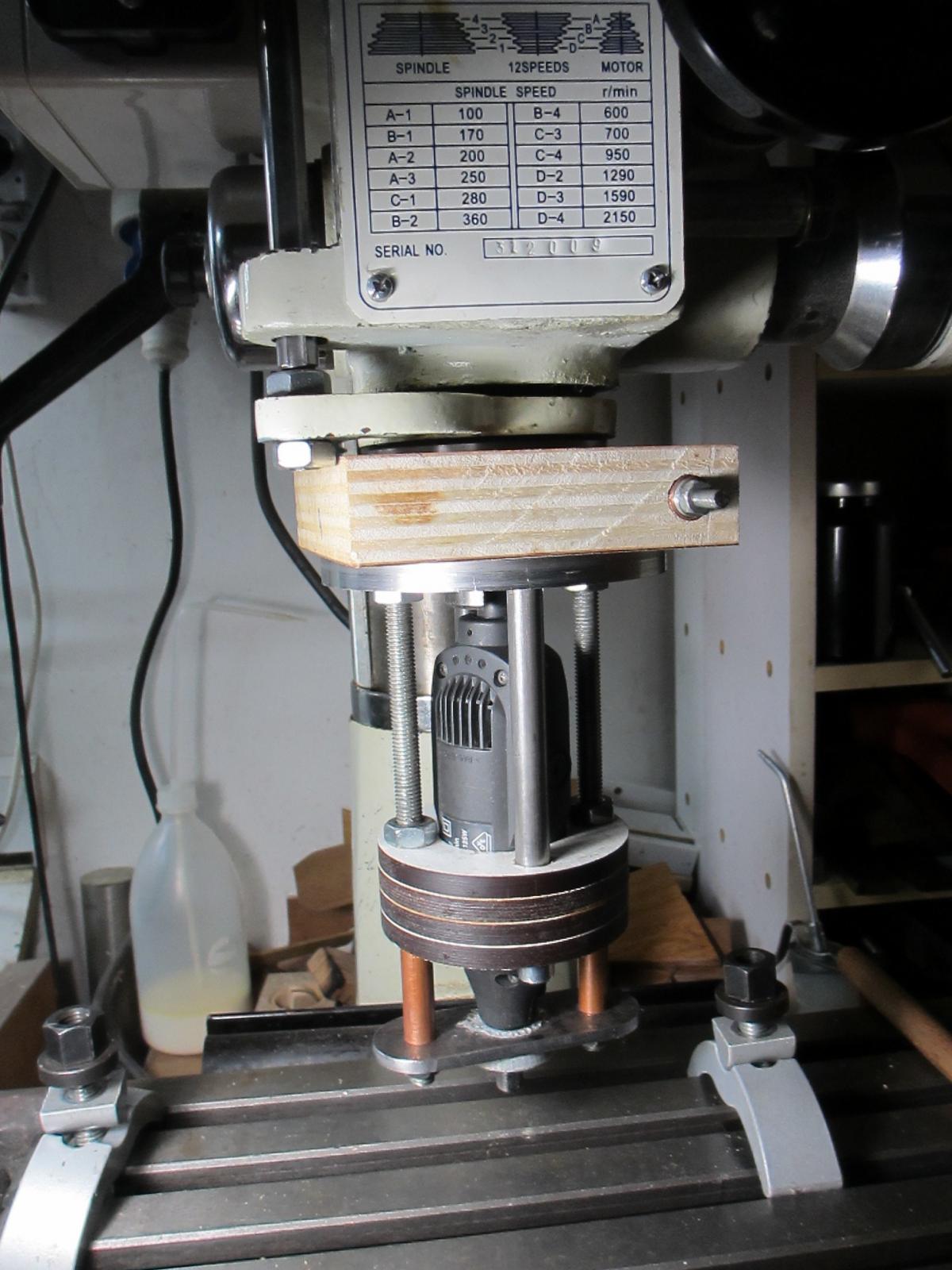

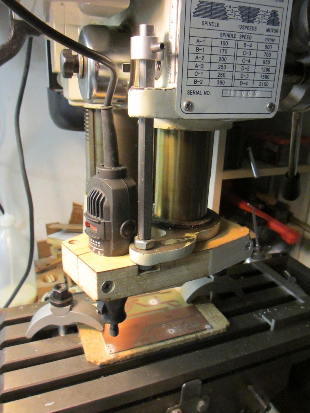

    I want to mill printed circuits boards (PCB’s). The required small mills demand for a high speed. So a Dremel with 30000 tpm is an adequate tool. The cross table of my drill-mill is very useful when the copper traces are orthogonal or under 45 degrees.
    I don’t have a CNC mill but a simple hand controlled drill-mill.
    I started some years ago with a quill clamp which holds the Dremel besides the machine head (picture 1).
    This design has a drawback: the quill has angular play which changes the position of the Dremel wrt the work piece.

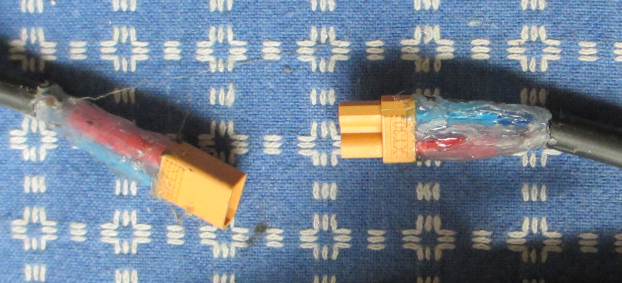

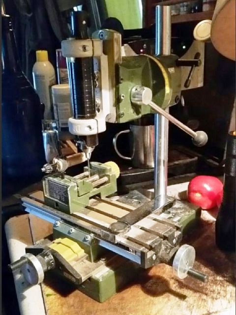

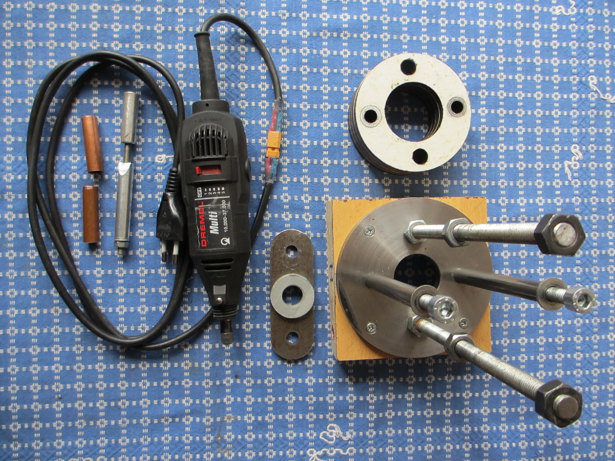

    So I decided to make a Dremel fixture where the Dremel is mounted centrally to the quill (picture 2). To limit the length of the fixture I directed the power cord through the spindle boring. To that end it was necessary the cut the power cord of the Dremel and provide it with a small (11 mm) plug and socket, small enough to allow passage through the boring (picture 3). The soldered connections are isolated with heat shrink and hot glue.
    Drill-mill fixure for central Dremel mounting-img_0797.jpgDrill-mill fixure for central Dremel mounting-img_0851.jpgDrill-mill fixure for central Dremel mounting-img_0858.jpgDrill-mill fixure for central Dremel mounting-img_0844.jpg

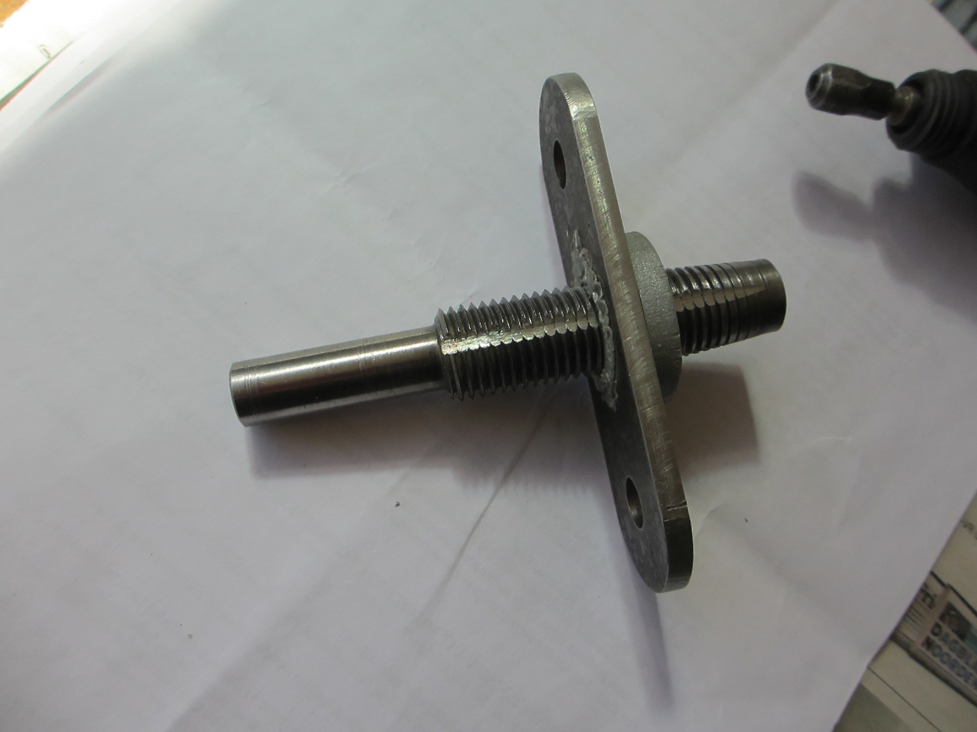

    The Dremel itself was screwed in a PLA nut, 3-D printed by a friend. The nut was pressed and hot fixed in a steel strip (picture 4). 3-D printing screw thread seems to be difficult for, in different trials, the threads where always to small. So I made a tap for this non standard thread (¾”, 12 tpi, 60 degrees) and widened the thread. (Alternatively an alu nut can be made with the same tap.)
    The Dremel is supported by an enclosure made from 4 stacked layers of 8 mm compact laminate sheet (see pictures 2 and 6). It ensures a stiff mounting without side movement.

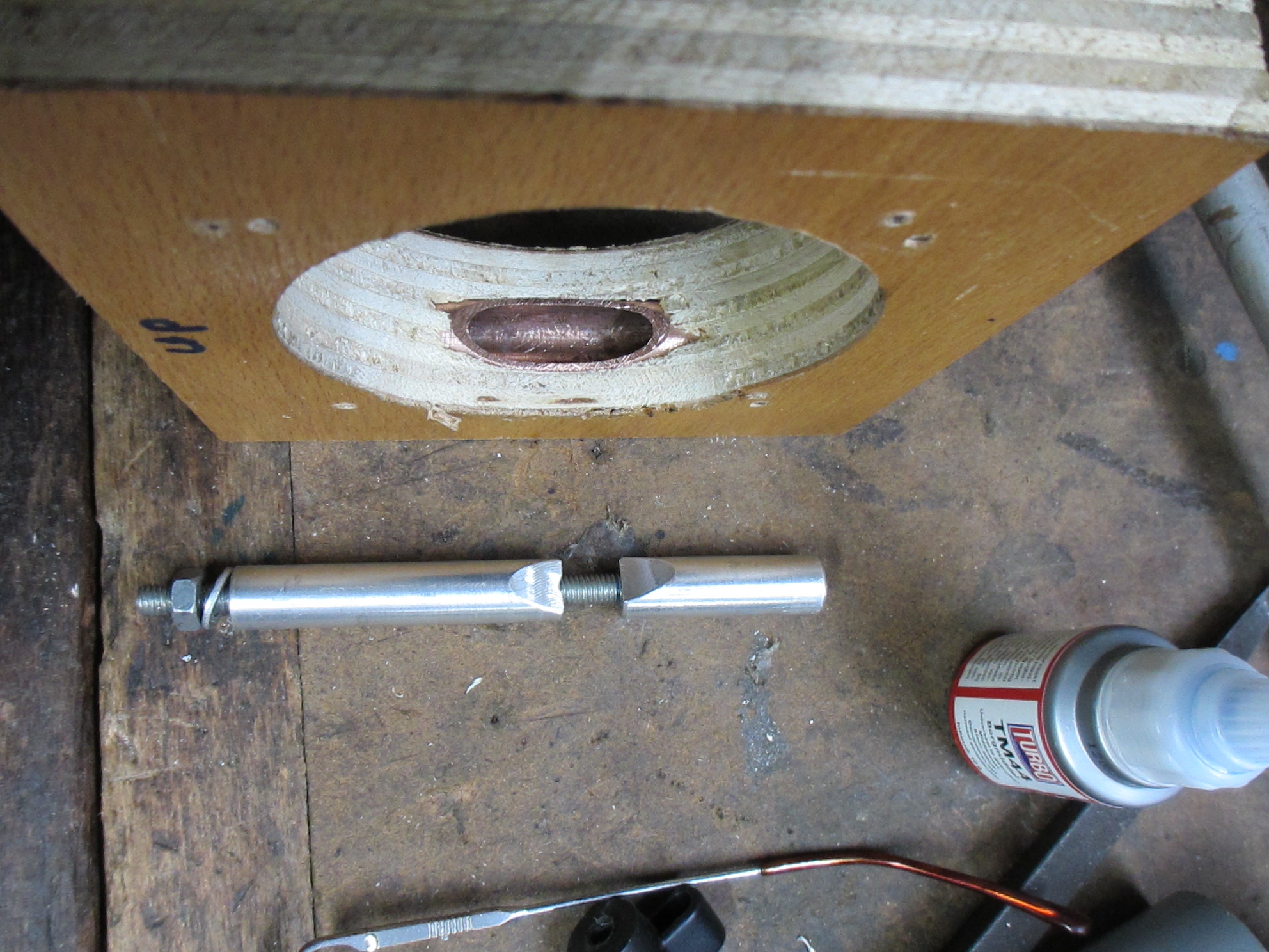

    For clamping the fixture to the quill I used 32 mm plywood (pictures 2 and 5). Perhaps it is not the best material, but it was the only material of sufficient thickness I had in stock from a discarded kitchen top. The hole encloses the quill’s collar narrowly and is fixed by a pair of alumin(i)um cotter pins (British naming) (picture 5). The hole in the clamp for the cotter pins is provided by a copper tube in order to let the pins slide easily.
    Drill-mill fixure for central Dremel mounting-img_0850.jpgDrill-mill fixure for central Dremel mounting-img_0859.jpg
    My Dremel is an old model. I noticed some radial play in the Dremels spindle. Dismantling showed that it was not the bearing itself but the bearing house. I filled it with small pieces of 0.1 mm milar sheet. Now the spindle is without any play.
    This design is giving a very stiff mounting thanks to the 4 vertical studs. The shorter two are made from 12 mm round rod, the longer ones are 10 mm threaded rod.
