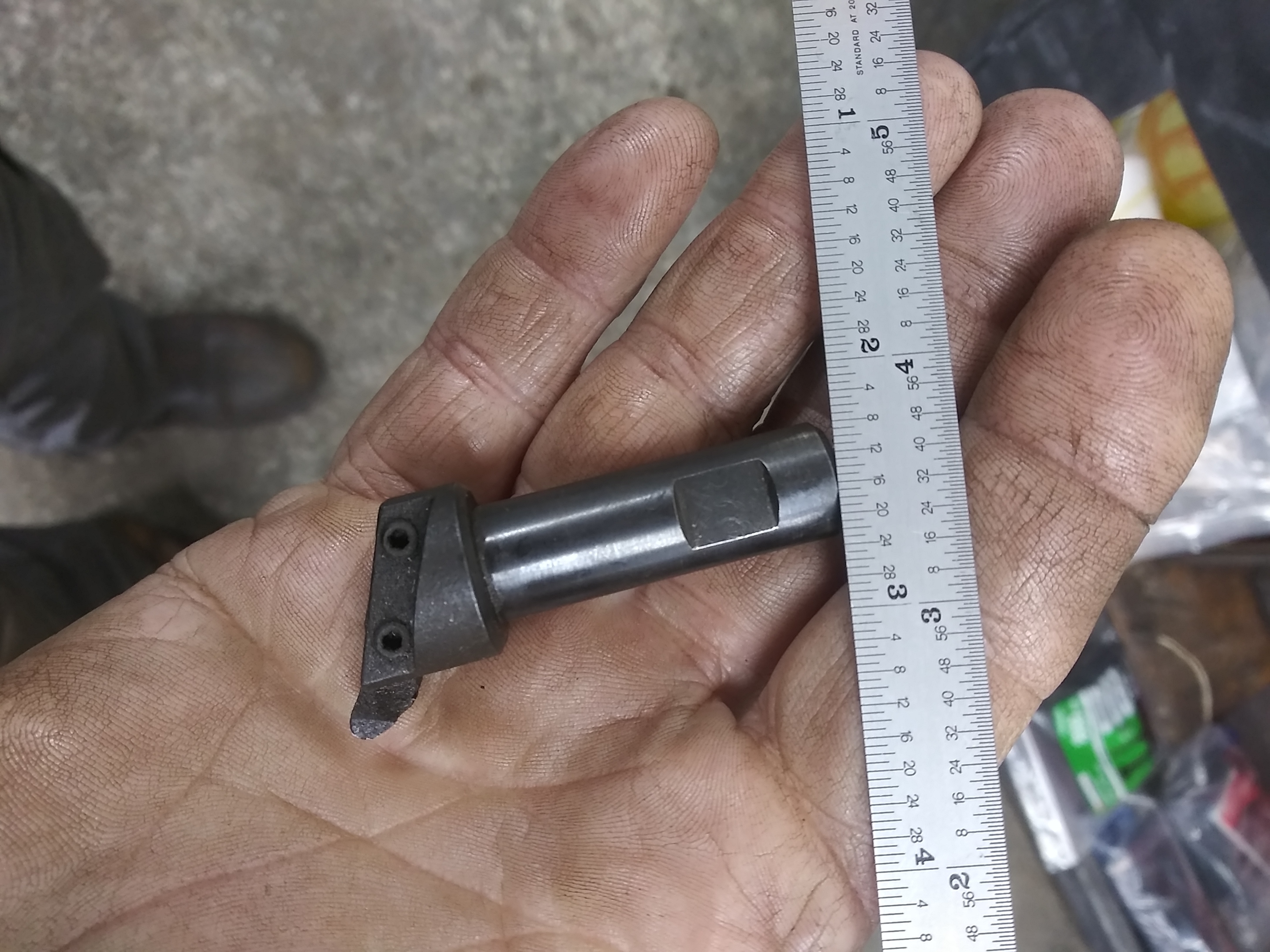

Fly cutters are my favorite form tool when applicable. Few can hand grind 2 or more equal cutting edges on an endmill.
Careful planning and work will blend intersecting surfaces (fillet) with a undetectable lap or toolmarks.

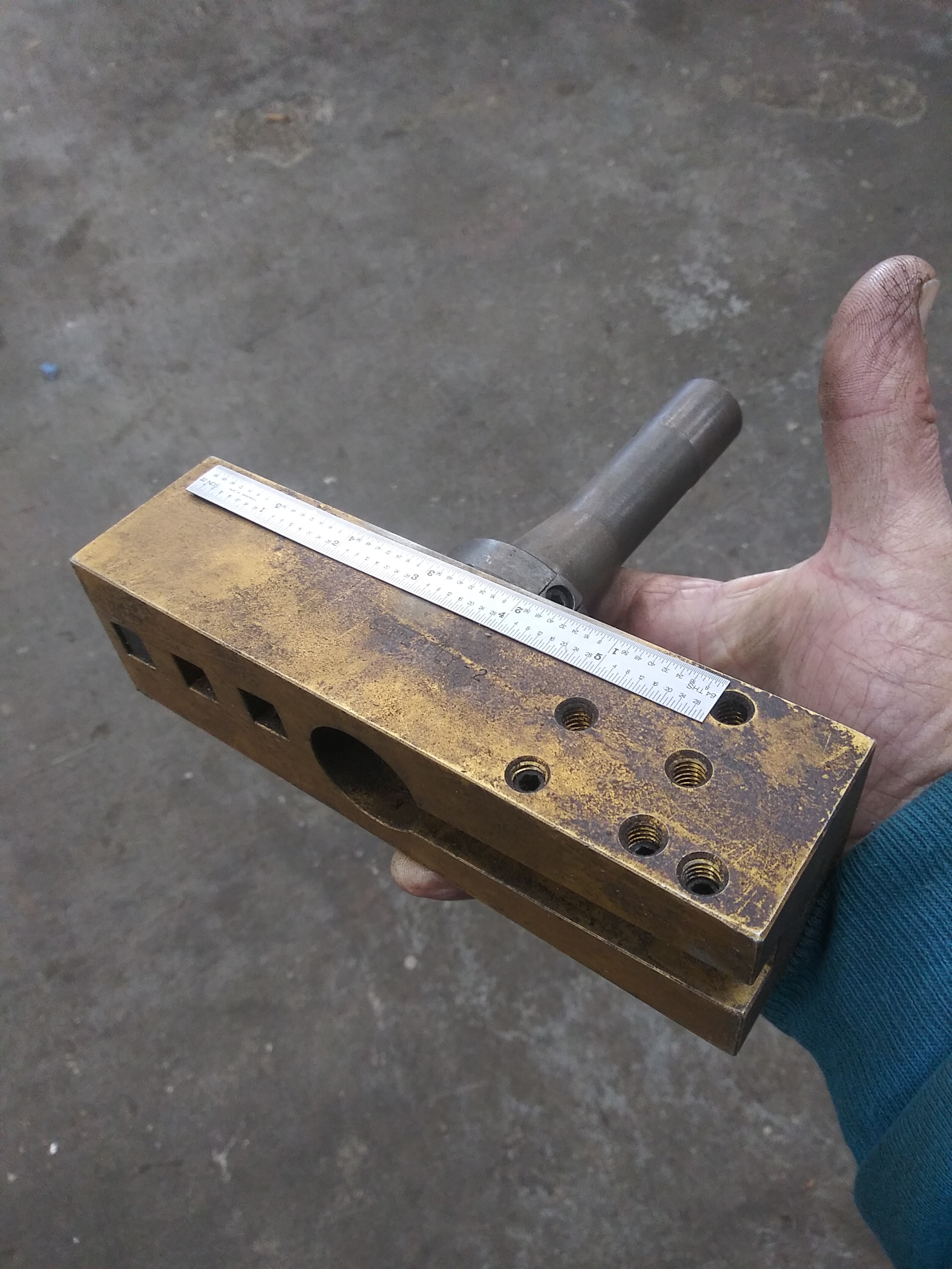

And size? From Attachment 44122 to Attachment 44123
That's about limit I'll test my or a knee mill's limits. Little one 1/2" shank, larger is R8, with an aluminum body to alleviate rotational mass.

Just yesterday (compared to 03:08 am) the larger fly cutter was employed as a boring tool, on a stainless plate 3/8" thick x 28" square in Bridgeport. The cutter was stepped out by hand for hole to 8-1/2". In cases like this, (mainly poor clamping) the feed mechanism wasn't used. Locked the quill in uppermost position, and fed the work manually with the knee, lowering to re-set cutter, and thus proceeded until reaching size.
There is no "break even" spot between fly cutting and face milling. One is the other on steroids, or a diet. As you said "right set up, right machine...". Weak link is the setup, which condition of the cutter is a factor.
