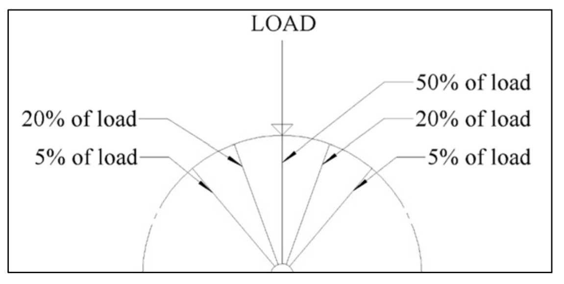

    The most common tensegrity structure on earth has to be the spoked bicycle wheel, I guess?
    36 (or 32) spokes @ ca 500 N pure static tension apiece holding the round rim from straightening itself out,
    as a spin-off effect it also suspends the bike frame and rider only tru the slightly higher tension in the topmost spokes,
    and the somewhat less tension in the spokes close to ground... No compression in any spoke possible:
