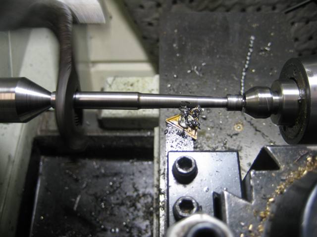

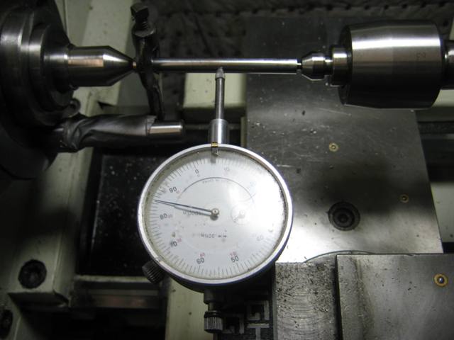

Setting the taper by offsetting the tailstock and verifying it:
Attachment 264

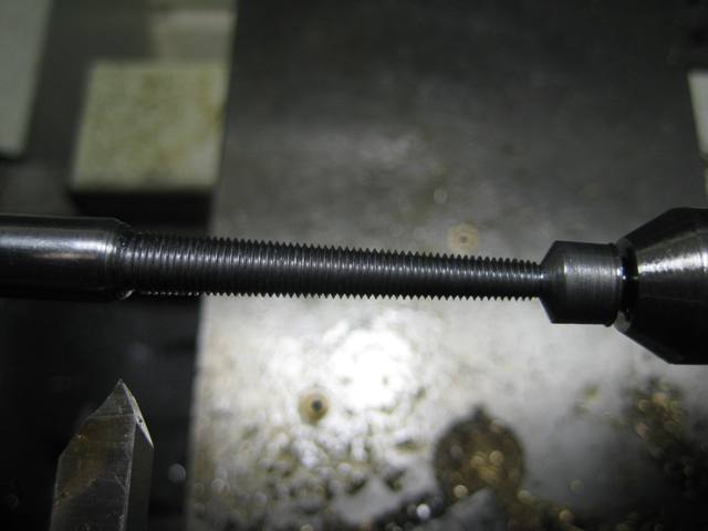

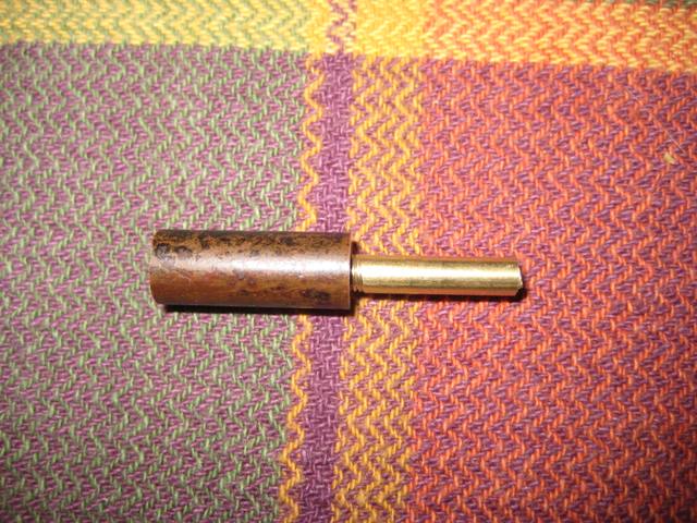

Turning the tapered thread for the tap:
Attachment 262
Cutting the threads:
Attachment 263

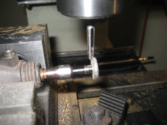

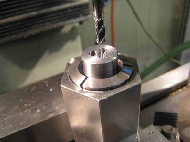

Cutting the flutes. That's a dremel with a diamond coated form grinding tool held in my mill vise. Notice the grinding tool is NOT located on the vertical centerline of the tap... This gives positive rake to the cutting edges. The mill spindle was indexed by eye to give 4 flutes. With the mill tunred off (and UNPLUGGED), the quill was plunged down onto the grinding wheel to cut (and sharpen) the flutes.
Attachment 265
