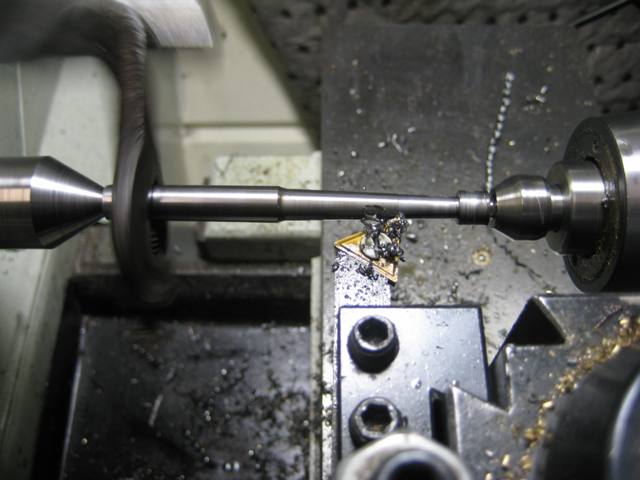

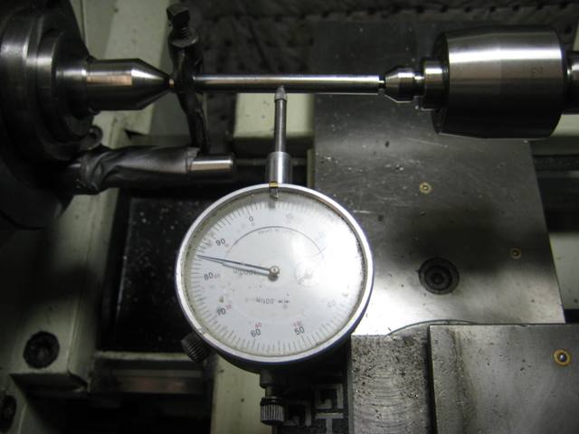

    Setting the taper by offsetting the tailstock and verifying it:
    Turning the tapered thread for the tap:

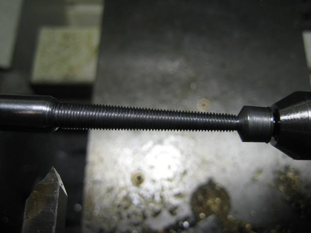

    Cutting the threads:
    Hardening and tempering happens... Heat to cherry red, quench. Heat to pale straw, quench again...

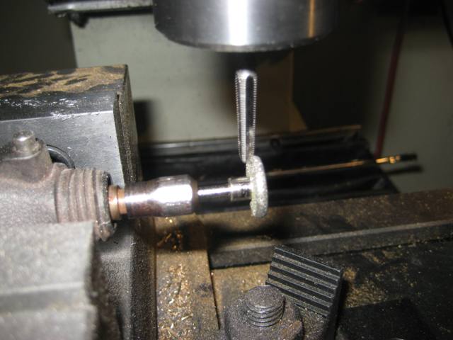

    Cutting the flutes. That's a dremel with a diamond coated form grinding tool held in my mill vise. Notice the grinding tool is NOT located on the vertical centerline of the tap... This gives positive rake to the cutting edges. The mill spindle was indexed by eye to give 4 flutes. With the mill tunred off (and UNPLUGGED), the quill was plunged down onto the grinding wheel to cut (and sharpen) the flutes.

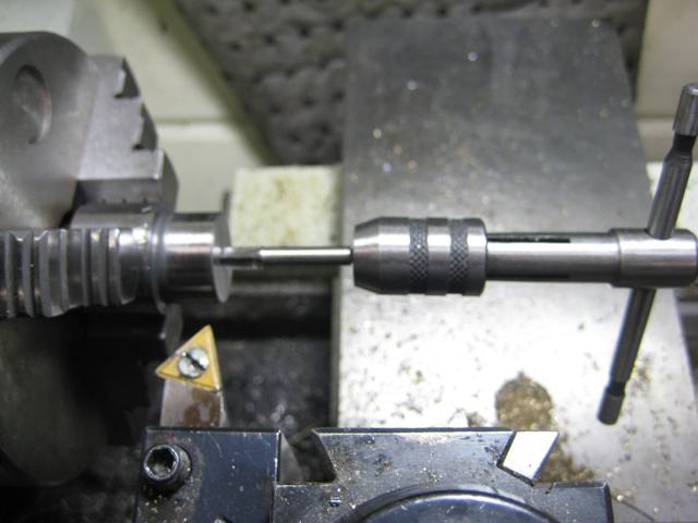

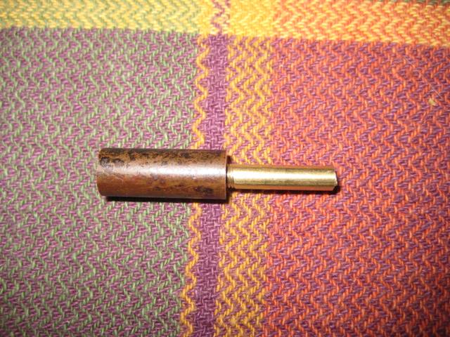

    Using the newly made taps to cut the threads for the die:
    A miniture tap and die for steam engine pipe threads-using-newlay-made-tap-thread-die.jpg

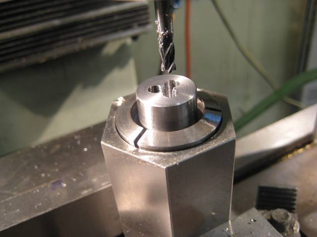

    Cutting the rake holes:
    Hardening of the die now occurs the same way as the tap. The rake holes are afterwards cleaned up with a cylindrical diamond cutter in the dremel to return the edges to sharpness.

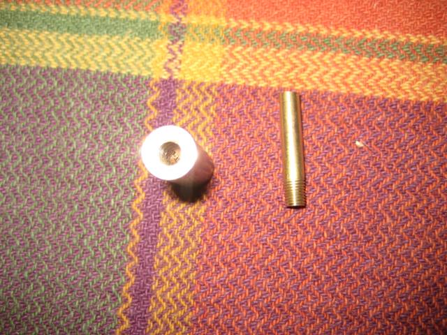

    Some test threads:
    Test fit:
    John

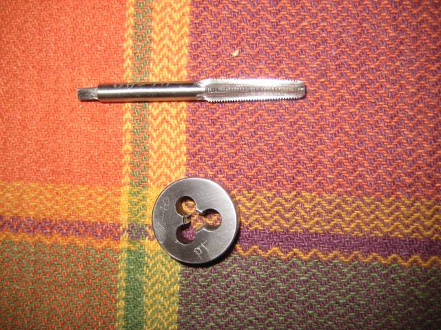

    Finished tap and die:
    A miniture tap and die for steam engine pipe threads-finished-tap-die-set.jpg
    That's it! You can make straight taps the same way (but without the taper)
