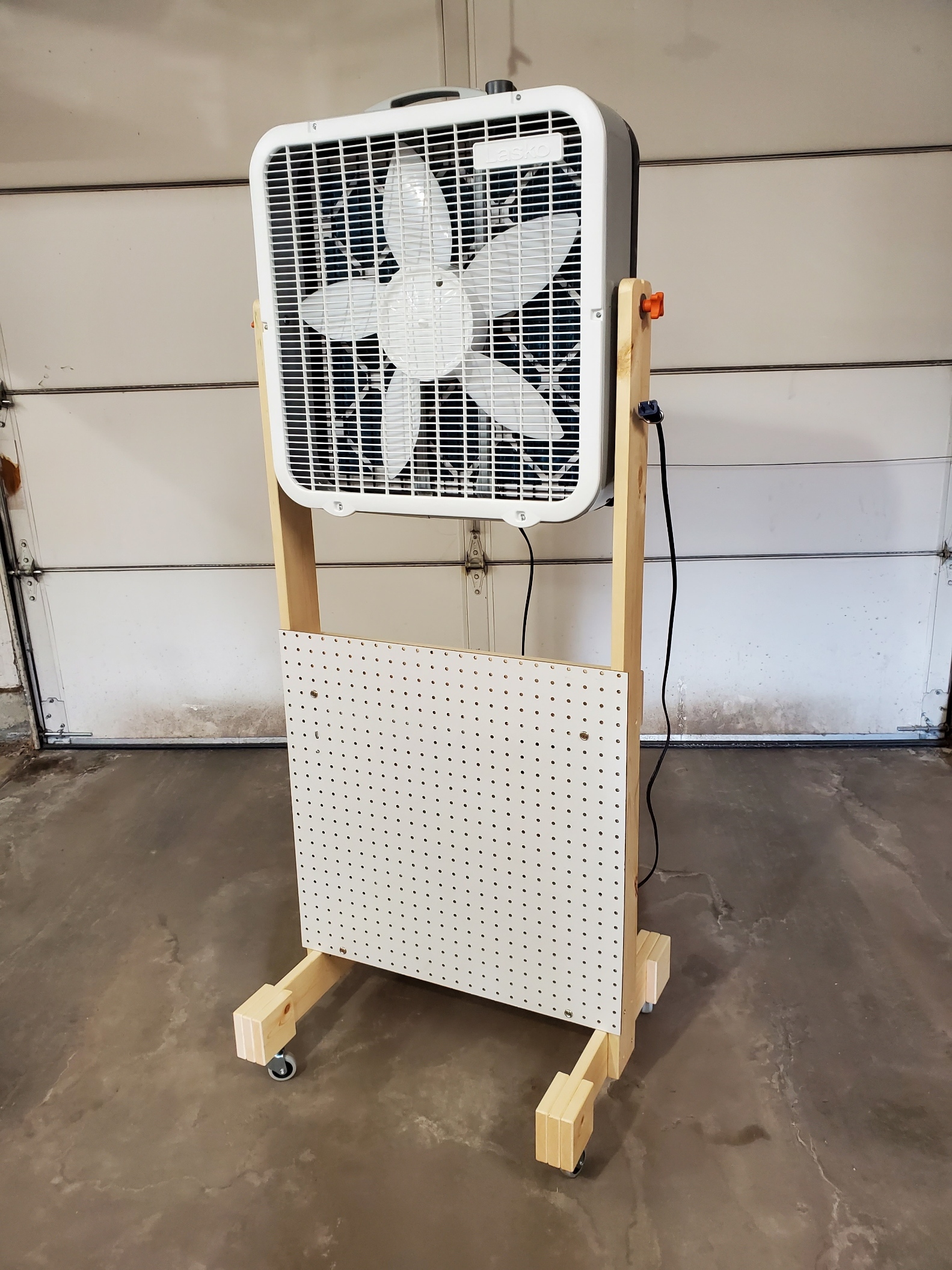

The biggest issue was finding a place to put it. On the floor works OK, but it should be closer to shoulder lever for better air clearing and circulation. Placing it on a workbench is better, but there it is always in the way. As I frequently do, I searched online for ideas. I found a very basic stand and elaborated on the design to better fit my needs.
Attachment 44824

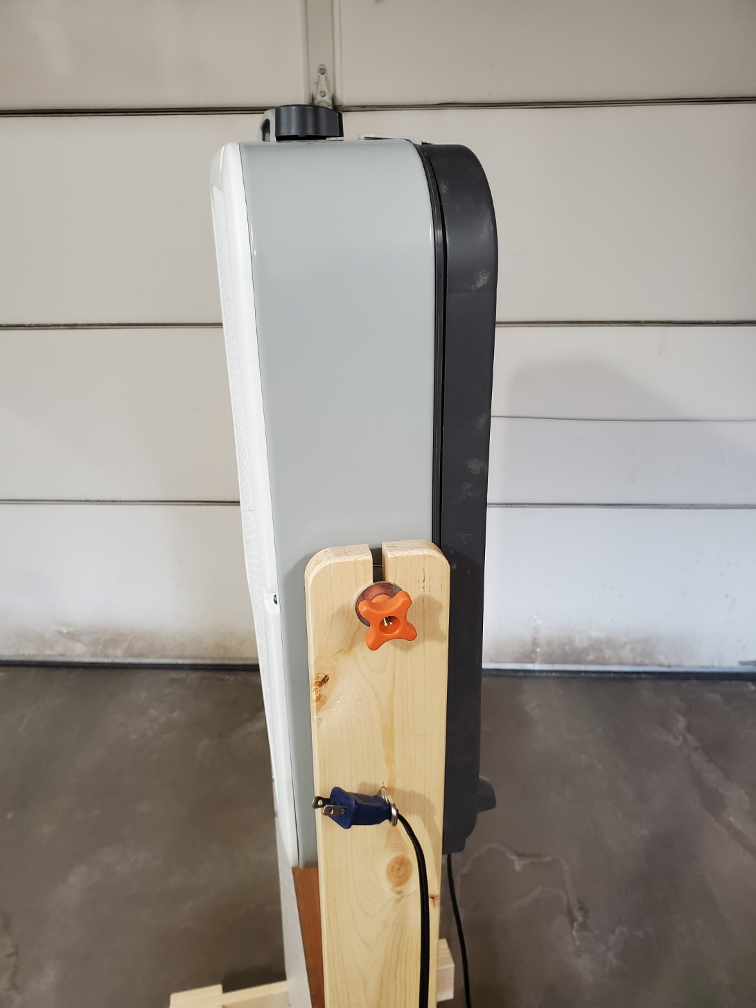

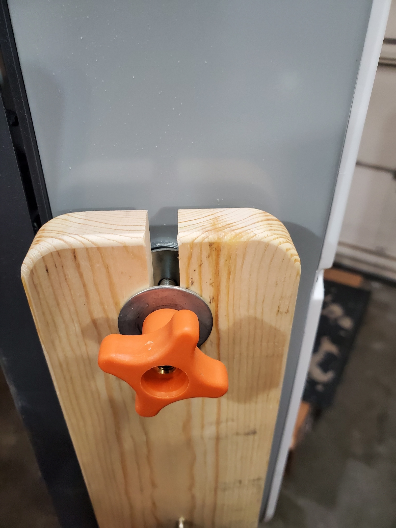

I mounted a pair of 1/4-20 carriage bolts on the sides of the fan. I put a slot in the top of the supports and secured it with knobs. The slot allows easy removal of the fan in case I need to service it or want to temporarily put it somewhere the stand doesn't work. The knobs allow the fan to be tipped up or down as desired.
Attachment 44825 Attachment 44826

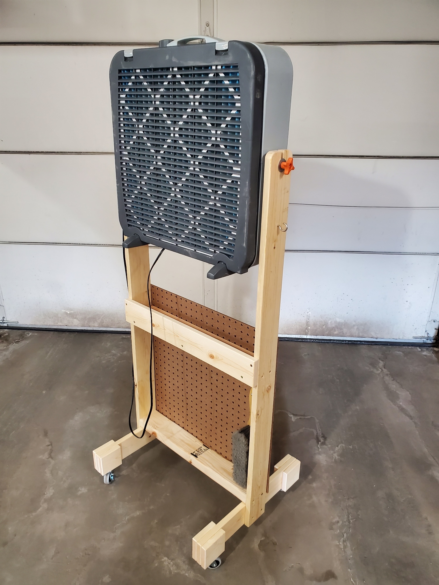

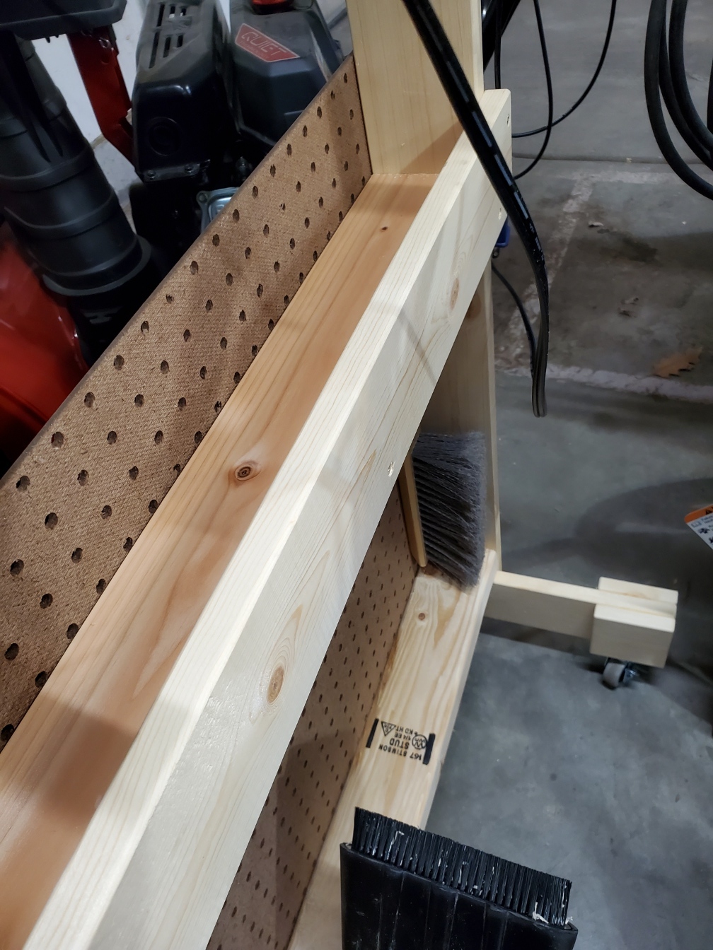

The uprights are 48" tall. The legs are 20" long. I had to add on some small pieces to the legs in order to mount the casters. There are two 2x4 cross-braces cut to length to match the fan width.
Attachment 44827

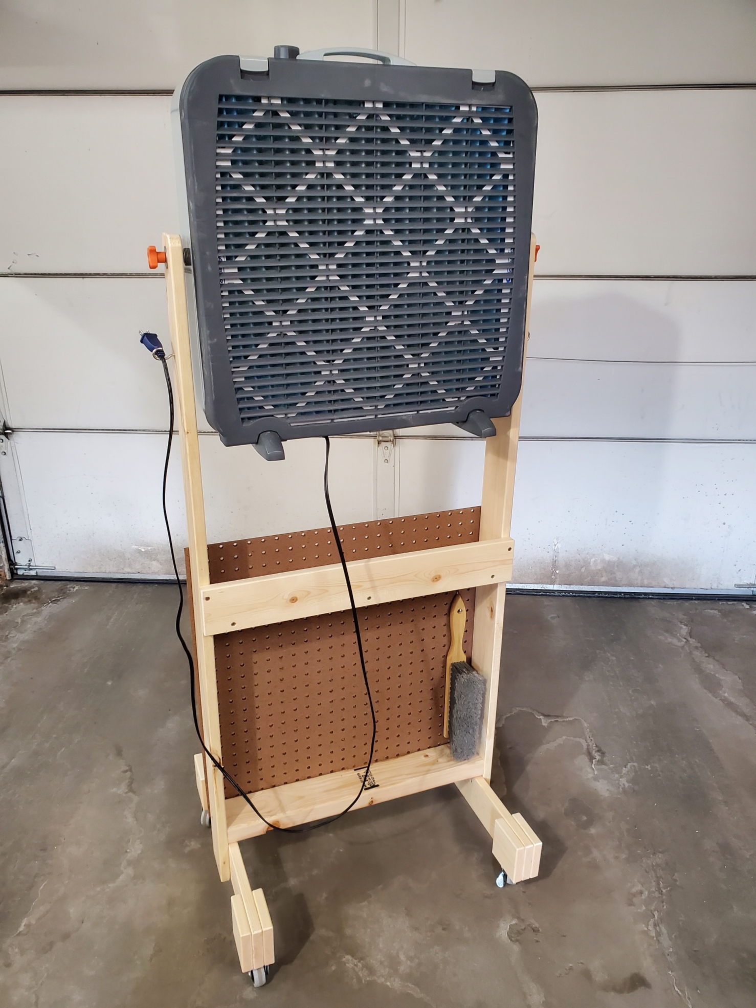

I attached a piece of pegboard for diagonal stability, and for tool / supply storage. The pegboard extends a few inches above the upper cross-braces and put a piece of 1x4 across the back to make catch-all shelf for small items.
Attachment 44828 Attachment 44829

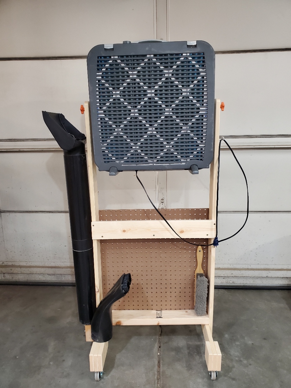

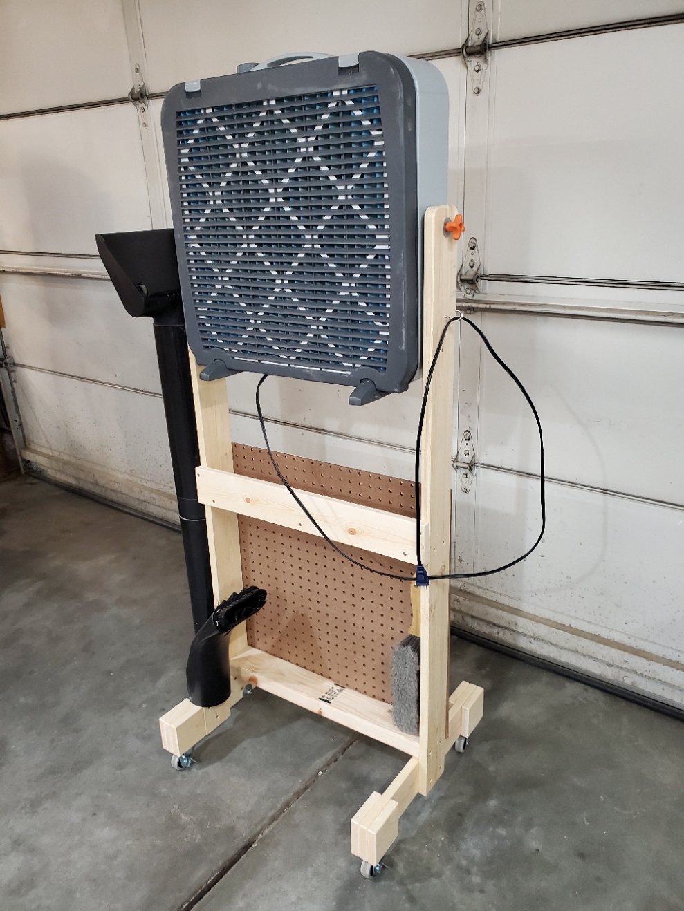

I also added a small screw hook to one side to help with cord management. I often power this fan from a ceiling-mounted cord reel and use the hook to support the cord. It is also a place to store the fan's plug when not in use.
So far, I just have a bench brush hanging from the pegboard. Plenty of room for other items as I find the need. "You can never have too much storage."
Both sides of the pegboard can be used for storage, though the white side is "downrange" of the fan -- your hat may get blown off if you aren't careful.
