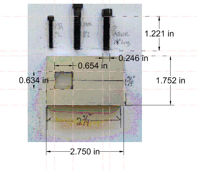

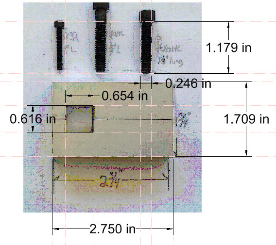

    Thank you very much! Here's my first attempt at CAD dimensioning.
    As you can see, the dimensions indicate to me that the image was taken slightly off of straight up - perpendicular. My horizontal measurements seem very good, but vertical I came up short. This is easily addressed by changing the scaling factor on the vertical axis. Up to this point I used equal numbers to scale in both X and Y dimensions. I'll play with it a bit more and see what I get.
    For the second measurement, I just took the value I had (1.709) divided by the value I wanted (to match what you wrote - 1.75) and got 0.976. Then 1 divided by 0.976 = 1.02459 (trying to get reasonably close) which I then applied as a scale-increase to only the Y axis. As you can see, in my second attempt, I have dimensions very close to what you actually measured for me. Now that I have that on both axes, I can presume any other measurements, such as the size of the square hole, will be close as well.
    The discoloration of the image comes from the scaling process. I had to reduce the image size drastically to get it down to fit the scale I use when drawing in CAD. It messes with the inserted bitmap's colors, but I can get what I am after. One other issue is that in reducing the image about 70 times smaller to the scale I needed, it blurs the clear lines along things like the hole. So my construction lines to follow its edges might not be very precise. But I was just looking for the basic sizes, so this is fine! Thanks again!

    You are more than welcome. Good job. I should have said +/- 1/16" because this was totally TLAR or ETS( engineer to stock) and was surprised it was so close to actual measurements. But your dimensions are much more legible than my chicken scratches. But hey, you said rough estimation so rough it is. Sorry I couldn't get it exactly overhead.
