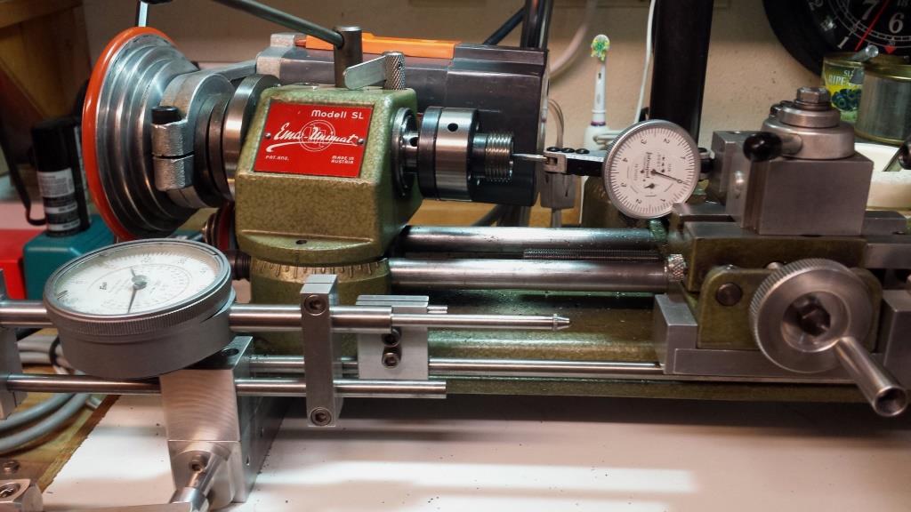

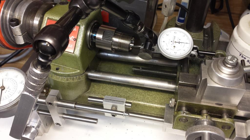

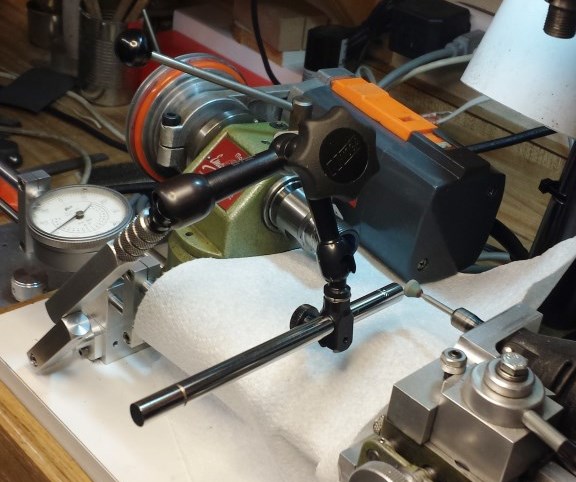

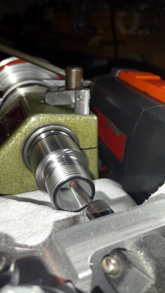

    I recently made a more accurate ER16 collet chuck for the Unimat (see Homemade Tapering Method for Homemade Collet Chuck ) and while I had the lathe setup for grinding the new chuck, I also ground the taper surface of a commercially available hardened ER16 collet chuck. Several years ago I had bought the hardened ER16 collet chuck with a M12X1 internal thread from a seller on eBay but was disappointed with the TIR of approximately 0.003" and never used the chuck. Using the Dremel tool in the QCTP and a fine grain grinding stone it was possible to grind the TIR to within 0.0001". Now the only real limitation for the collet chuck TIR is the precision of the ER16 collets.
    The 8 degree angle for grinding was determined by using a very precise old style E16 collet chuck I bought new in 1970 when I bought the Unimat SL 1000 lathe.
    Modifications and Improvements to a Unimat SL 1000 Lathe-setting-8-degree-taper-using-old-e16-collet-chuck.jpg
    Before starting the grinding operation the Dremel grinding stone was dressed with a diamond dresser.
    Modifications and Improvements to a Unimat SL 1000 Lathe-unimat-sl-setup-dressing-dremel-grinding-stone.jpg
    Next the old E16 chuck was removed and replaced with the hardened ER16 collet chuck bought on eBay but with a 0.003" TIR.
    Modifications and Improvements to a Unimat SL 1000 Lathe-dremel-grinding-er16-collet-eight-degree-angle.jpg
    Measuring the newly ground TIR of the hardened ER16 collet chuck to be within 0.0001". Now the collet chuck can be used again for precision work in the Unimat.
    Modifications and Improvements to a Unimat SL 1000 Lathe-grinding-commercial-er16-chuck-within-0.0001-inch-tir.jpg

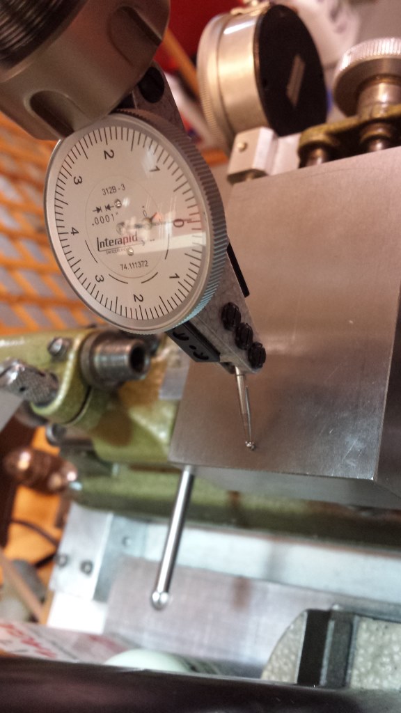

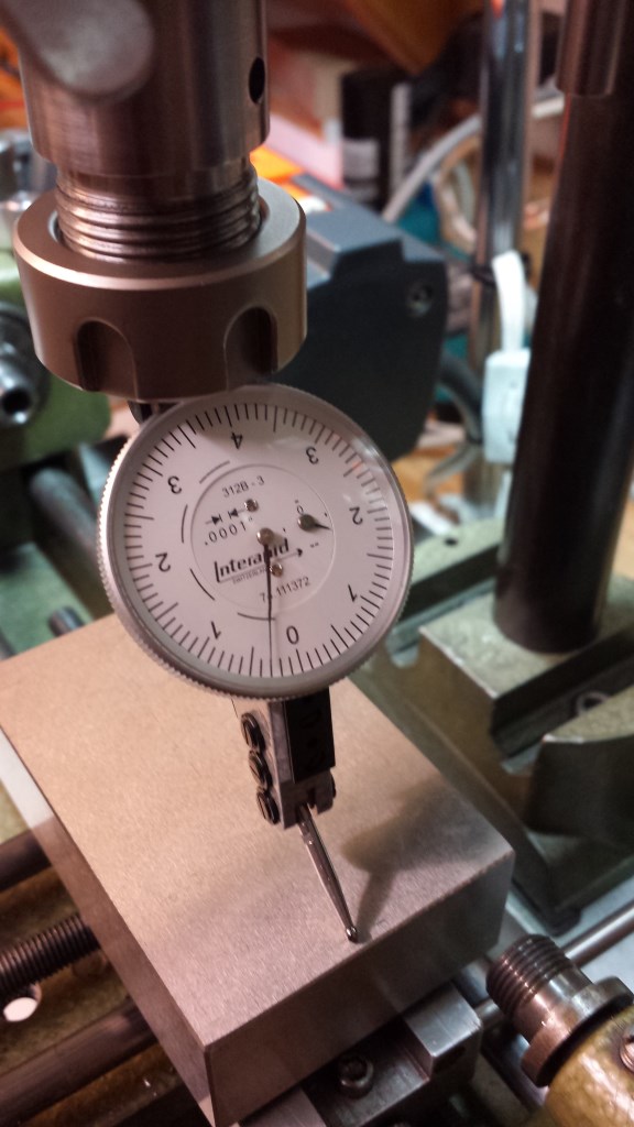

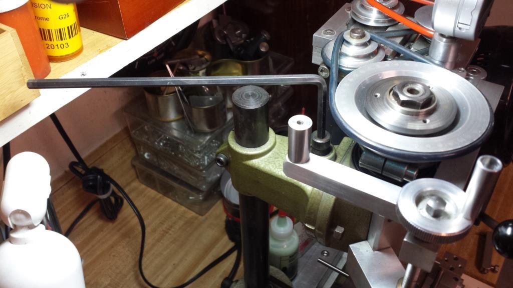

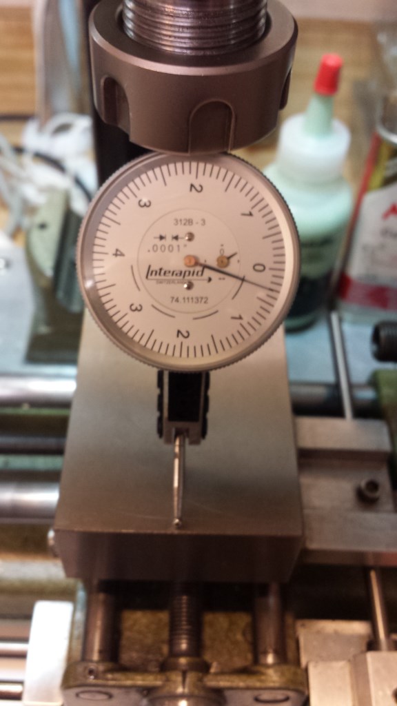

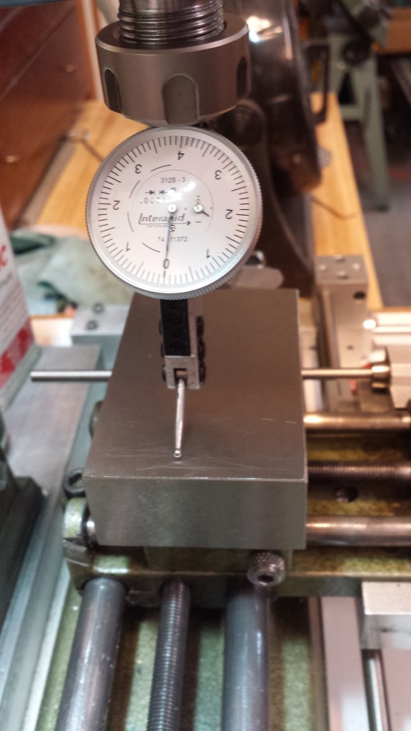

    I recently received a question from a member of Home Model Engine Machinist forum regarding the Unimat milling head moving out of tram over time. I was not aware of this happening and this morning I measured the front-to-back tram to check for any movement. I had originally added to the milling support base a 0.0015” thick shim to bring the vertical column into tram front-to-back. Today's measurement has the front-to-back tram out by 0.0003" over a 3" distance across a 1-2-3 block and much better than I expected. This may be a slight droop over a two year period but well within the tolerances of this machine because the 25 mm vertical column can flex +/- 0.0005" during milling operations with heavy cuts.
    However, I did find the side-to-side tram along the long axis of the Unimat to be out by 0.0015". This has always been a problem with the milling head because it can rotate slightly even with the locking screw and locking pin in place on the Unimat headstock assembly. It took about 15 minutes but I now have the long axis trammed to with 0.0003". This is an operation that should be done ever 3 to 6 months but I usually put it off.
    I included a few photos of the Unimat milling head tramming operation including a photo of the dividing plate removed for access to the milling headstock locking screw.
    Paul
    Modifications and Improvements to a Unimat SL 1000 Lathe-unimat-side-side-milling-head-tram-right-side-measurement.jpgModifications and Improvements to a Unimat SL 1000 Lathe-unimat-side-side-milling-head-tram-left-side-measurement.jpgModifications and Improvements to a Unimat SL 1000 Lathe-unimat-front-back-milling-head-tram-front-measurement.jpgModifications and Improvements to a Unimat SL 1000 Lathe-unimat-front-back-milling-head-tram-back-measurement.jpg
    Modifications and Improvements to a Unimat SL 1000 Lathe-unimat-milling-head-side-side-adjustment-lock-screw-without-dividing-plate.jpg
