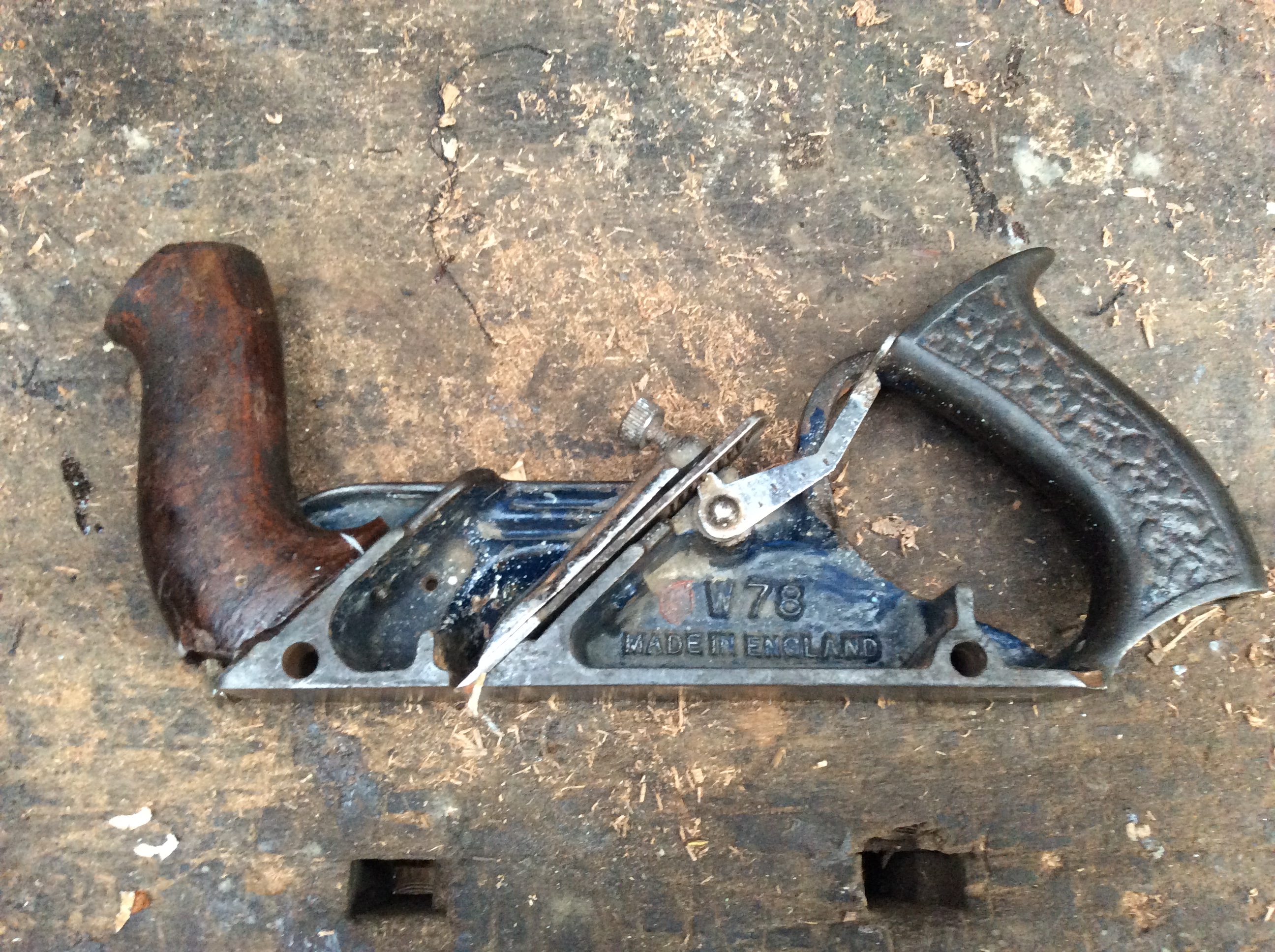

I wad especially impressed with the way Mr Sellers used his Record no. 78 as a scrub plane. I have never liked this plane much, it was reduced in price when purchased, it does not cut very well. It’s a long time since I cut rebates by hand, although often I clean up machined ones, but prefer my wooden skew rebates.

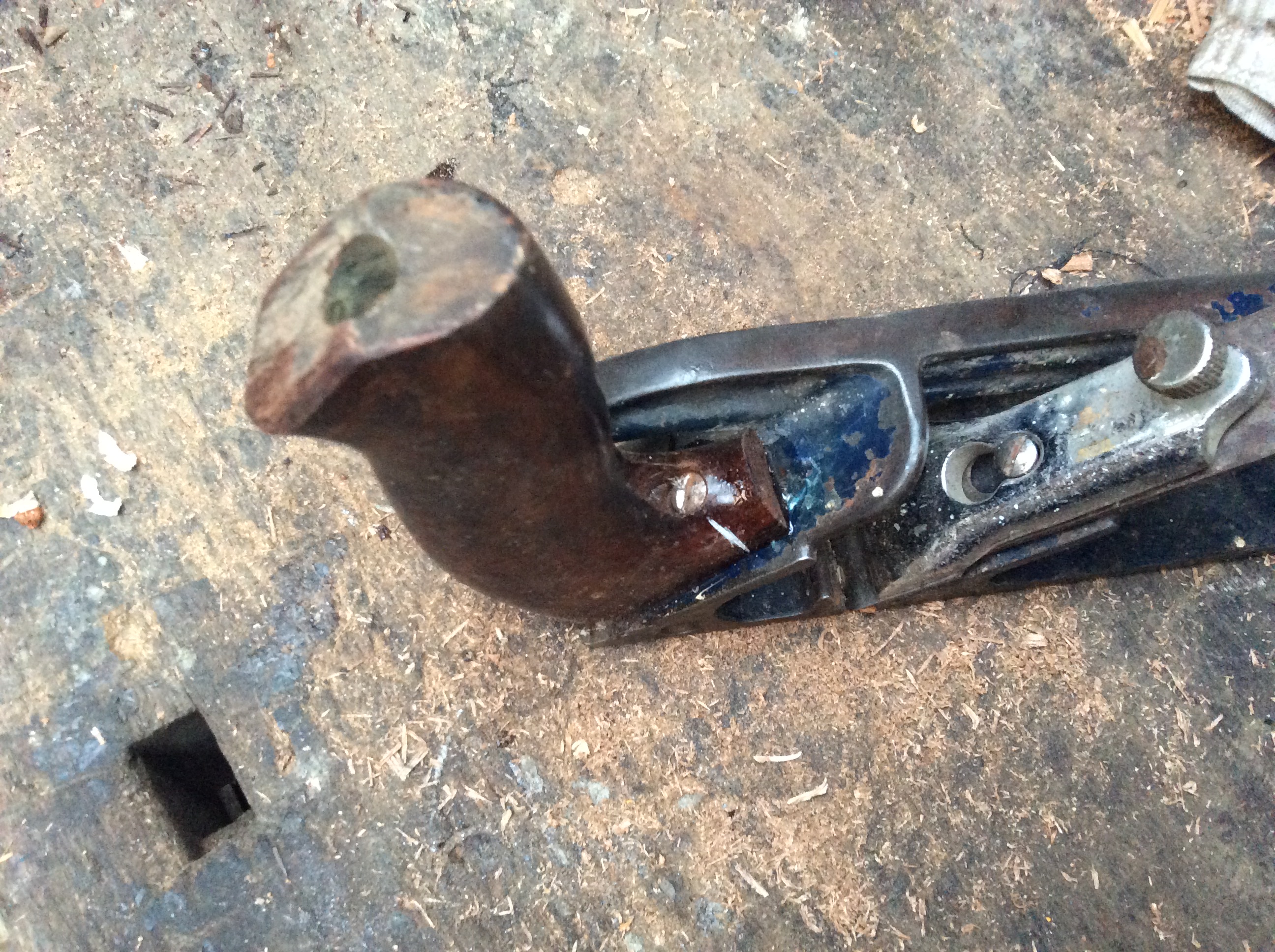

However, I have this Woden 78 which has some bits missing. But I did not fancy using it as a scrub without a front tote. This tote is off my Stanley Bailey 4 1/2, the handle was broken when I got it and with the spur missing, was tiring to use, so I made a new one.
I fitted it to the Woden while the whetstone grinder was cutting the curved profile on the blade. It is screwed and epoxied.
But on the whole I think I prefer the scrub iron I’ve got for my Stanley no.4
