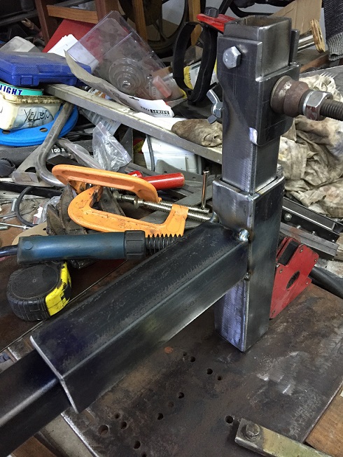

Started my 72 x 2 Belt sander. I am not going to make knives, but I think it can be usefull for all the notching I have to do. The better the fit the easier and stronger the weld. I TIG all my suspension linkages.
Attachment 22935
I did not use square tubing because the fit of one tube into the other is too loose, so I machined down some 50 x 50 x 5 angle iron to give me a nice snug fit for the 38 x 38 x 4 square tubing I use to slide into the other manufactured tube. I inserted some 0.5mm spacers before welding up the angles to form the tube.

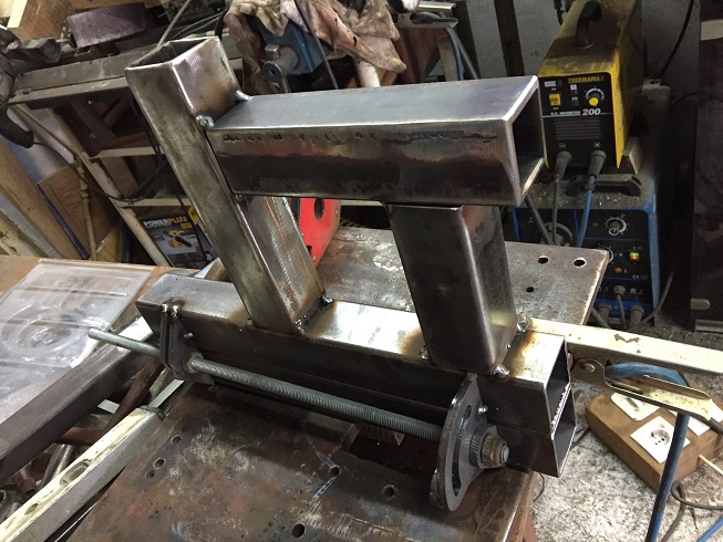

A friend of mine suggested I add some hinges so it is easy to flip it 90 Deg so the belt will run horizontally.
Attachment 22936

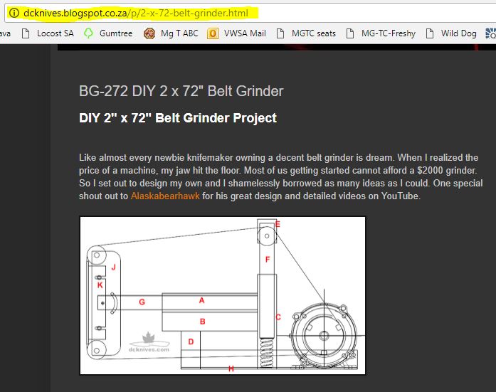

Here is a very nice one and there are drawings and a build thread. Check it out
https://www.hobby-machinist.com/thre...1/#post-536564
Here is another that might fit the bill:
https://www.hobby-machinist.com/thre...2/#post-419497
Good luck and happy building
Nelson

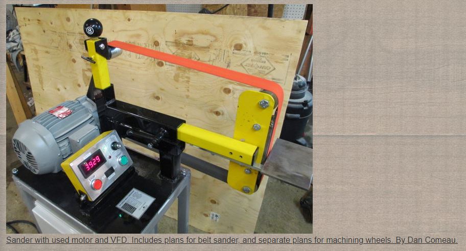

1 Attachment(s)
Attachment 22973
This is where I got my design. Very simple and minimal machining.
Check out our comprehensive page on belt sander builds, including multiple links to plans: Homemade Belt Sander

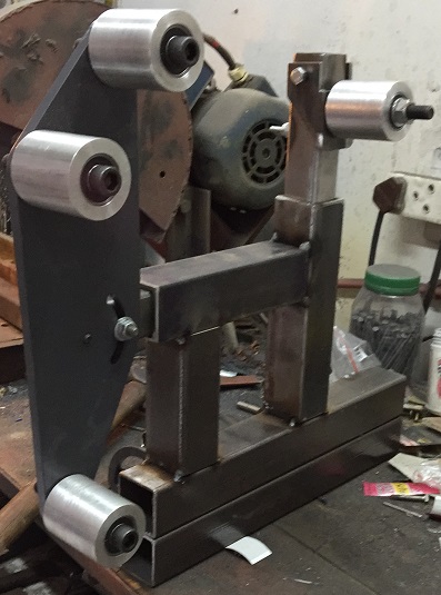

1 Attachment(s)
So I finished off the small rollers. You can see by the amount of thread protruding that I used bolts long enough so to ensure the bearings are sitting on the solid shank.
The next was the drive roller. Before I could machine it I had to decide what motor I was going to use. I have an old 1hp motor that has been lying in the shelf for years, but as I connected it to power to see if it is still running...I was reminded why it is on the shelf...It has a power leak from one of its windings...so I got a good old shock...back onto the shelf with a note on a piece of masking tape to have it rewired.
The next was an old central fugal water pump, but the motor was only 0.25Kw so too small. :headscratch:
Then I remembered a post I red where the guy used a lawnmower engine. I has an old (very tired chassis and grass box) electric mower but the motor is still good.
Upon inspection it turned out to be a 2.2Kw motor and it runs at 2880 RPM. A added bonus was that the method to attach the blade(bolt into the center of the axis) would be perfect for my 4' x 60mm wide drive pulley. I had no idea how I was going to tap a M8 through the 4' pulley (the conventional way to attach a pulley with a grub screw to a shaft). I think my tap is about 1.25' long.Attachment 22992
