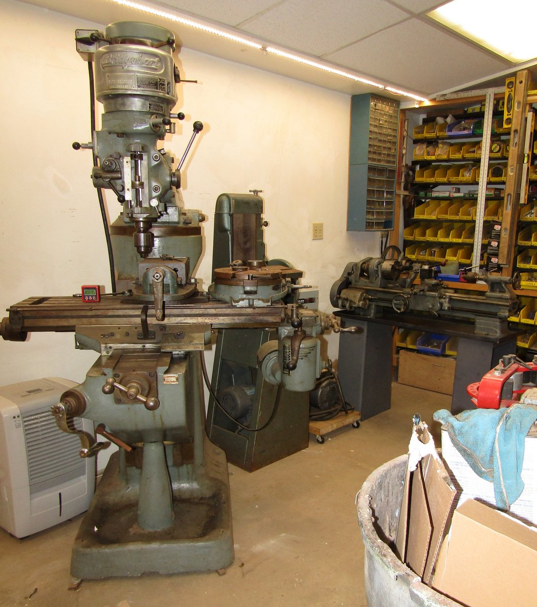

    My first mill - and since I'm a 1963 model, I think it's older than I am! Bought from a Delta Airlines machinist. All-original; BP power feeds, 3-phase BP motor; even the BP vise. Needs to be cleaned, but oil in the lines, not grease, not a lot of visible wear on the ways.
    All works fine and tight; he had been using it and meaning to restore it as a project, but promised his wife he'd try it on Craigslist Atlanta first.
    So I saw it and jumped! Only about 50 miles away. Owner had built a nice 5-hp rotary phase converter for it; more than enough - so now I don't have to discount three-phase tools i run across.

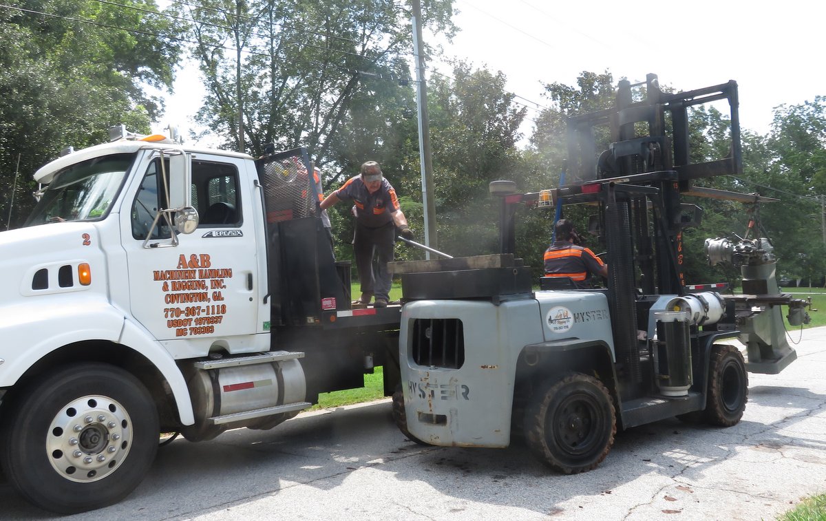

    Also a nice Kamakura rotary table and the big 90-degree mount. Decent amount of tooling; full set of collets. Local place rigged it.

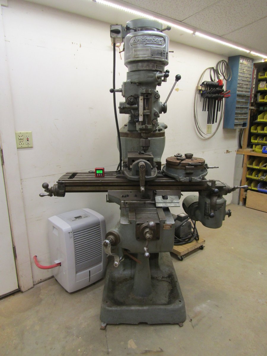

    I'm tight on space, so had to angle it. Got it shimmed level and re-set the head.
    My first Bridgeport - a Series-1! - and an equally vintage 9x24 South Bend lathe!-img_0283.jpg
    This is Georgia, so plumb in the dehumidifier permanently!

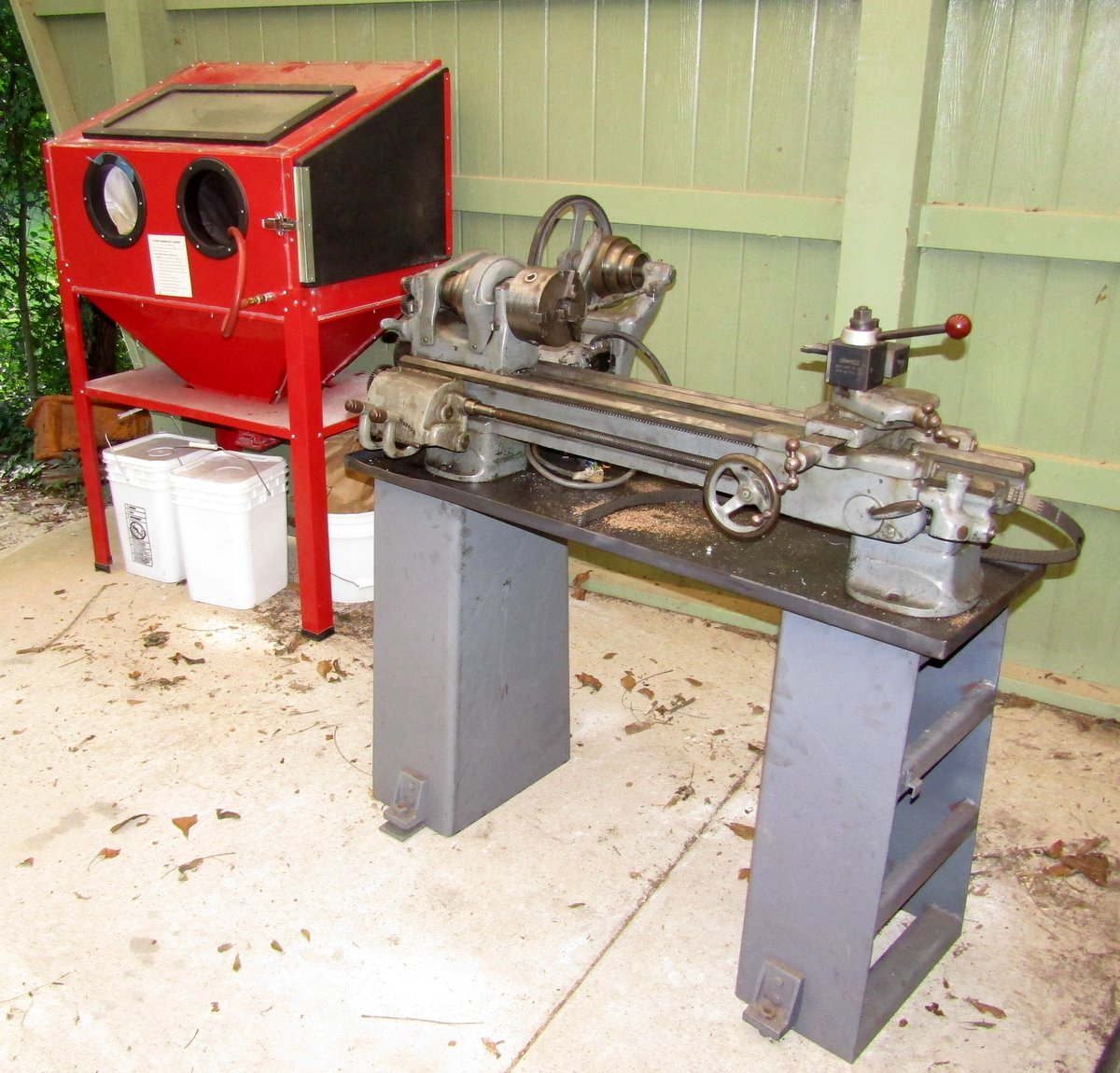

    Lathe - will also be fun to prettify, but all works and is tight and no visible way wear - owner by a motorcycle restorer until last week.

    Congrats there Forrest, my theory is we cannot have too many home machinists.
    The humidifier is fine for the weather, but that's going to be a chip magnet sitting there. I'd hang it, surrounded by a 2 or 3 sided doghouse.
    Angled placement, right side out, is 'normal' orientation, keeps protruding material/ operator from envelope of adjacent equipment. Vises first, ro-tab my go-to for what builds up table tooling next.

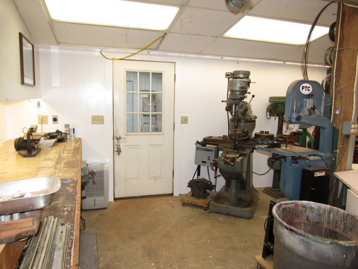

    Okay - lots of good recommendations here - thanks to all.
    • Moved the dehumidifier to the left of the door.
    • Organized that under-table storage area to store the little metal saw - trying to dense-pack!
    • Swapped the drill press and the 6x48 sander to the other side of the shop.
    • Cleaned and patched and painted the wall as an inspiring backdrop.
    • Will make a bracket to raise the phase converter straight up; will mount on the wall to the upper right of the door frame.
    • Phase converter input will go over the door frame; will share 240/50A circuit with the plasma cutter.

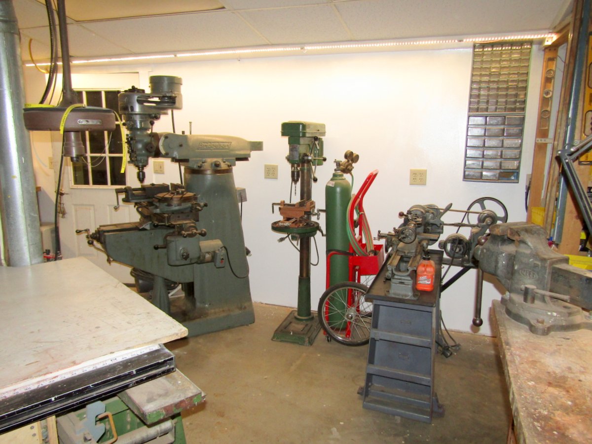

    Last night I was trying to move stuff around to see what would fit and give me sufficient work area -
    My first Bridgeport - a Series-1! - and an equally vintage 9x24 South Bend lathe!-img_0584.jpg
    My first Bridgeport - a Series-1! - and an equally vintage 9x24 South Bend lathe!-img_0585.jpg
    I had to move a Belsaw planer, a radial arm saw, a 14" wood bandsaw, and a 4x6 metal bandsaw to free up this wall - now they're in the way! I think some of my woodworking stuff is going on CraigsList.

    Not trying to run your shop floor layout, but machine tools [with ways] are happier removed from abrasive grit and metal particles flung about. Regarding a million or one million twelve questions; we don't keep tally; let them fly!

    Absolutely. Going to put the drill press where that 6x48 is, and the 6x48 where the drill press is, with the grinders and sanders on the other side of the shop - give me a minute!

    You're off to a good start there, Forrrest. I like the BPs with a short table. I've got a clone with a 42" table. Works great in a crowded shop.
    Along with the others, find a better location for the dehumidifier. And the rotary phase converter would be gathering chips as well.
    Might want to hang that up on the wall with some stout brackets. Some of those make noise, so the higher the better.
