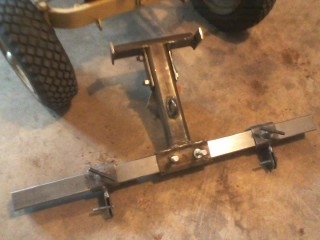

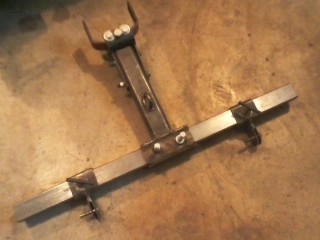

Made a little toolbar for my Allis Chalmers B-110. Made mostly from scrap metal and inventory hardware. The nice thing about this toolbar is that I can use it on the front or back of the tractor.
The basic unit is a 2x2x1/8 square tube inserted into a box sleeve that is welded to a push/pull bar and uses bolts to hold the tube in place. The sleeve and push/pull bar are 2.5x2.5x3/16. The push/pull bar has a hook welded on for lifting.
For tool clamps I made box sleeves with T-bolts and drilled holes in the brackets for connecting pins.
Attachment 19122
This shows the toolbar with connecting bracket and sleeve hitch for the rear of the tractor. Connecting bracket is borrowed from my Brinly box scraper

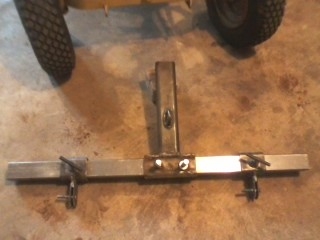

Here is a photo of the toolbar hooked up to the back of the tractor with some ripper shanks I made out of 1.5x1/4

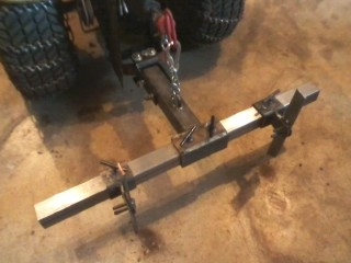

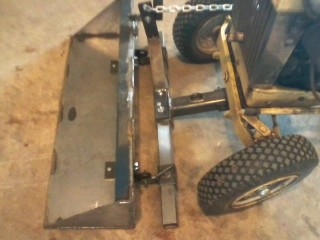

To use the toolbar on the front of the tractor I made another connecting bracket that bolts onto the push/pull bar replacing the Brinly bracket.
Attachment 19125

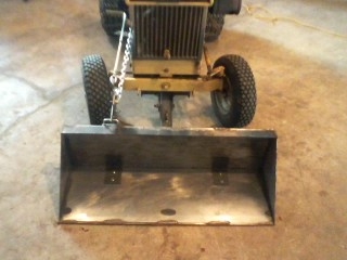

With the toolbar now connected to the front of the tractor, I made a scoop bucket and was able to attach the bucket to the tool clamps, with some store bought L-brackets, as the hinge points.
The bucket is 36in wide, 12in deep, 10in high, made out of 10 gauge sheet metal. There is 2x1/4 flatbar across the front for a lip and also for two reinforcements, under the bucket, which run back from the lip to the the inside angle brackets. The angle brackets are connected with bolts to everything they support.

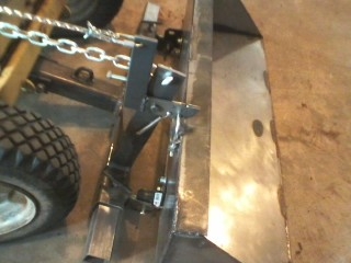

This is the latching mechanism used to keep the bucket upright during lifting. Release the latch and there is an instant gravity dump.
Lowering the bucket automatically resets the latch.

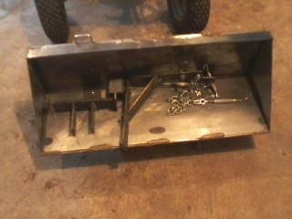

When the scoop bucket is no longer needed, all the associated pieces can be stored inside the bucket, placed on a moving dolly and rolled away for storage.
