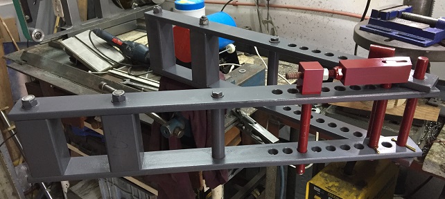

Took me about a year to finish as there is always something more urgent to finish or breaking somewhere around or in the house.
Attachment 23569

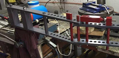

And a few attachments, will make more as I need them.
Attachment 23570
I have made one set of burglar bars. 12 x 12 square bar was no problem. No need to use the extension arm as the design calls for.
Space is always a problem so my lever is detachable.
