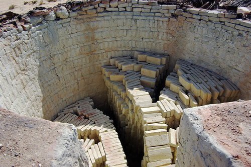

    Another mystery (at least, to me) from our latest Chinese industrial GIF dump. Anyone know what's going on?

    My guess would be they're stacking them in a brick kiln to fire them. Some source of heat (coal/wood fire or perhaps natural gas) below the (presumed) grate on which they rest; heat rises through bricks to harden the clay from which they are made. It's a common process in many parts of the world.

    I'm gong to vote kiln as well. note how the stacks are all gap spaced and in uneven alternating gaps at that this would aid in the circulation of the heat.
    if that is not it then. I have 1 other suggestion. They simply have nothing better to do than stack bricks all day.

    Tunisian Vertical Brick Kiln
    The image (hopefully) attached is of the interior of a Tunsian Vertical Brick Kiln.

    Yep, vertical brick drying kiln. The layout is to help spread the heat around and allow any water vapor and gases to escape up the middle. That layout could indicate a coal or wood fired kiln.

    Most of you have guessed right that this is a brick firing kiln. First job I had when moving to the west country was in a brickworks, these guys were called setters and the unfired bricks were “green”. Our kilns were a continuous process as they were a giant oval and the fire travelled round fed by a coal trickle from above. Drawers would follow and remove the fired bricks often walking on hot ashes. My job was as a runner taking the green ones from the presses 50 at a time, running them to the wicket ways, returning with an empty wooden barrow before the green bricks started falling of the presses.

    After searching for world's largest kiln, I guess kiln does seem reasonable. It's so enormous my brain refused to float that as an option.
