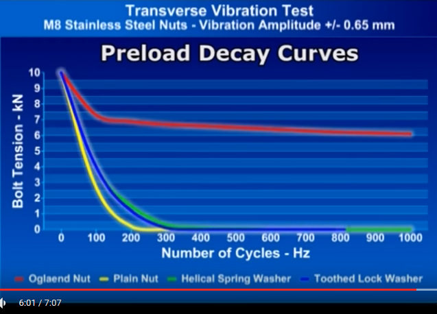

    This video shows the differences.
    Which also seems to be referenced in this article.
    https://engineerdog.com/2015/01/11/1...out-fasteners/
    So looking at the graph they are better than a plain washer but not much. I've mostly seen them used when the clamped material is softer hence you'd not want to tighten the bolt too much and also they would work better in that case.

    Agreed Jon, the moment the nut is loosened, the raised ends of the washer dig in and resist further rotation. Quality in manufacture make some split washers more effective than others. One thing to note is that split washers are not generally used in the aviation industry. Here reliance is made on lock nuts of various designs, usually clamping the threads of the bolt through deformation of the nut or a nylon type insert. Inserts of this type are sometimes inserted into screw threads as well. The best know, and most disliked by aircraft mechanics, is the locking wire system where nuts and or bolts are secures in a tightening direction by stainless steel wire. Moving off the point, there is a right and a wrong way to fit a plain washer. Washers are stamped out and have a 'flat' side and a 'rounded' side. The rounded side should normally be under the nut and the flat side, which might have a bit of a feather on the edges, should be sited towards the casing secured.
