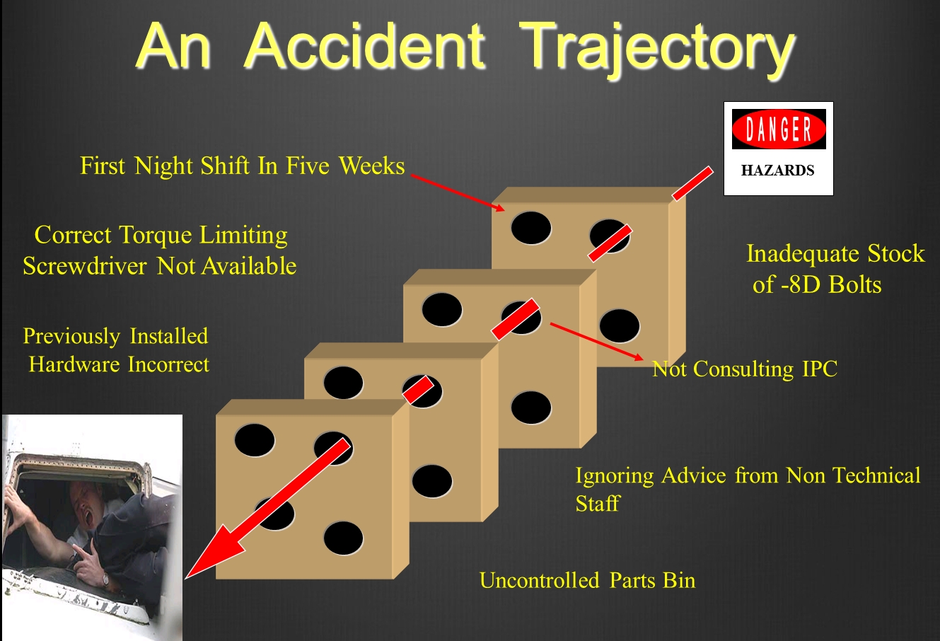

Some screenshots from the PDF link above:
https://diqn32j8nouaz.cloudfront.net...er_design1.jpg
https://diqn32j8nouaz.cloudfront.net...er_design2.jpg
https://diqn32j8nouaz.cloudfront.net...er_design3.jpg
https://diqn32j8nouaz.cloudfront.net...er_design4.jpg
