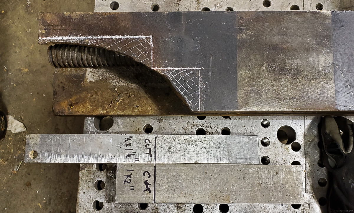

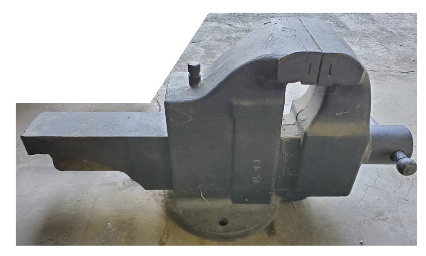

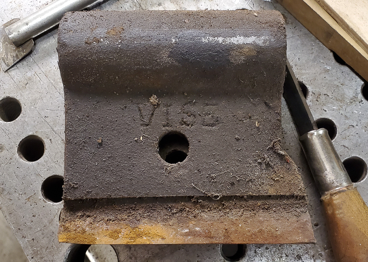

    So today I got an American Scale Co. #78 vise for $275, just a touch under $2/lb so not too bad.
    Especially since it has the swiveling jaw! Yipee!
    It has 6" wide jaws in almost perfect shape.
    No pipe jaws, but I'll put with that.

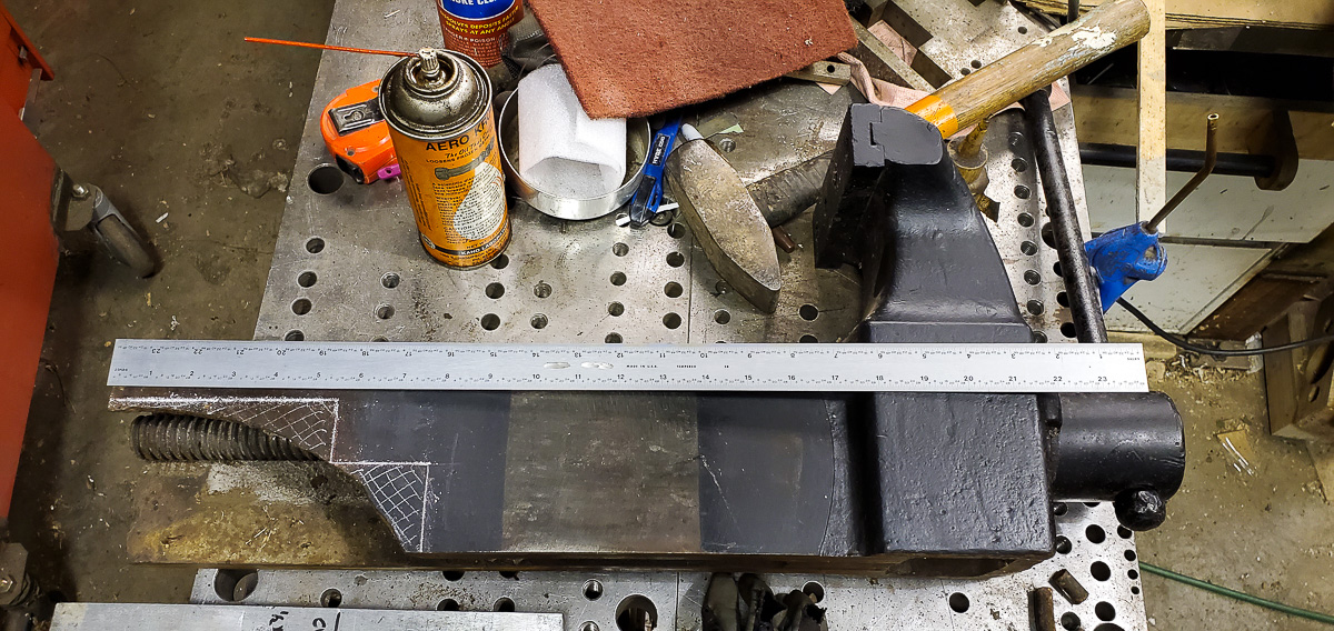

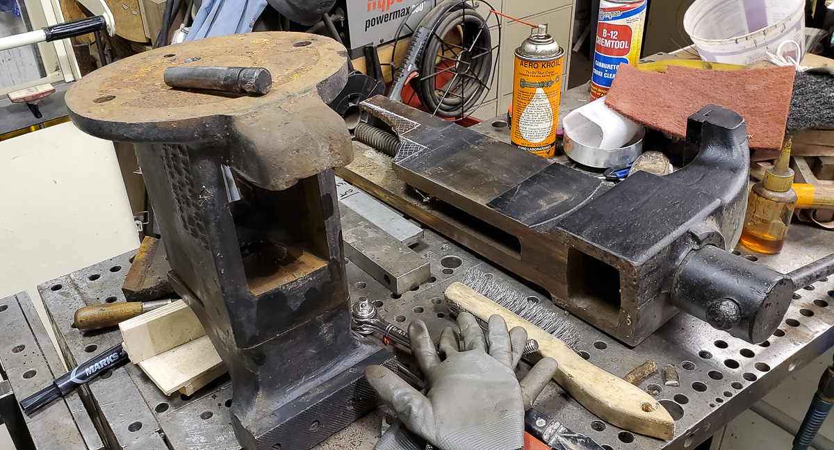

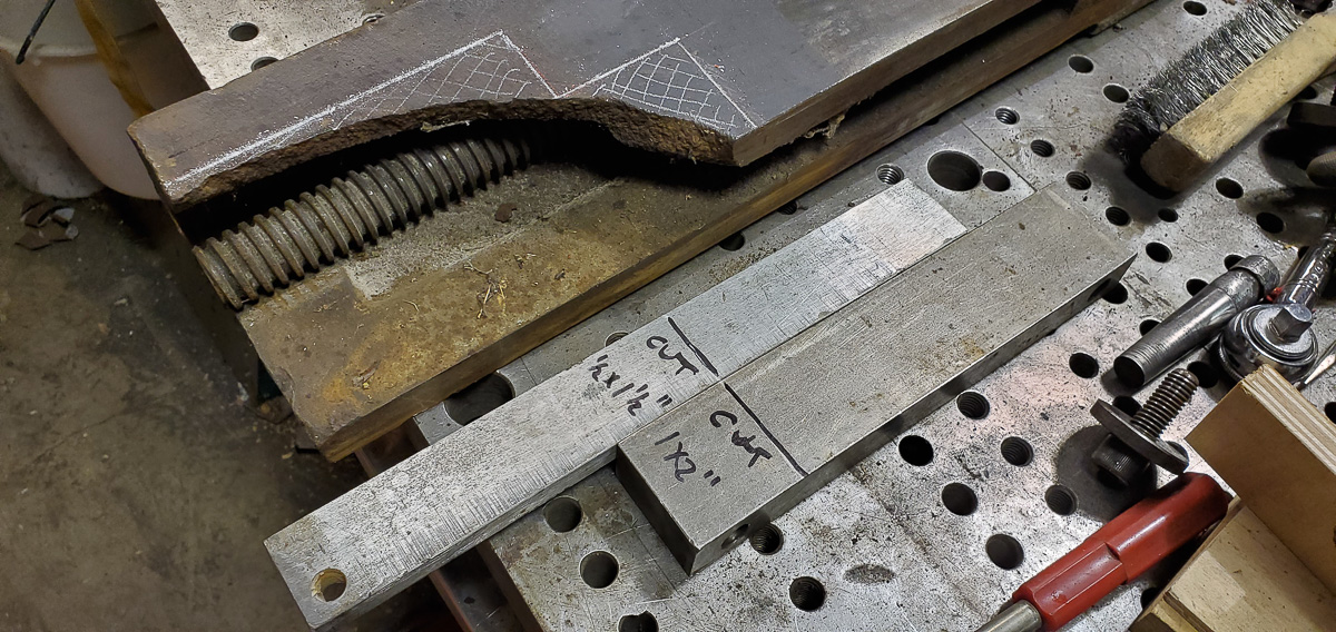

    The rub is, the slide is broken as you can see.
    My plan is as shown in the pics - to cut the break square, chamfer everything nicely and oxy/acetylene braze in the steel pieces with flux-covered brazing rod.
    I'll MIG weld the two steel pieces together first, and drill them and the slide in two places (tapping the slide) so I can bolt it up before I go to braze, so nothing drifts or shifts.
    Does this sound like a sound plan? Or does it look a bit dim?
    From rooting around the web-O-tropolis, it seems that pre-heating a bunch helps, as does cooling it VERY slowly.
    I'm really stoked to finally have a monster-killer swivel-jaw vise.
    BTW: I love that the vise nut has 'VISE' cast into it.
    Thanks!
    The pic from the ad:
    On the bench:

    I take it that you don't have the missing bit? I can see nothing wrong with the plan. Have you thought about replacing the missing bit with Cast Iron?
    There are usually old stoves kicking around somewhere with Cast Iron sides that would be of a thickness close to what is need although a piece that had to
    be machined to size would be best.
    Cast Iron is not that hard to weld with Oxy/Acet. Abrasive blasting and cleaning the weld area, using the correct flux and pre and post heat are necessary.
    Most welding shops sell bare Cast Iron rod which is easier than old piston rings, broken scrap etc.
    The advantage of welding/Brazing with a Cast Iron rod is that it machines the same and the colour match is perfect. Stippling with a needle scaler or a light sand after grinding/machining to conture makes the repair undetectable.Datasheet_MG240 Bare Cast Iron Rod.pdf

    Nortie,
    Yes that missing bit is missing.
    I've got the steel stuff on hand and the repair requires two different thicknesses.
    So I'll try with what I have on hand.
    Color is of no importance to me, so brass-type brazing it is!

    Rounding the edges of your patch would surely relieve stress when it cools down,especially that you are not using cast.......for the insert ?

    eye wood, add some addtional reinforcements after fitting the missing part, so as to take some strain off that area.

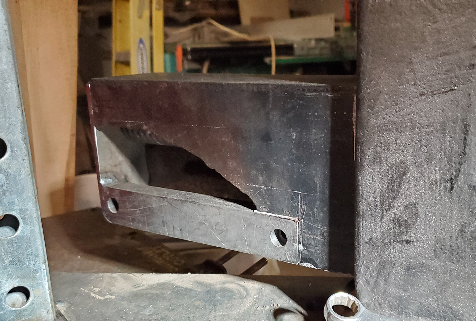

    Update: I got the vise 'fixed'.
    I say 'fixed' because after thinking about it a while (always good for me to do before diving in like a drunk diving into a frozen swimming pool).
    I realized that the back corner makes no difference really, when the vise is clamping, the force is on the top of the slide, not the bottom edge.
    Yes, the sides give the bending strength so the slide doesn't bend or break.
    If I simply avoid putting big things in the vise and jumping up and down on the handle to tighten it, I can live with a less-than-like-new solution.
    Here's a cruddy shot of it (the vise is mounted now and it's hard to see that back side of the slide)
    I attached a hunk of 3/4x1-1/4 to the slide with a 1/4-20 SHCS, and then welded the end cap on and put three more 1/4-20's through it into the slide.
    It works!
    Kinda (rather!) lazy-boy slummo solution, but it made me happy. (low bar there!)

    eye wood also add a patch over that broken portion, possiably screwed or welded or both.remember **** happens....especialy when you expect it least and need to get it done.

    JB Weld!
    That's the ticket!
    Maybe with some fiberglass cloth thrown in for good measure.
    I'm bein' kinda silly here, but now I think about it...
    Makes perfect sense.
    I'm on it!
