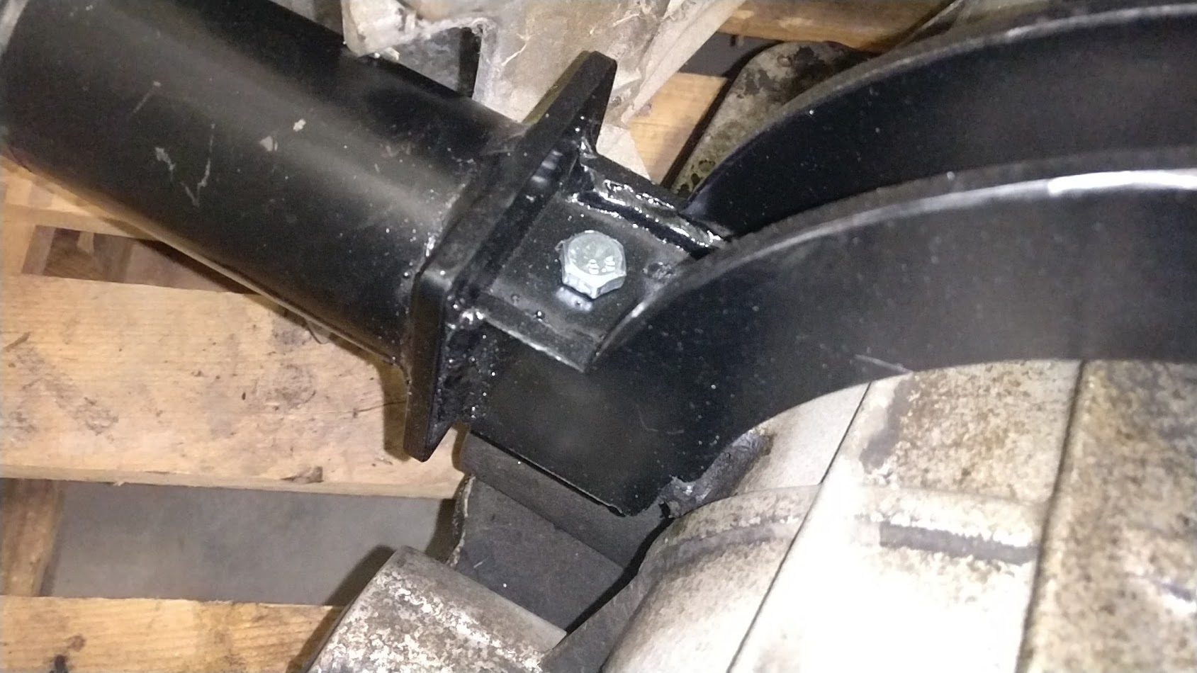

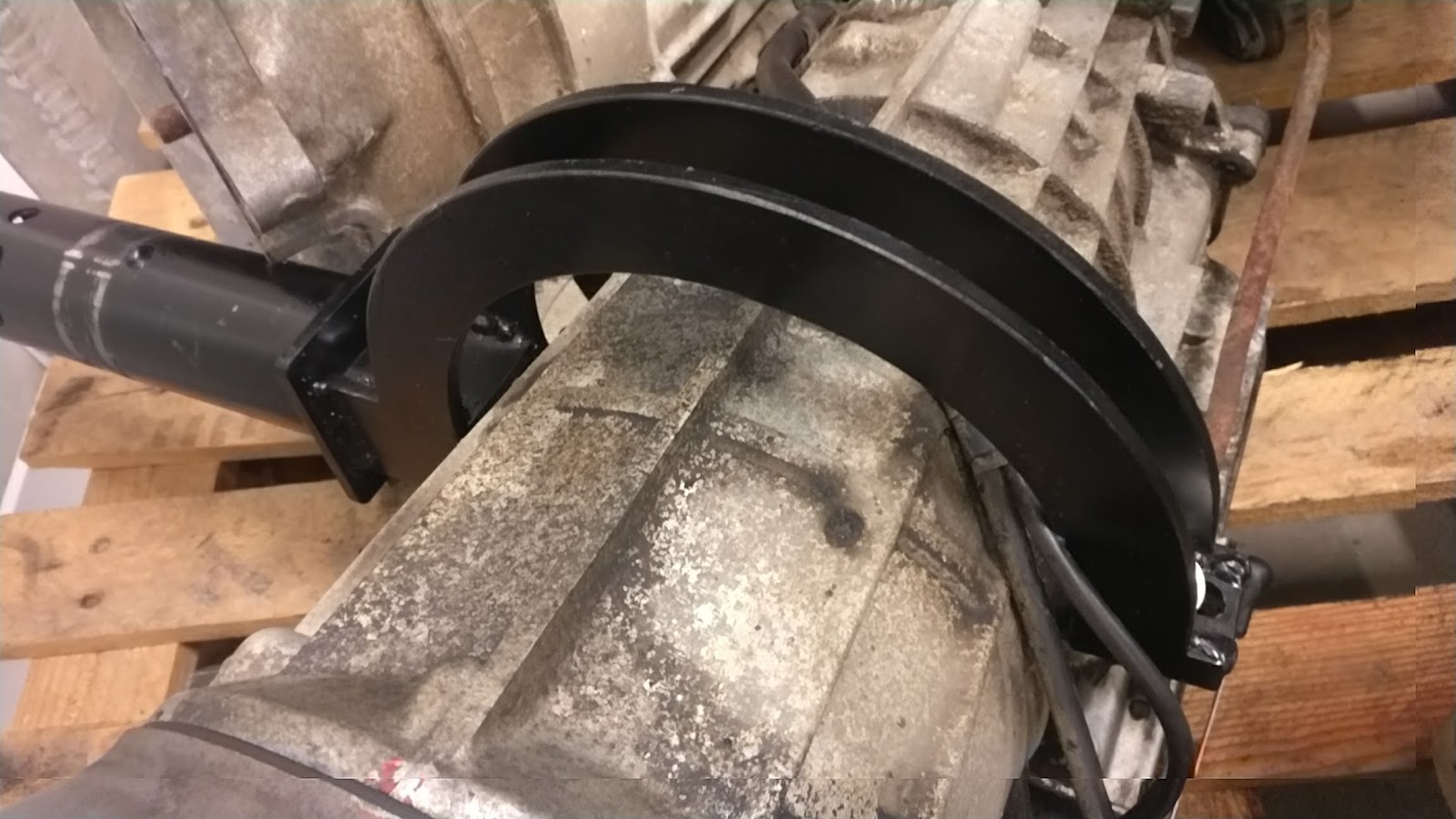

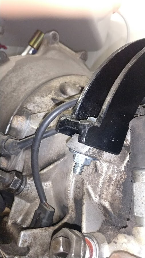

    Ford A4LD transmission stand
    Pieces are cut with laser, and welded. Normal 5mm steel, and pipe 60mm fits basic engine stand. This transmission has hole on the other side, bolt is through it. Other side protrusion is clamped between two steel plates. I have dxf files for cnc cutter, but they need modifications to fit different transmission.
