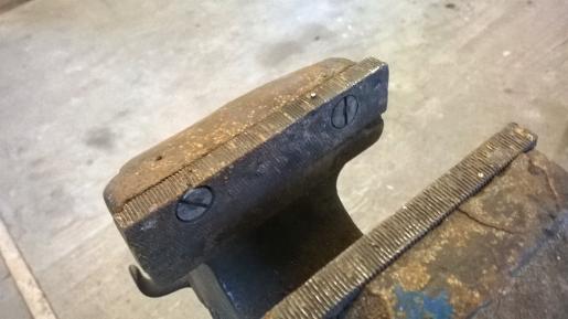

    record vise jaws replacement alternative using a metal file & heat to drill mounting
    Quote Originally Posted by Eugene's DIY Den View Post
    This is a record No. 6 vice, an heirloom from my grandfather. The jaws had become cracked over years of use. I have a collection of lots of old files and reckoned they would be ideal for making replacement jaws. Files are made from hardened and tempered steel, and have slanted, ridged teeth which I reckoned would be excellent for gripping stuff in a vice. I cut out rectangular sections of the correct dimensions using an angle grinder. The steel was too hard to drill, so I had to anneal it by heating to a red heat with a blow torch in the vicinity of the mounting holes and allowed it to cool slowly. Once the holes were drilled, they were countersinked.
    Attachment 4131

    Now that I have that off my chest, here's something I believe I saw in Home Shop Machinist magazine; take a standard masonry drill, with those carbide chips in the front, and sharpen the tips up a bit (you DO have a diamond wheel, of course...?), then have at it!
    The guy who wrote that little "How-To" had a photo of a file with a few nice round 1/8" or 3/16" holes through it!
    I haven't tried it on a file, but I have done it with some steel of unknown composition which wreaked havoc on my standard bits.
    I have even picked up some masonry bits I ran across, which appear to have good sharp edges to start with, but I haven't tried them out yet.
    Attachment 4131
    I don't know if that is sacrilege, or genius. I'll go for genius! I don't have any files large enough to do that to either of my large vises. I may have to give it a try with the Panavise and Wilton that's similar to a Panavise, and now I need to start looking for some larger files, too.
