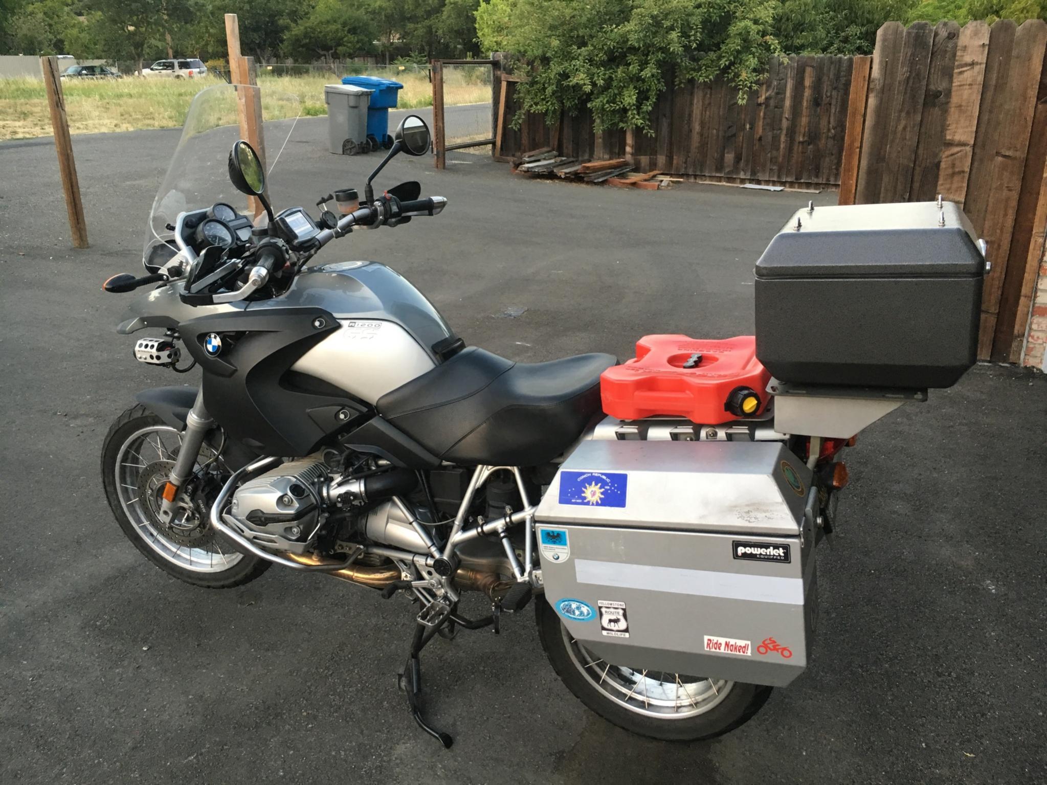

    I have (several) GS's and I use the Rotopax for aux fuel cells. I have had the big adventure tanks, but I tend to fill them up and they become very heavy on the front, so the square easily stackable 1.8 gallon fuel "cell" is perfect. I can still stack a load of gear (even an occasional passenger) on top of these well built and DOT legal fuel cells. I have used and made other types but these are by fare the best way to go...because inevitably I run out of gas, so I can easily detach the RotopaX and get it filled. Plus you can stack other RotopaX cells on top (i.e. water, first aid kits) CHeck out there website: https://rotopax.com/
    I manufacture and fabricate for a living, but if I can buy something that is as good or better than I can make, then I can use my time in other ways. Hope this helps. See you down the road. new member-img_0099.jpg
