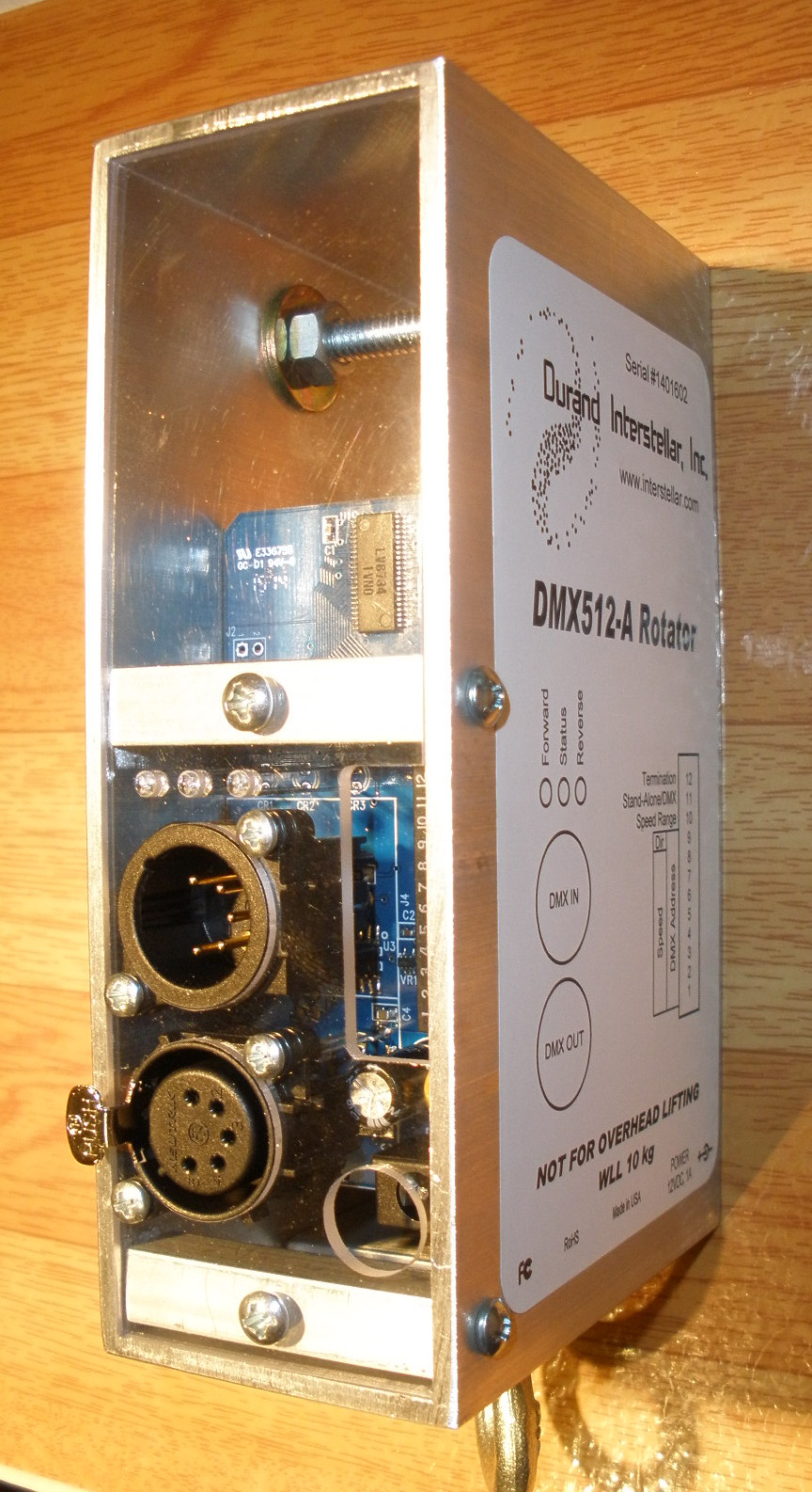

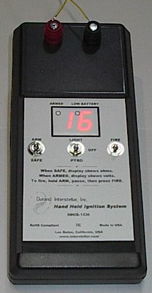

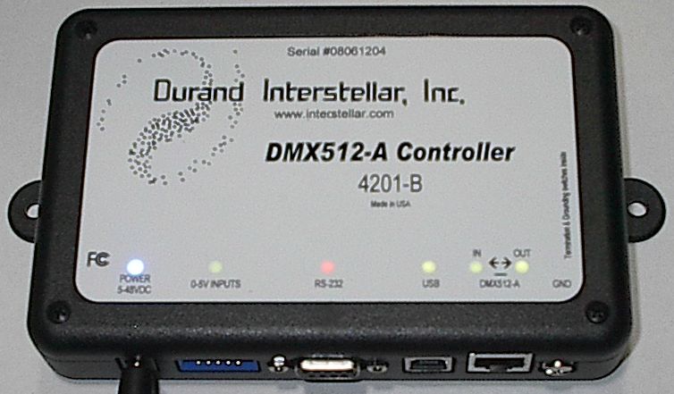

#2 I found polyester laser printable labels. Depending on your laser printer toner sticks better or worse to these, try to not curl or bend after printing. LEDs will shine right through this so you don't even need holes. The labels are water proof, I have some around 10 years old on our gates telling people to not let the chickens out...still in good shape. Here's some samples
Attachment 38360
Attachment 38361
Attachment 38362
