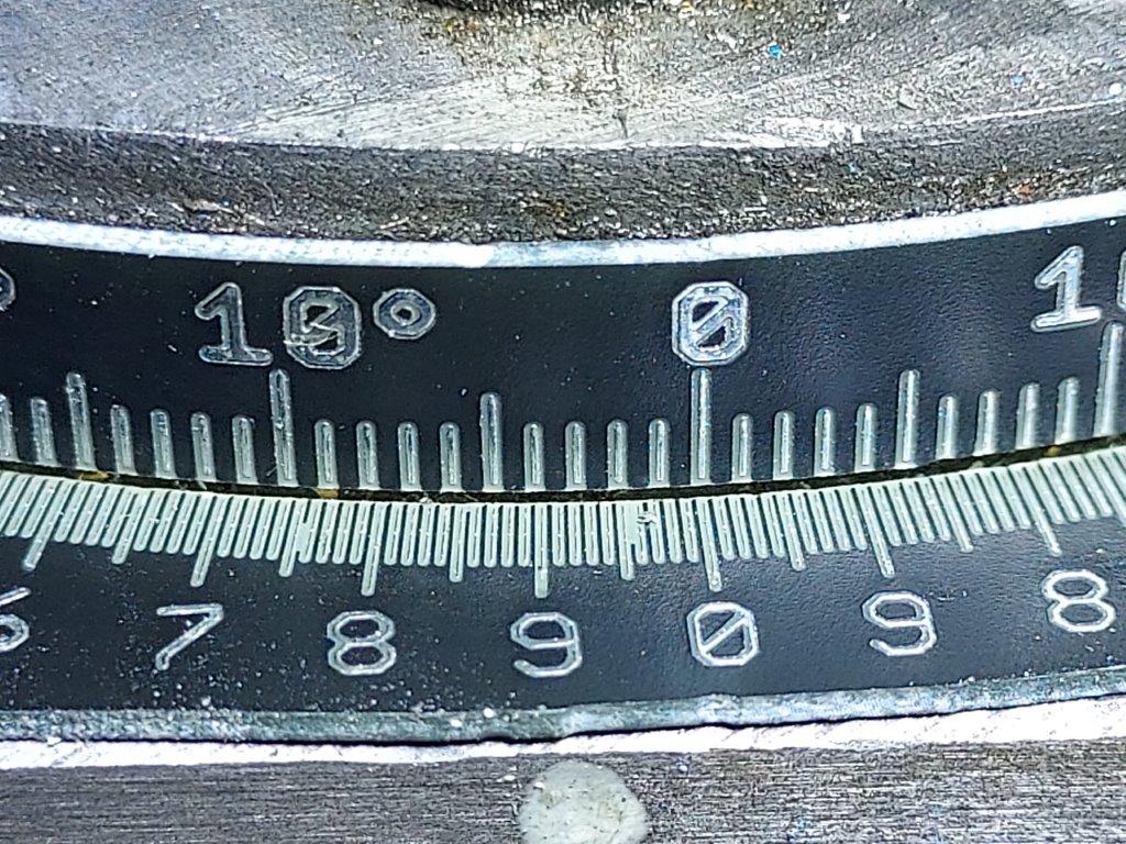

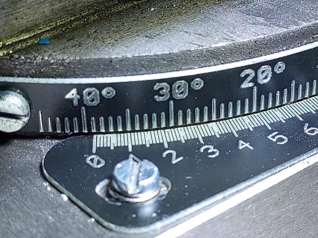

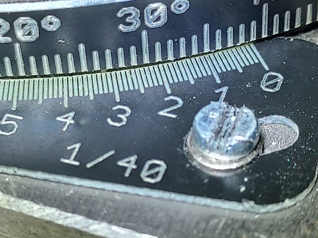

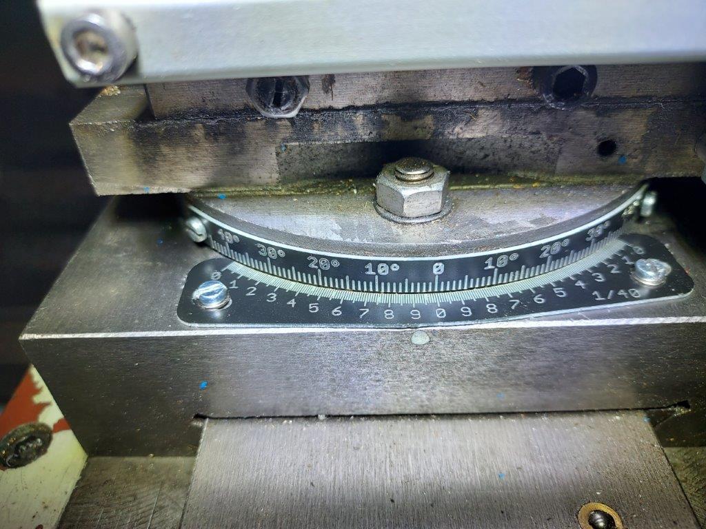

Hi,
I just received the new scales, I ordered due to wrong marking and changed them at my lathe.
Attachment 44618Attachment 44616Attachment 44619Attachment 44617
