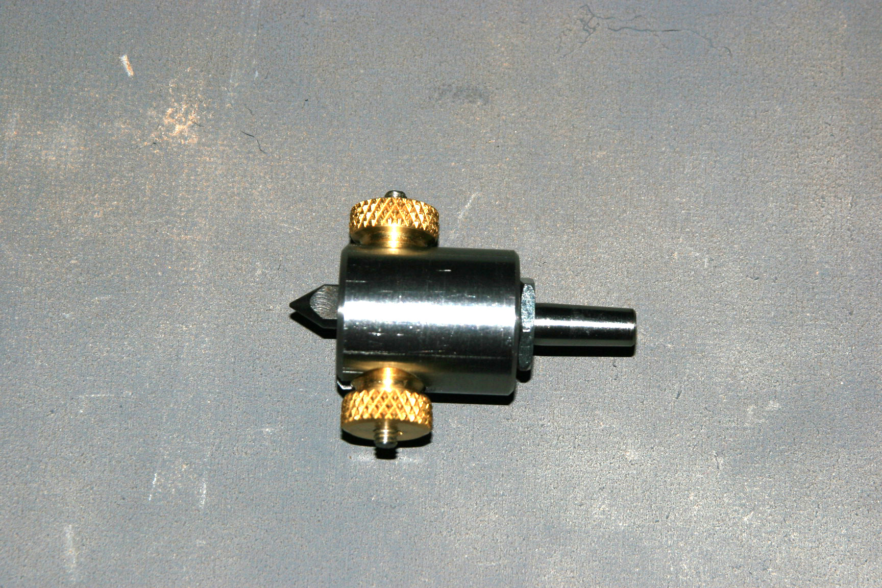

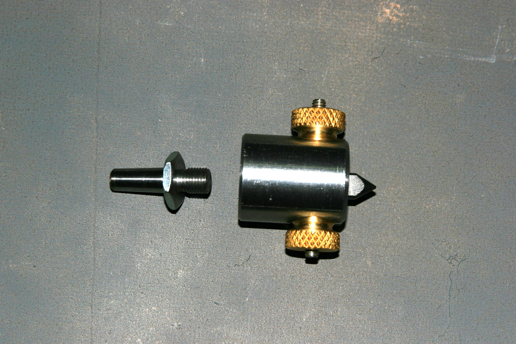

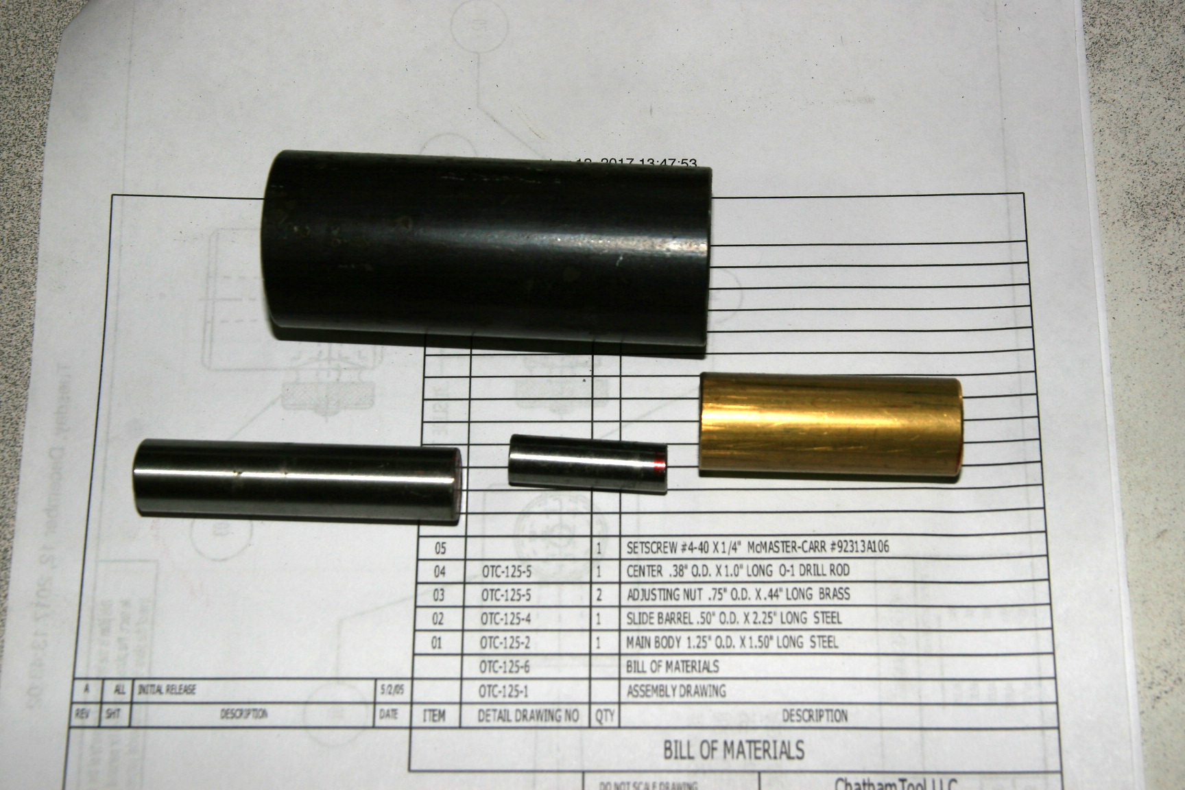

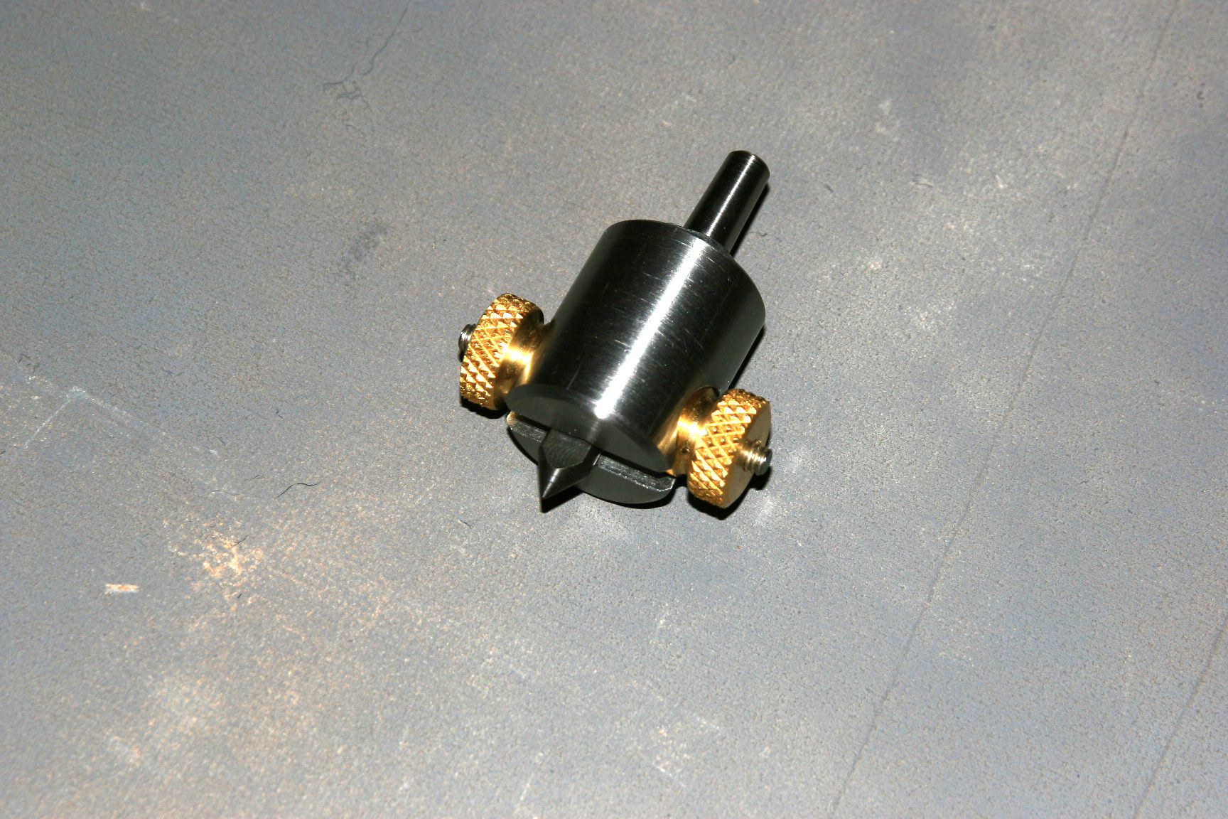

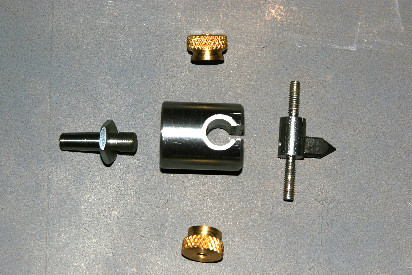

    Plans are available in the Plans section of Homemadetools.net.
    Nice job on the plans and instructions.
    Here are a few pictures of the materials and the build.
    Thanks for looking, JR

    Nice Job JR! Is that taper attachment part of your Sherline equipment or did you make that too?

    Hi PJ, the method I used for the taper was just to use the rear mounted compound slide with the inverted tool bit. Worked like a champ. The compound was purchased as part of the Sherline lathe kit.
