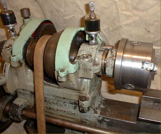

I suspect this lathe is a Portass. There are some similarities. The cover of the reduction train gears are identical. The support of flat pulleys is also identical.
however the bed and feet are quite different.Attachment 31984Attachment 31985

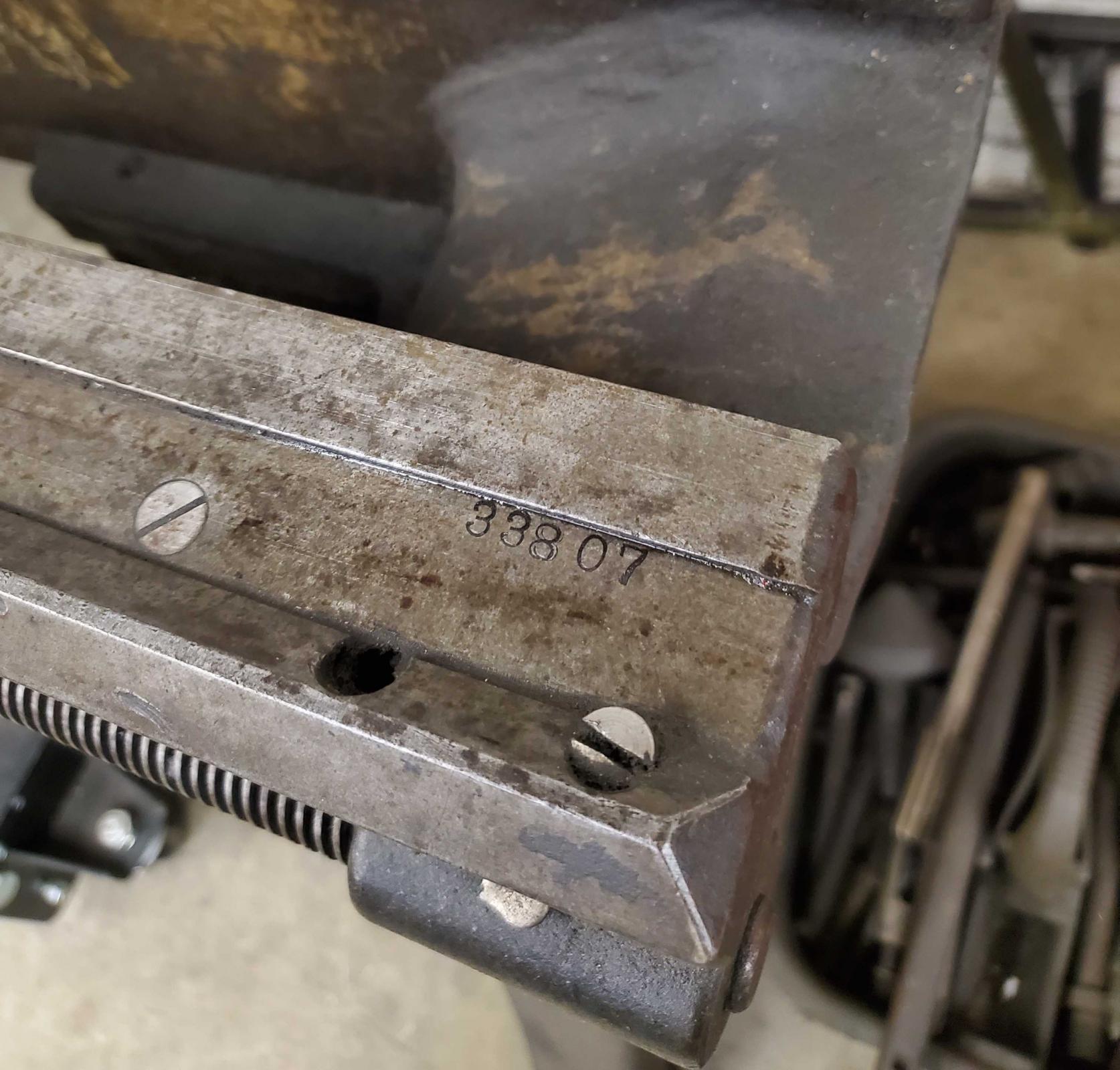

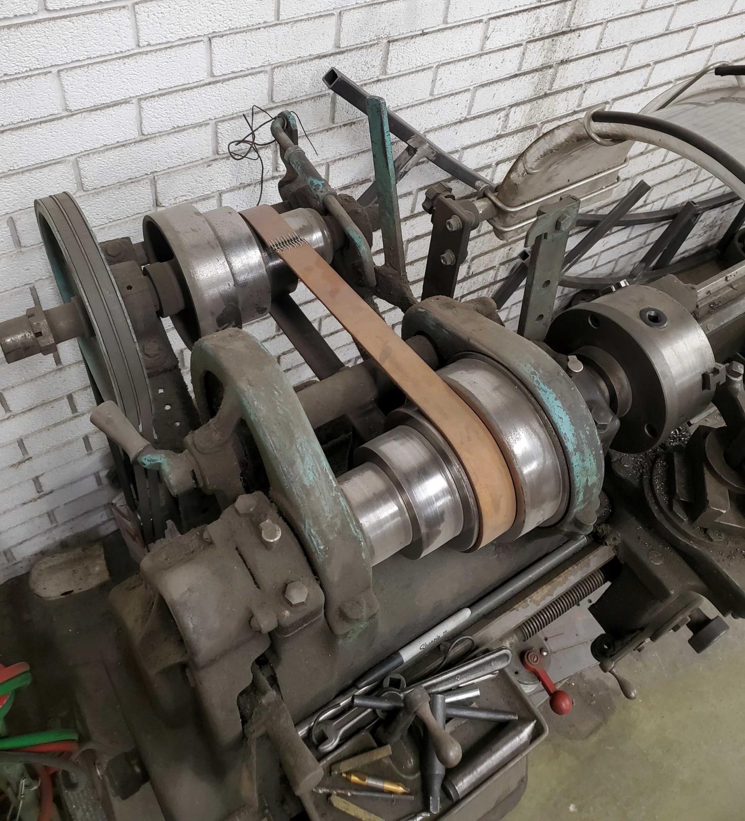

It appears you have a Brazilian lathe actually made by a company called Sociedade Technica Bremensis. I found an actual reference from a book called "Brazil In The Making" published in 1943. They reference them as a machinery manufacturer. (https://archive.org/stream/brazilinm...0jobi_djvu.txt) Again, given that there is so little information about the company or the lathe, you probably have, if not a great piece, perhaps a museum piece from the Brazilian Industrial Revolution. As far as being a South Bend Lathe copy, there were many similarities in lathes of the time as nearly half (47%) of the lathes in the United States and at one time were made by the South Bend Lathe Company. They started in 1906. Our company has a lathe from between 1921 and 1931, judging by the number only serial number 33807 (see pictures). To me, the drive belt tension system seems quite different but like I said in an earlier post, it could be a "Frankenlathe" built from different machines or different designs. Anyway, You might have an historical piece of machinery! Hopefully you can confirm some facts to be sure.
