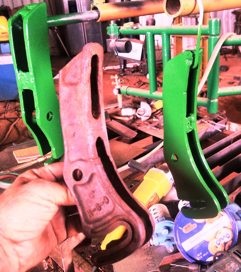

One of the local farmers broke 1 of his shank adapters on his 60 year old Jonh Deere cultivator plow the sad thing was half of the pieces that broke off were lost so no chance of welding the old cast iron piece back together for him
I made him a couple of new ones

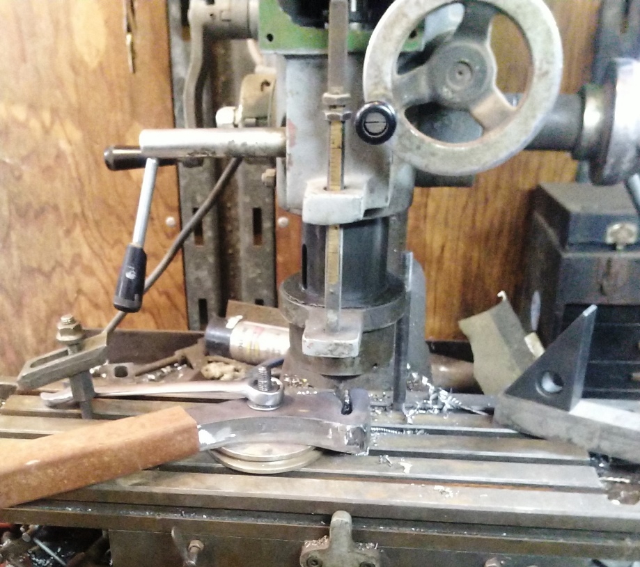

After dressing and tacking the 4 side pieces together I locked a T bolt to the mill table then used it to hold them at the pivot point to clean up the radial slot
Attachment 45585
A functional match to the cast original
Attachment 45586
