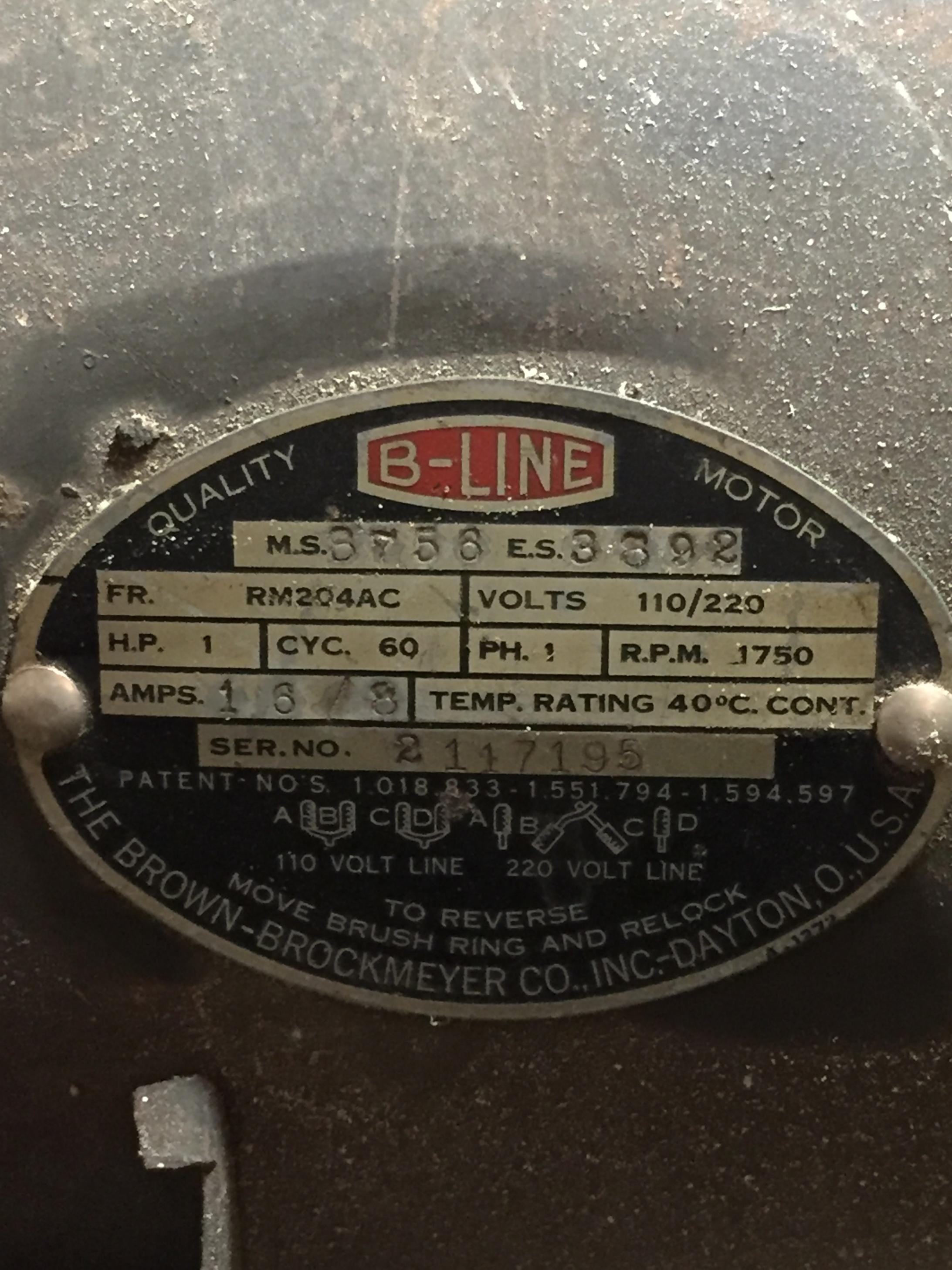

    Ran across your group because I am looking to turn this B-Line motor into something useful for my workshop.
    The motor is currently in a piece of Sh*! table saw configuration. I am looking to make a functional belt/table sander out of it.
    Any suggestions?

    It seems you have a very good motor if works ok. Those motors were built last. From what I could see on the plate, it is a 1hp motor. That should run a belt sander ok. You might have to play with pulley setup to get the speed you need. Other than that good luck on your project. That motor takes a lot of amps for start up. You might have to use a 20 amp for it.

    Hi Rommel, The motor seems a good one but has a high start current (check house wiring and trip switch ratings). I would buy a purpose made belt sander and possibly convert the table saw to a really decent sized disc sander. Good luck.

    That 1HP motor will have a high starting draw, so be sure to match it to the right amperage circuit (20A min.) you'll need to find a good mandrel with bearings for your project and that can be a pain... You may also have problems removing the pulley(s) from the motor as they sometimes end up heat fused and may take some heat to break them free again... Just be careful not to overheat the armature windings...

    Hola Rommel, que decir que no te hayan dicho, buen motor eso si como dicen en el momento de arranque te consumirá apro. 15 Amperios luego si es en 110 VOLT. trabajará con unos 7 a 8 amp. es conveniente una conexión directa al Tablero General de tu casa para no afectar la instalación eléctrica, una llave termomagnética de protección adecuada a su consumo y la correspondiente descarga a TIERRA. Realizar esa máquinaria te llevara buen trabajo, suerte en tu proyecto será hasta pronto.
