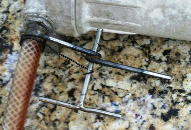

    The next time you're in a home improv store, buy a cheap water meter shutoff wrench. They make dandy hose clampers. Add a roll of tie wire (or electric fence wire if you want galvanized) and you're set for hose clamps for a very long time.
