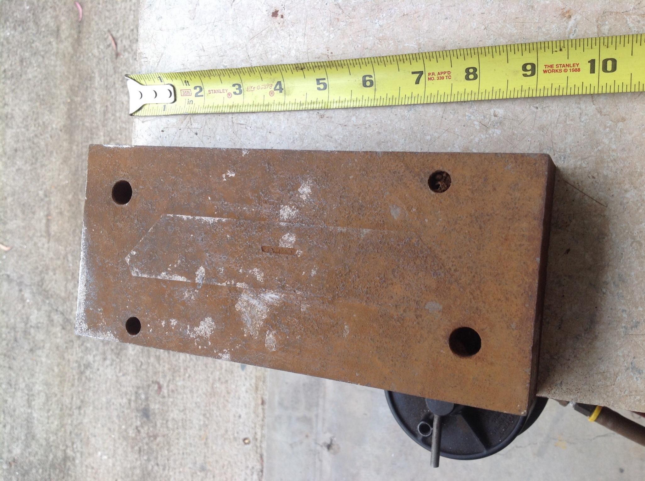

    I'm hoping my junkyard dog self hasn't bit off more than I can chew.
    I found some great scrap metal on CL yesterday on a piece of solid 1 1/2 X 1 1/2" bar and the guy had another piece that was 9"x4"X1 1/2" . Said it was possibly a die as he said there was some holes and a pattern on it. It was so rusty I was dubious, but it looked like it would be a good chunk for a project so I gave him $5 for it. Got it home and I'm not sure what it was used for but there is a hint of a pattern on it. But the main problem for me is its certainly hard! A file or hacksaw won't mark it, doh! Can I somehow anneal it so I can repurpose it or do I have a anvil/paperweight?

    Heating this to a yellow orange heat (forge or rosebud torch), pack in sand and let cool slowly!!! Now its annealed. Project idea, polish the area outside the pattern so as to have an interesting line pattern, and polish the center area to a mirror gleam. Spray with a clear finish to prevent rusting. Drill two holes to mount pen holders (stationary store), one each side of the center design, and glue a piece of old mouse pad on the bottom and you will have a kick-ass desk accessory that will not slide around on your desk and keep pens (or drafting pencils) to hand. Perfect for the man cave, or shop desk.

    looks like this has been a plate behind a steel punch, could explain the hardness of the metal and the indentation. By the way, You paid a fortune for it as a piece of scrap. If i were to posses such a piece of metal i would put it back to work in its original capacity. Build a hydraulic press and some dies. Its nice to see stuff being up-cycled, its such a shame things are getting harder to find and the dreaded Ebay is turning to expensive poop. I have just spent two weeks depressed as i gave an old overhead milling attachment off my Chinese lathe to the scrap man years ago as it was useless as a miller on the lathe and took up space, I have now realised i could have made and engineers floor standing pillar drill with it - with an MT3 Taper for big drills. i had need of such a drill two weeks ago. (I thought poop and fatherless child to myself). looking at pillar drills or in fact any old machine shop machinery in the UK now is a very expensive game, even second hand. hence my advice on your find - don't be in a hurry to disassemble it.

    I agree totally with your observations and am always trying not to shoot myself in my future foot. It's been a big change for me to move to a mostly tourist area. There is small industry but not a lot of heavy manufacturing. So metal supply, especially small pieces are hard to find. I'm still trying to make connections as there are few welding shops, even fewer machine shops. Everything starts at 5' long at the closest dealer so I would had to spend over $150 and then would have to sit on the rest of it.
    I don't have a hydraulic press or do any punch work. I have a 3tn arbor press that so far does what little press work I need. But I do have a project in mind for this chunk. A mod of the current Tony Faole ball turner. The trick is to anneal it so I can work it. I have a small set of tanks so I don't think the rosebud would work, and I don't have a forge. But maybe it's time to rig something with charcoal, a brake drum and a blower?

    MeJason T is correct the plate does have the appearance of having been used as a bolster plate. As for paying too much well .33 cents a pound in today's market is not out of the range for used steels or cut off drops I visited a metal place a while back and thye had gone to .60 for drops and $1.00 for any cut shapes they thought folks might want.
    Trike road poet is on the right track for annealing however this process is not quite as simple as just heating a hunk of metal to 1650°f and packing it in sand. while the method does work it sometimes is not optimal for thicker or larger pieces of steel.
    First off the metal needs to be heated evenly and slowly all over then held to a specific temp for a period of time. The length of time depends on shape , size and type of steel. A good starting point when the grade is unknown is to bring the steel up 50 to 100°f per minute in an oven until the desired temp is reached then held there for at least half an hour per half inch thickness then turn off or remove the heat source form the oven and leave it in the oven until the temperature is below 450°f remove and allow to air cool. this will fully and evenly anneal most medium carbon steels
    However most of us do not own or have access to an oven for this process the next best would be a charcoal grill build a large fire in the grill as if you were going to grill a 72oz Amarillo TX sized steak. let the bed of coals get fully red put the steel directly on the coals and cover it with more burning coals close the lid making sure to have really good air circulation to keep the coals burning and forget about it until tomorrow.
    The last resort method would be to use a #10 or larger rose bud torch act. or propane actually propane is better for this because it is cheaper make the flame as large as is sustainable with a minimal oxygen leaving a long neutral flame blue feather not orange place the metal on another thick steel surface or support it on small diameter pins about 4 inches above a steel surface or fire bricks so you can apply heat all the way around if placed directly on the surface be aware that this surface is also going to be heated very hot if this is a work table the table may become warped even if as thick as 1/2" Wave the torch all over the part and slowly bring it up to 1650° or just becoming almost orange all over keep it at that heat for at least half an hour after the color has stabilized all over. then place a 4 sided structure around it and fill with heated sand or lime, forget about it until tomorrow. Your steel will be as workable as can be.

    Thanks Frank. I was hoping you'd join the discussion. Especially because I knew you'd have several options for getting 'er done. Sounds like my best option is the neighbors huge homemade BBQ grill. He was very receptive to doing your process for seasoning our cast iron pans in it so doing this for annealing this should be ok.
    So, like a 10lb bag of charcoal would be enough? Or 20lb?

    I forgot to mention that you will most probably need a small forced air source at least to get the hunk of steel up to temp. and once at temp just pile on more charcoal over the top of it you should them be able to remove the forced air a common hand held hair dryer should be enough you don't need to try and make it bright cherry or near white hot since you probably are not going to re shape it.
