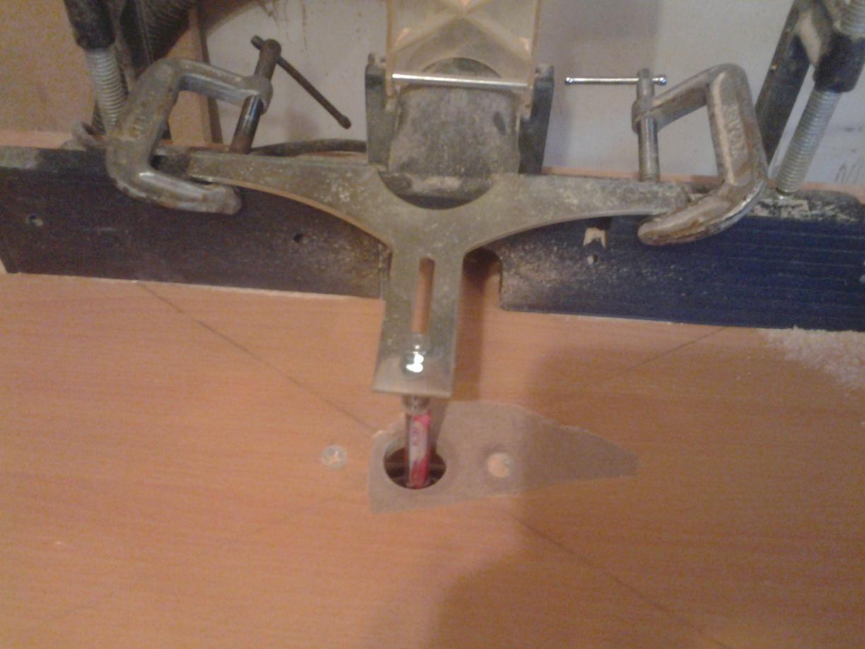

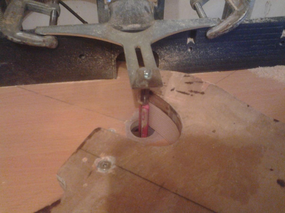

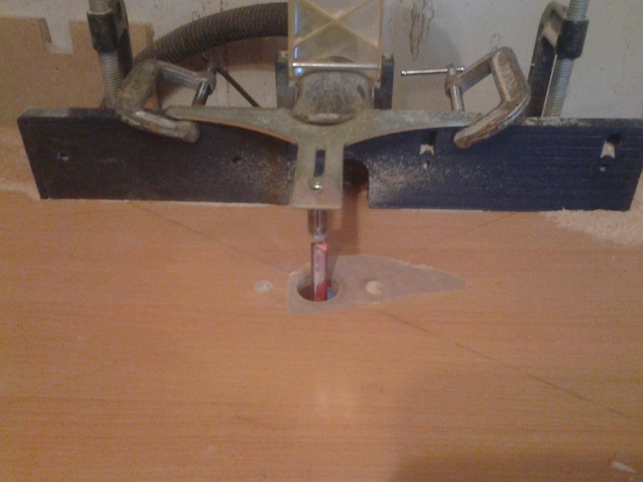

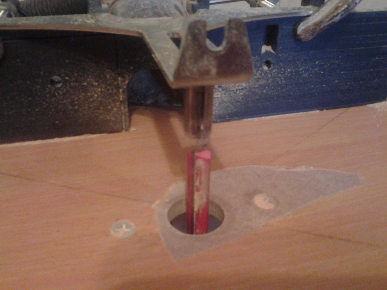

Over bit shaper pin fo router table
Attachment 1955 Attachment 1959 Attachment 1960Attachment 1961
this is something I came up with it is a over the bit shaper pin. I used an old router table fence and a router edge guide a bolt with a long metal spacer. I do a lot of template shaping and was burning up a lot of guide bearings, i can do much shallower passes so the router bit lasts much longer as well. it works well and is much safer than a pin router. since this one worked so well I plan to make one that is much better
