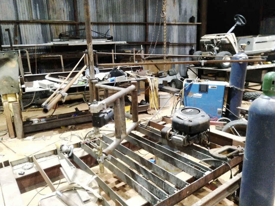

    Pantograph torch pattern support arms
    The pattern mounting arms are 65 inches long and I mounted 2 of them so I can hang large or long tracing patterns from them
    Both have a movable pattern mount so I can locate my patterns anywhere over a full 4by 8ft sheet of steel
