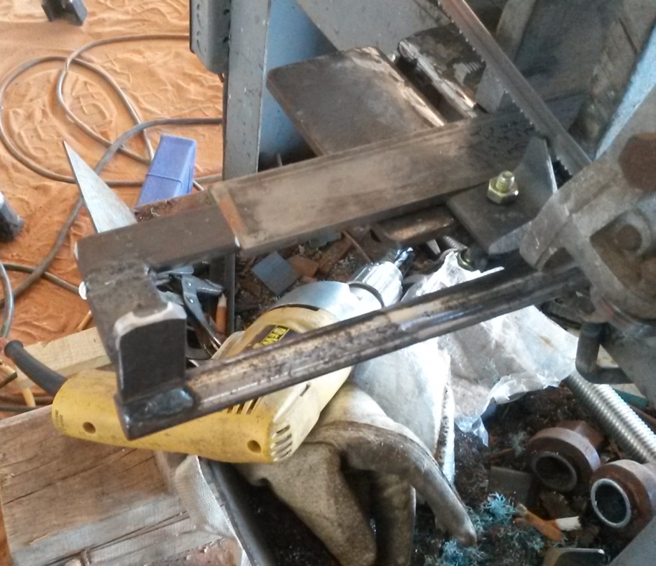

Almost every bandsaw has a rod or something to preset the length of what ever you are cutting when cutting short parts in multiples
mine did not.
so I drilled a pair of 3/4" holes through the frame and made a rod with a stop end on it
Attachment 39197
