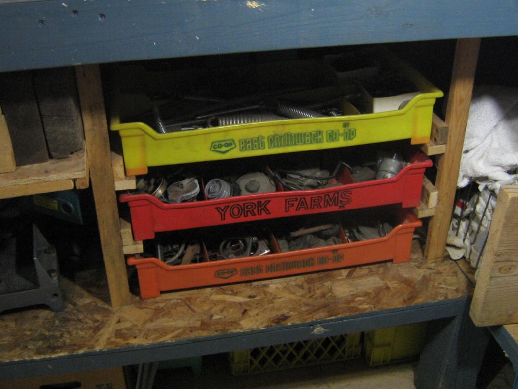

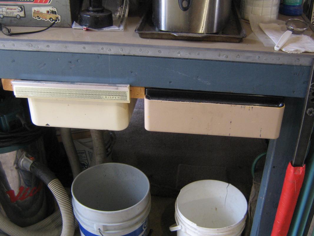

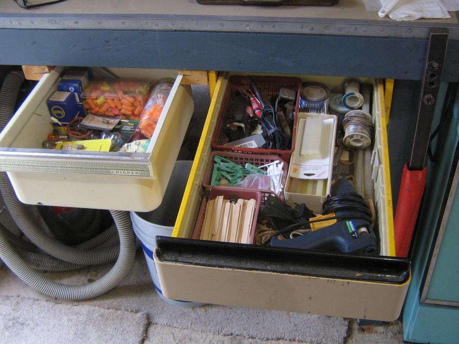

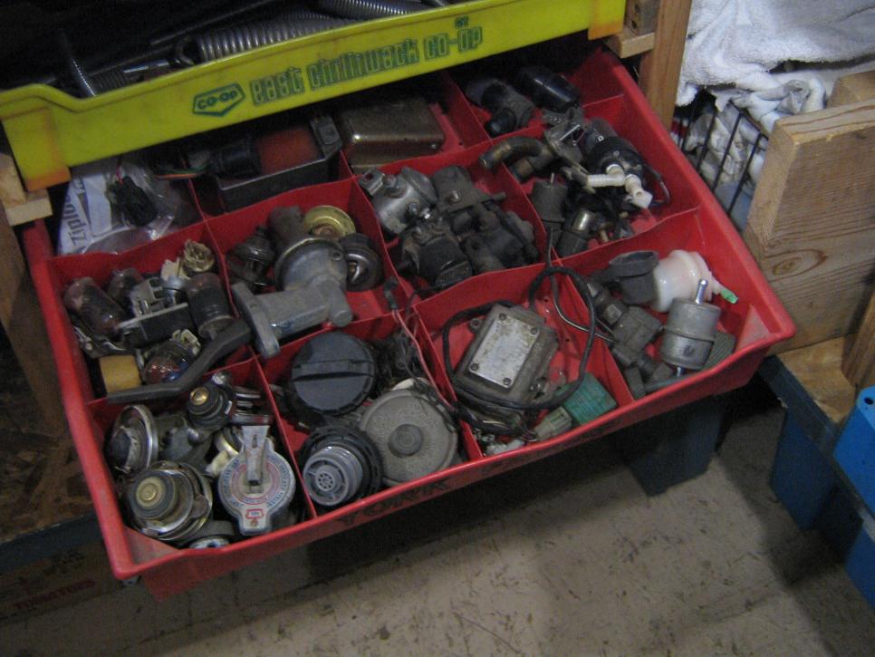

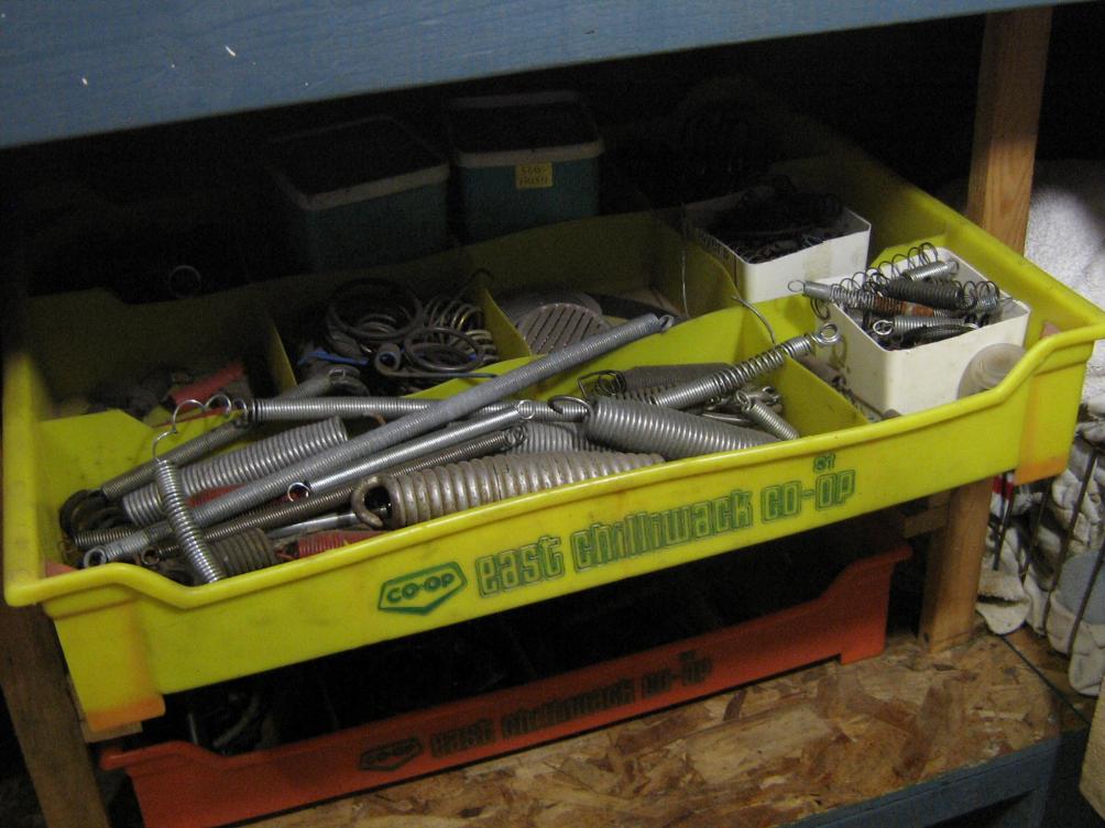

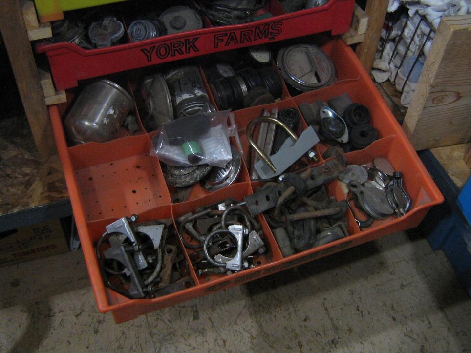

    I framed support rails under my bench to hold three large plastic trays , they measure 4" x 23" x 18" and probably came from the produce section of a grocery store. a steel crisper drawer from an old fridge provides more storage under the bench, it slides in slots cut into a few lengths of 2" x 3" screwed to the bench, the other drawer came in it's own frame and was simply screwed to the underside of the bench.
